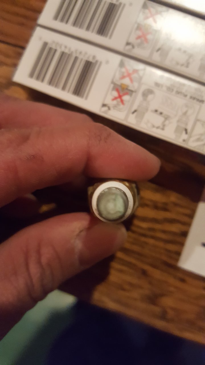

    Yes it does start immediately after stopping warm engine. Was cleaning injectors with several bottles of injection cleaner and 91 octane fuel. Thinking now, this is where problem started. Ran tank nearly empty and filled with regular fuel. So far, one test, it started fine. Changed fuel injection relay under hood in fuse box, was going to change circuit open relay in dash, but have to order, none in stock here. Fuel pump, 30000 ago, Filter recenty. Injector post sounds interesting. When I get home late tonight I will post pics of spark plugs changed a few days ago. One had a bluish white powder on it when removed, three on driver side looked brown where white part meets metal. Thx.

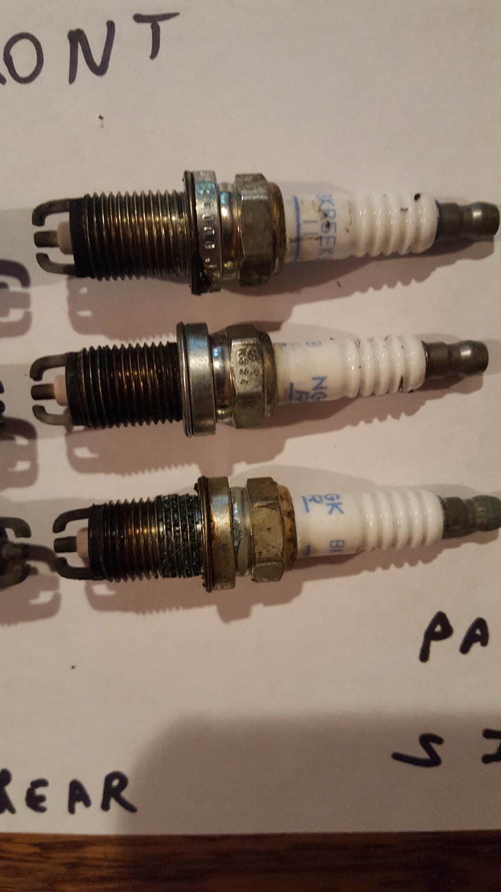

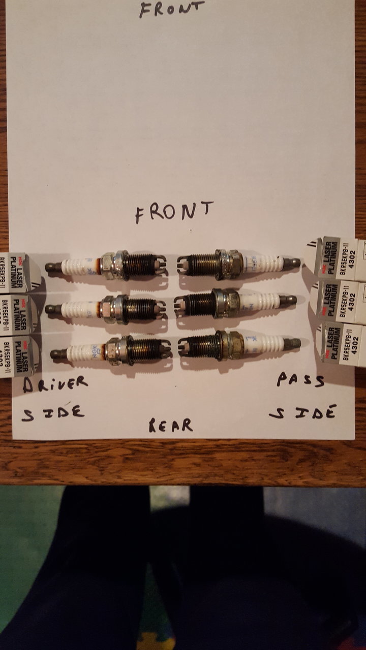

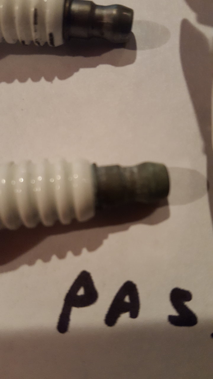

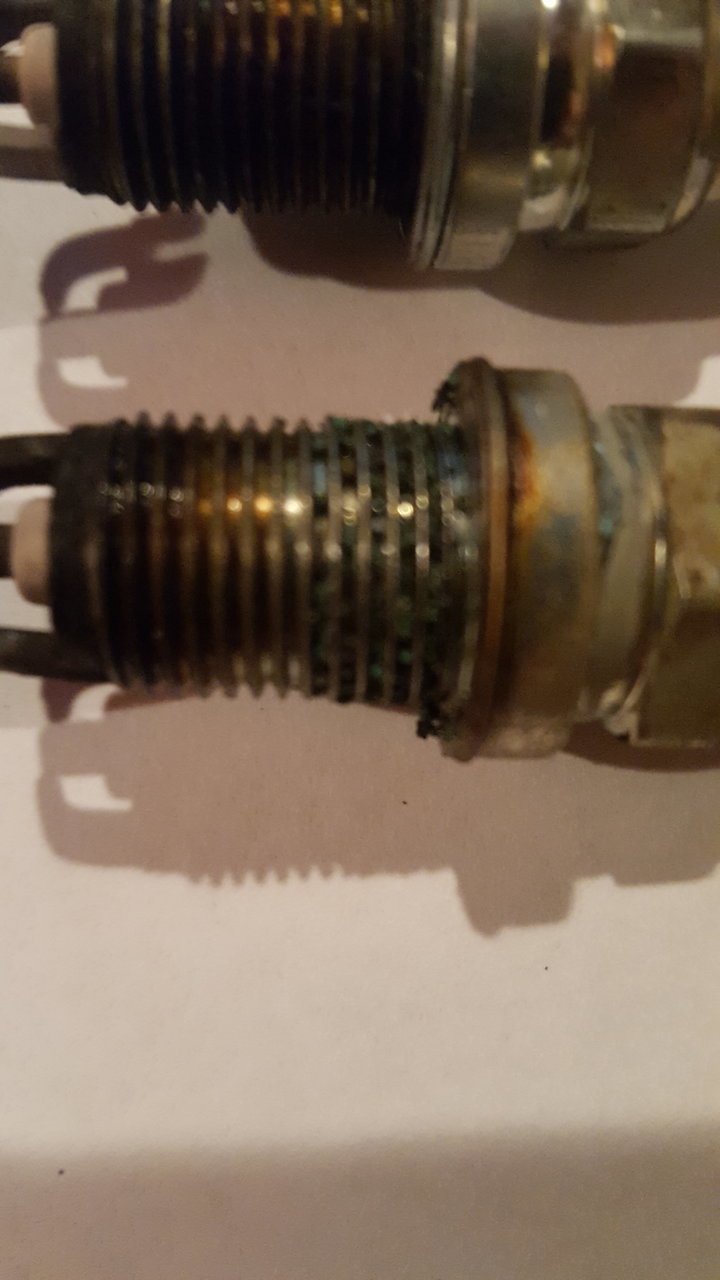

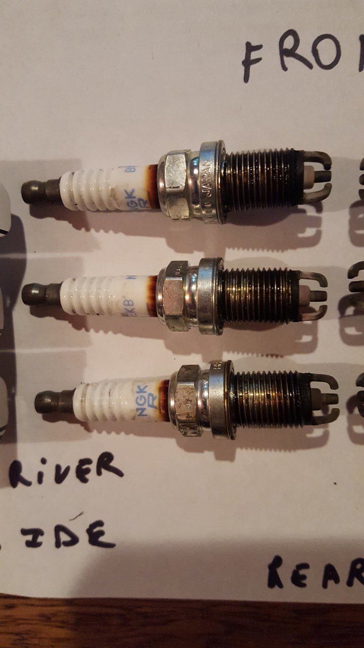

    20180102_004329.jpg 20180102_004428.jpg 20180102_004447.jpg 20180102_004401.jpg 20180102_004332.jpg 20180102_004322.jpg 20180102_004329.jpg 20180102_004428.jpg 20180102_004447.jpg 20180102_004401.jpg 20180102_004332.jpg The following are pics of spark plugs removed. Maybe the condition can tell what may be going on with start issues.??? I do not know if the bluish white shows on the one plug emphasized. Plugs about 30,000 miles on them. 20180102_004329.jpg 20180102_004428.jpg 20180102_004447.jpg 20180102_004401.jpg 20180102_004332.jpg 20180102_004322.jpg

    Starting issue still here, although will start after 3 attempts. Still not right. Starting to believe it may be with injectors. I do not know, but maybe the old spark plugs may give some kind of insight to issue.
