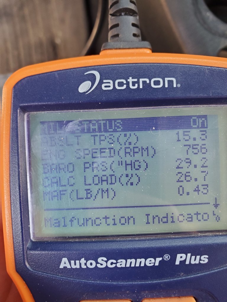

    OBD data shows MAF at .43lb/min (which is a little low). It's got new plugs and coils. Does that mean I need a new maf? Have cleaned it a couple times, nothin' doin'. It has a code for cylinder 2 misfire. Anyone live in Central Indiana and able to meet to trade me an MAF for ten minutes to try to rule that sensor out. What else can I rule out with OBD and or multimeter, before I go buying anything?

    Lb/min, sorry

    Depending on engine speed that's pretty close for idle (rule of thumb is 1 g/s per liter of engine displacement at hot idle)
    0.43 lb/min = 3.25 g/s
    Is it a particular cylinder that is misfiring?
