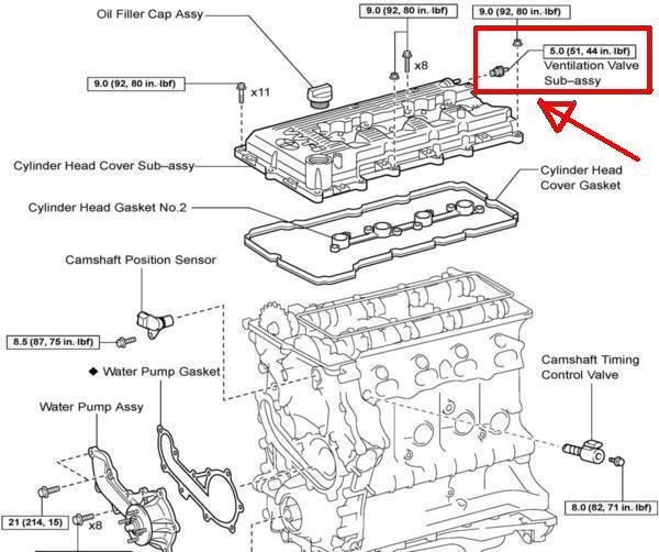

    Tell them that they are full of shit. The PCV valve is replaceable on the 2.7L 4 cylinder engine without replacing the valve cover gasket. In the drawing below it is called the ventilation valve sub-assembly. It screws into the valve cover in the back rear passenger corner.

    Now I'm really irritated.......Why on earth would they tell me that? Your picture plainly shows the part with the threads.........I'll buy it myself and get a friend to put it in. I replaced the old ones that pop in and out.

    Hell when I read your post it irritated the crap out of me. I have no idea why they would tell a lie like that. I guess they are too lazy to look. It only takes a few minutes to replace, Hose off unscrew it, screw in the new one and reinstall hose.

    Okay, the tech looked at the pic and said yes this is a diagram of the 2.7l but it's not the 2.7l I have in my 2008. Unfortunately with me being in a wheelchair I can't get up and look at the motor to see, so will have to get someone else to look. The tech still says my PCV valve is internal and I questioned again about the hoses coming from the PCV system being dry and he once again confirmed they are clean and dry.
    So know I feel like popping a beer and buying a horse, they seem to only be feed and I know for a fact they don't have a PCV valve, just a release valve!

    PCV valve is easily removed with the valve cover on. I have done it several times.

    #180463
