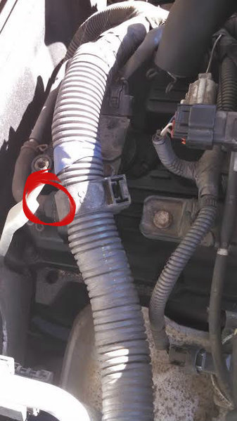

  14. Mar 9, 2016 at 12:39 PM
    #54
    TheWolfePit
    TheWolfePit [OP] Active Member
    Mar 7, 2016
    #180463
    33
    Larry
    2008 Toyota Tacoma DC 2.7 2WD
    Is this the PCV valve?
  15. Mar 9, 2016 at 5:24 PM
    #55
    Jimmyh
    Jimmyh Well-Known Member
    May 16, 2012
    #78991
    14,279
    SC
    2012 Prerunner SR5
    Yes that is it.
