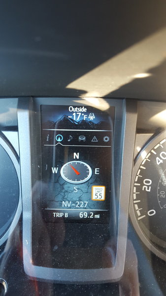

    Just some observations on cold weather performance. I park outside at night so some of these issues may not be noticeable if you are in a garage at night and only driving in these temps.
    1. At start up I get a strange brief grinding sound. I believe it is a pully bearing or starter motor. Another member in my town has this same grinding sound at extreme cold weather starts.
    2. Clutch sticks to the floor and is super sluggish. After about 20 minutes of driving it wakes up a bit.
    3. Syncros in the transmission do not like to line up. I have troubles getting into 1st gear and have to drop into second a couple of times before I can get it into 1st.
    4. Transmission is stiff until the truck drives for 20 minutes or so.
    5. Windshield wipers move at a snails pace. Even on the highest setting they move slow.
    6. Breaks do not grab well and the break pedal is lethargic.
    I have owned 3 other Toyotas in this same climate. None have had these nuiances at these temps. The 2016 is a warm weather queen. Damn.
