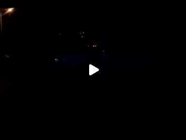

    running through the strobe settings with the wireless remote
    no video of the music pulse setting, but it's pretty entertaining.

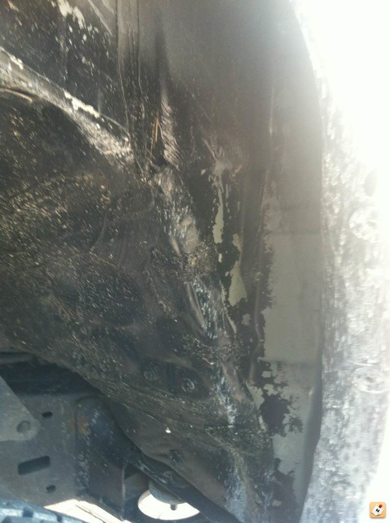

    did you cut your pinch weld at all? one of the florida guys just found that his cut pinch was leaking and filling up his passenger floor board when it rained.

    Pic of the sealed pinch weld. They made it look nice aside from all the dirt and also put the stuff on the inside. tazedu8a_92105840108275180ca333a287a3c4336084df24.jpg
    Aside from that, so are you set on the TC +3.5 kit?
