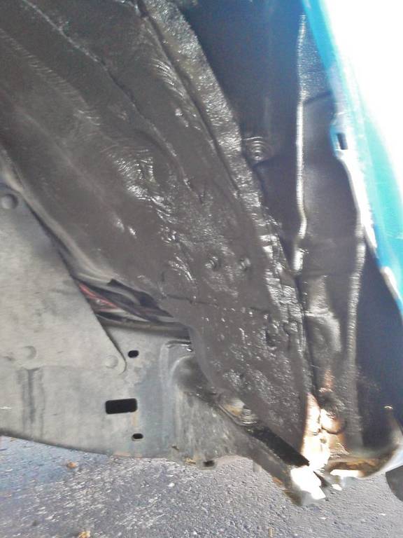

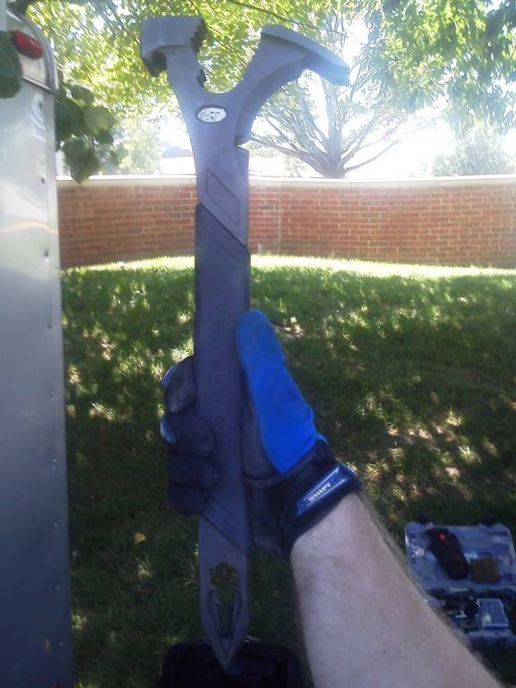

    new favorite tool. the Dead On "Annihilator". I've had it for a few months, but until today only used if for hammering in tent stakes and small stuff. got to really see what it could do today. didn't have to make a single cut in the pinch. the hammer just took care of it on its own. got both pinch welds taken care of, as well as concaving the innner fender well a little more.
    rubber undercoated it after, and then bedlined over the rubber coating.

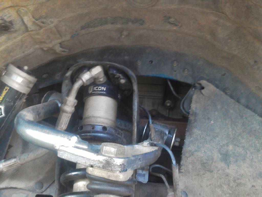

    in other news, you're not really stuffing until your upper control arm starts blowing out your inner fender well

    Annihilator is only about $30 at Home Depot, or Amazon. Dead On makes a miniature one for you Jersey guys :D
    8.5'' of glory http://www.homedepot.com/p/Dead-On-Tools-Exhumer-3-in-1-Multi-tool-EX8/202268976#.UiVVfDZJ6Ak

    Tell me about it... haha And that is with a 1" body lift. I'm going to need a grinder to remove my compressor should I ever need to.

    i had a bolt just like that on the other side. it was one of the bolts holding down the filter box on my homebrew intake. had to dremel the end off to remove it for the Volant install

    That is my passenger side. haha When your tire has the room, those UCA's will really stuff up in there!

    yeah, i don't have any rub on the upper or forward part of the well from the tire, but i'm expecting to have to hammer it come wednesday.

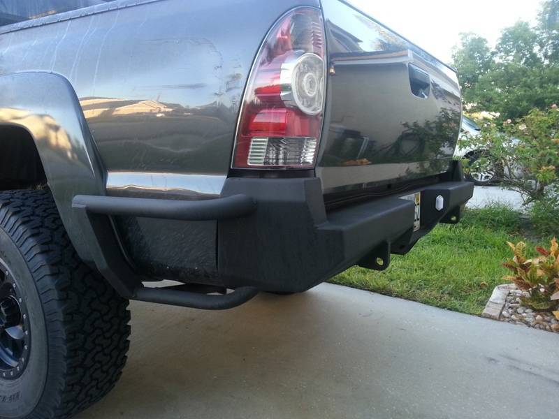

    Just a heads up, Ryan picked up a real nice CBI rear bumper just a month or so ago. I have his factory rear sitting in my bay at the shop waiting to go on my truck. Since its herculined I figured it would go well with the black bruteforce.

    Ah damn :facepalm: I knew it was the cbi. I've got pictures and emails about it, since we're integrating his bed rack into it.

    And ftr, the CBI is great, highly recommended.

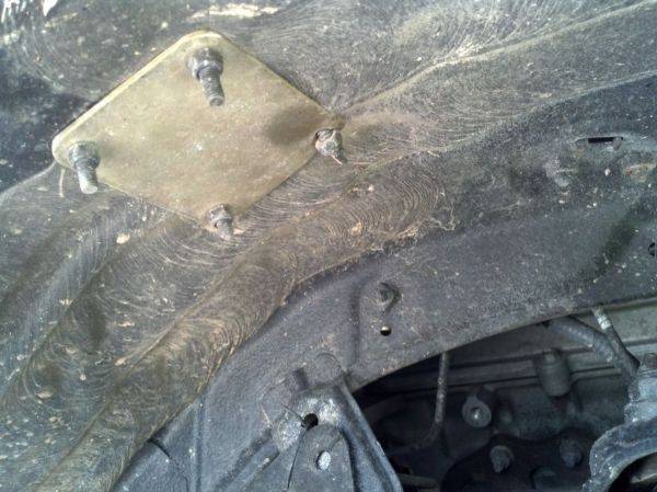

    My 33's rub the shit out of my wheel wells. I did the pinch weld and beat it back some so that's good but the top is pretty much getting beat back by the tires. My 33's are skinny enough to not touch the flairs so I haven't had to mess with them yet, other than some hacking at the back and bottom to prevent rubbing while turning.
