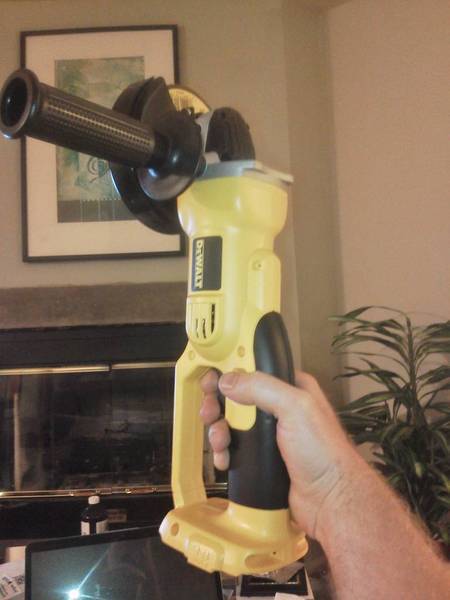

    got both cab mounts looking like this last night. still a little rubbing, but better. i would have done more, but it was pissing me off how long it was taking with the dremel. took a good half hour per side with the dremel, which would have been maybe 5 minutes with a grinder.
    someone slap me next time i think it's a good idea to toss all of my tools in a storage unit halfway across the country :mad::(
    Guess i'll be going out to buy another grinder tonight or tomorrow, so i can actually make some progress on the cab mounts this weekend.

    i will. just not until i get a grinder. dremel is awesome, but sucks for 1/8'' plate.
