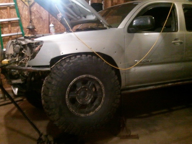

    I think his reply was more to the fact most of its already gone and you are cutting more! :rofl:

    #bigtireproblems :eek:
    i won'd be happy untill i can make the top of the tread dissappear again (without ripping an entire fender off) :)

    I understand those problems! Im running Treadwrights and they are 315... lol

    yeah, and the TWs run big too. luckily that spindle lift you have keeps you off the cab mount and inner fenders pretty well. that extra width cause any issues for you?

    Im rubbing on the drivers side cab mount and out to the fiberglass in reverse with wheels cut left and in drive same direction...
    Rims are 4.3 BS and spindles are 3/4" wider... Thought about spidertrax but would only make it worse I think...

    ah, i thought the spindles added more width than that.
    wheel back spacing/track width seems to be the least exact part of fitting bigger tires. short of 2'' over or greater LT, you're gonna rub somewhere no matter what. just have to decide how easy the different rub areas are to remedy, and figure out what width will have it rubbing there.
