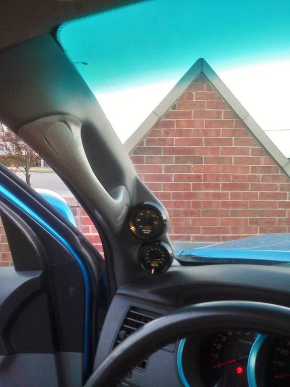

    dremel, gauge mount, running the wires down tho the floorboard, and bolting everything up took about 15 minutes. my biggest gripe with it is that that gauge holes were a little too snug couldn't even push the lower gauge in all of the way. had to wollow out the hole with a sanding wheel.

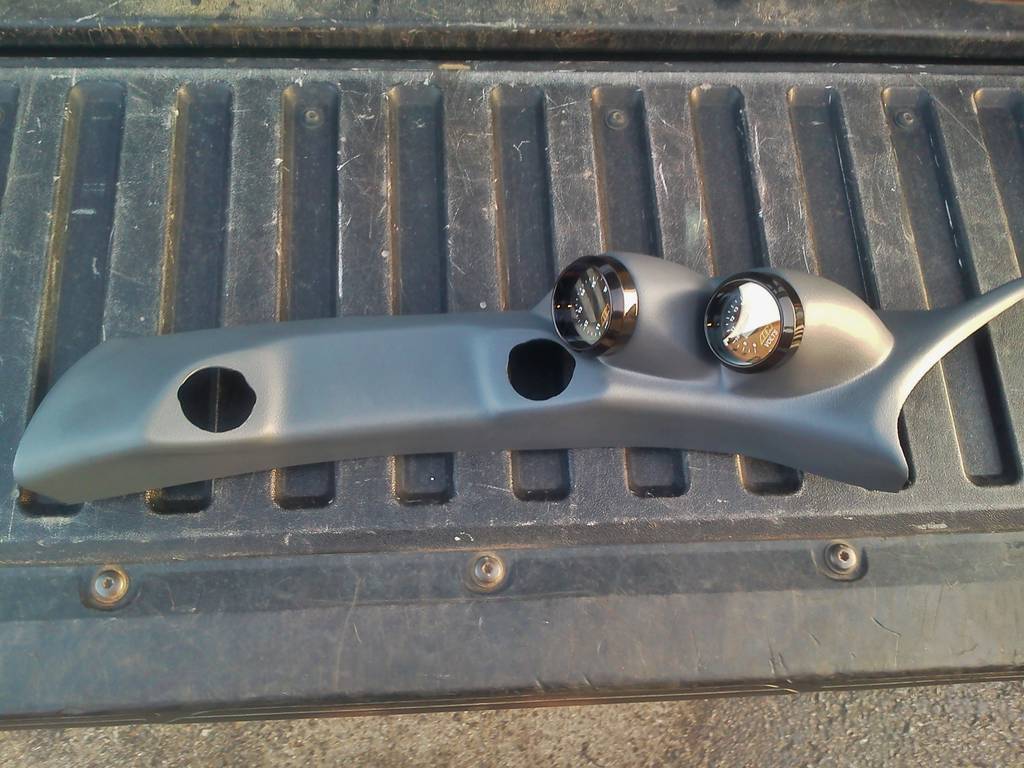

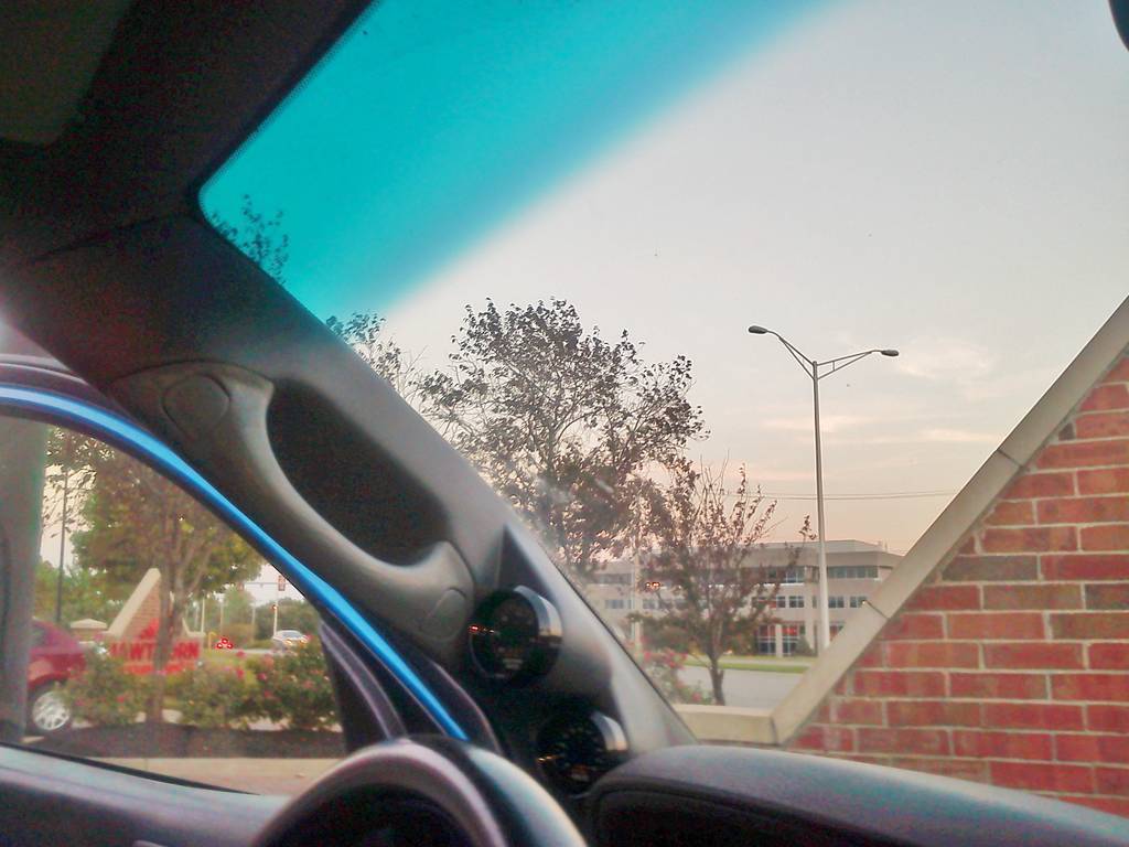

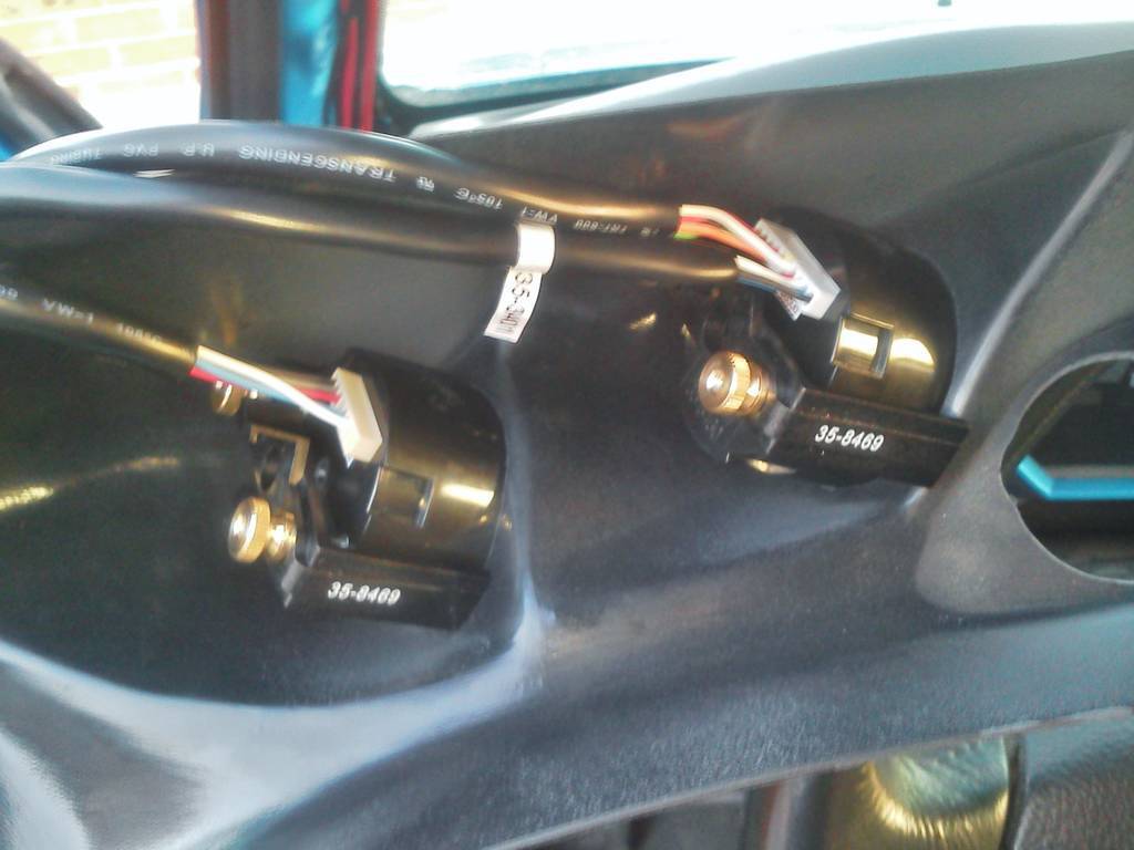

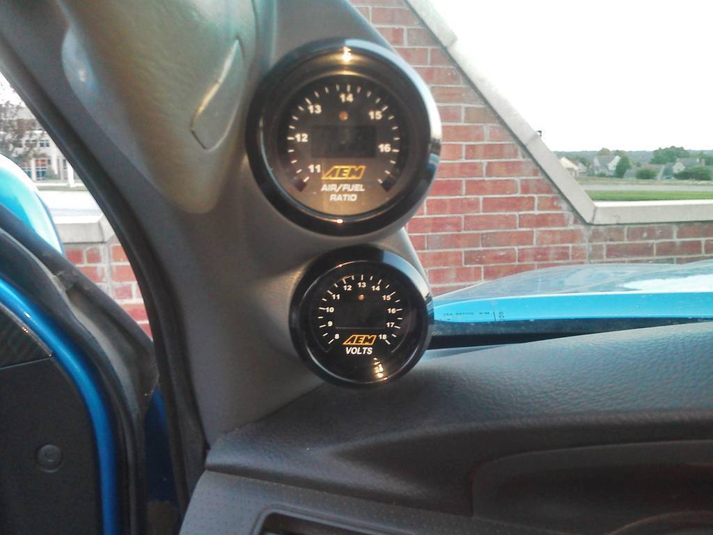

    all trimmed and fit with the gauges. you can see the notches i had to make in the handle holes as part of making it fit properly

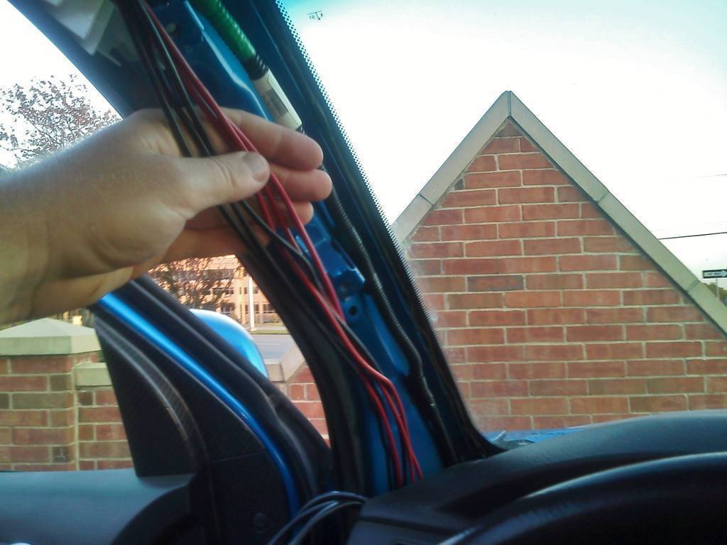

    already lots of wires in the a-pillar :eek: 2 power and 2 ground for the 6 roof lights, and the 3rd power and ground are lift over from my old roof rack when i had rear facing lights on the roof. i left the wires so i didn't have to rerun them if i ever needed more power up on the roof for any reason.

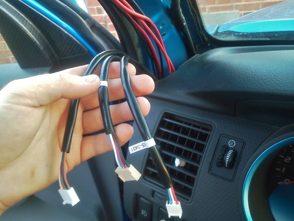

    2 power harnesses, and the signal harness.
    now just have to get everything wired up on the other end.......
