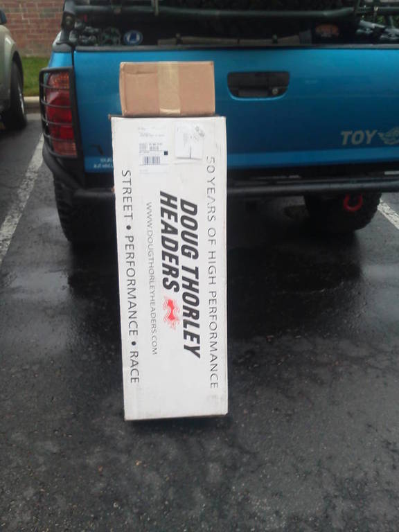

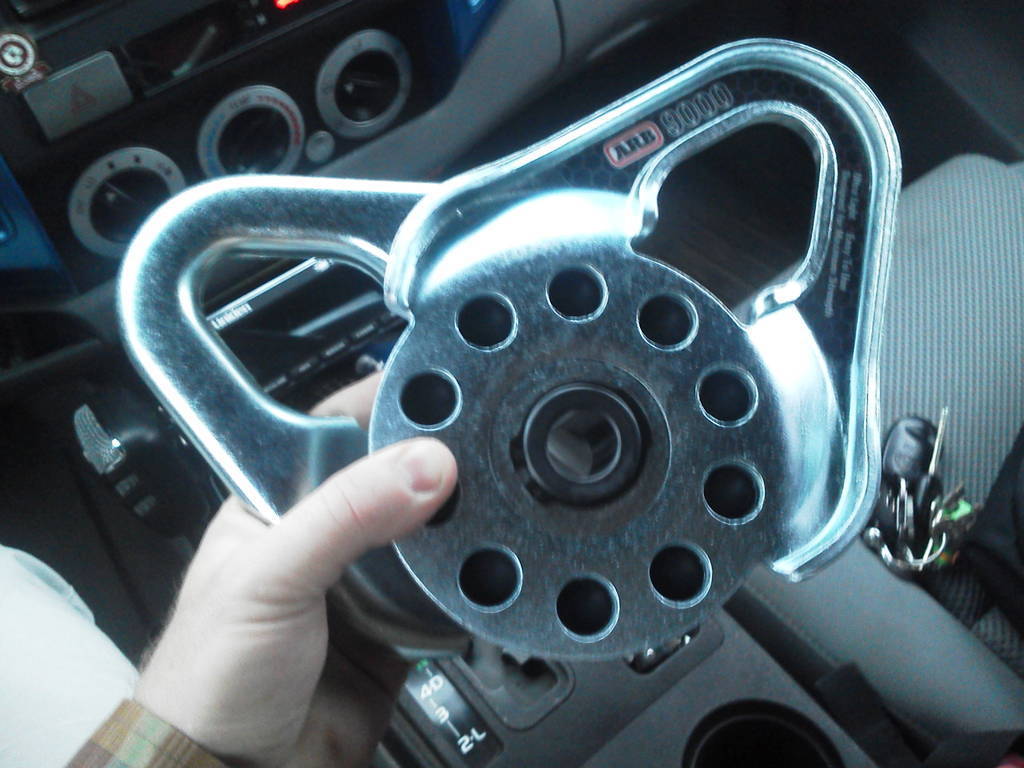

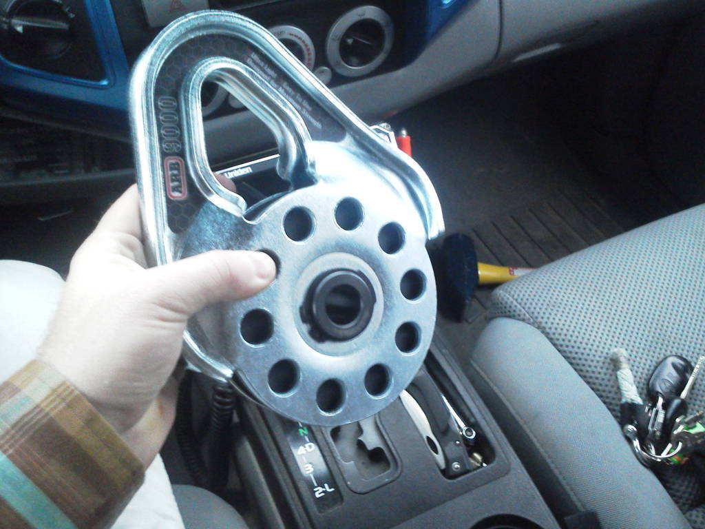

    Some goodies came in the mail while i was away for the weekend :
    new y-pipe from DT (going to be so happy when my truck doesn't sound like a weedeater anymore), and an ARB 9000 block from the group buy that Linwood was kind enough to set up
    Gotta say, the snatch block is more than i expected. absulitely huge. it'll make a nice compliment to my smitty block for those retarded situations can't seem to avoid.

    Should fix all of my leaks, and fingers cross, but it does appear that it will fit around my skids without any modification :)

    sumbitch lol. yeah, DT pipebomb. i did all of the research i could about it and the clearance, but i think you started popping into this thread a few weeks after i ordered it. general concensus is that it hits relentless/ato style transfer case skids, but may clear the all-pro. i modified my all pro for better clearance, but not in the area of concerned.

    there are a couple guys running the PB with a fully plate style transfercase skid, they just had to shave the skid down a little, or get the PB altered.

    So is clearance part of the reason for choosing the DT over the URD? I vaguely remember this conversation when you were deciding but forgot. haha Take some pics of it installed I want to see the skid clearance since my skid is still a one-off custom.

    yep, clearance was the issue with the urd. It goes under the transmission pan, instead of out and around the transfer case. so no only are you heating your transmission up, but it hangs very low, to the point that i wouldn't be surprised if it hit a standard style transmission skid. I have the all pro tranny skid, which is a much higher clearance skid, to the point that i literally don't have any scratches on it, so i could have run the URD, but it would be destroyed after the first wheeling trip.

    Maybe Tor or Colton will hop in here and correct me if i'm wrong, but to my knowledge, the 2wd one crosses over in the space that the transfer case occupys on the 4x4s. so with the transfer case in the way, they took the 4x4 pipe under the tranny to keep from having to make that 180 degree bend that the pipe bomb has.
    routing it under the transmission is still better clearance than the factory one going inder the transfer case, but both are still pretty bad as far as ground clearance and skid interferance go.
