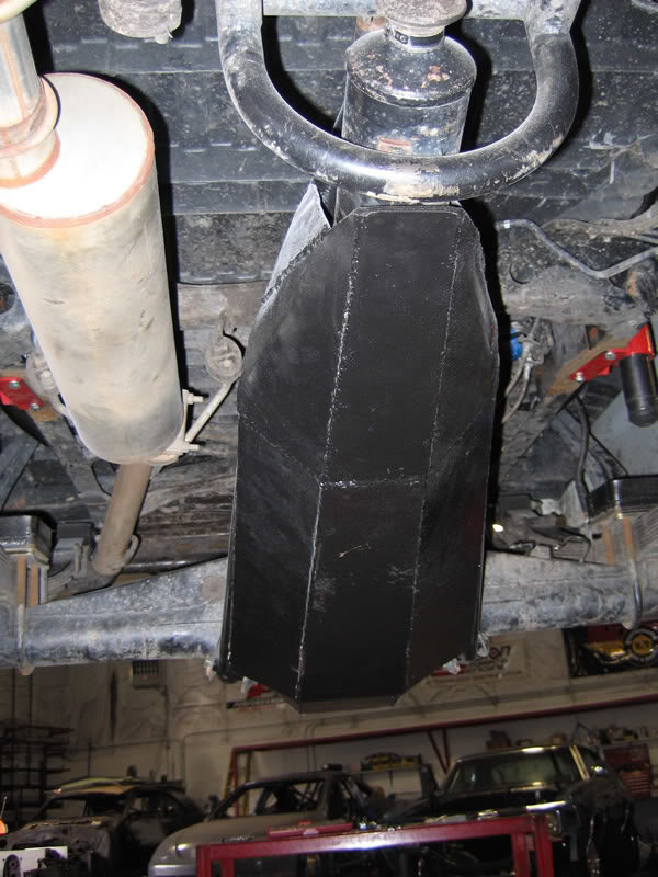

    only to protect the strongest part of the diff :laugh: gotta hand it to all pro on this one. they seem to have the most sensible production diff skid out there.
    i have some small 1/8'' lca skids that a former member on here tossed together for me and just about gave me. after denting one of my lower arms, i figured why not.

    a half hour with a grinder and welder, and you could have an all pro style skid made from scratch.
    however.....
    there really isn't a need for one. the front and bottom of the stock 3rd/axle housing is pretty darn strong. the rear is the only place that is "fragile", short of some irresponsible reversing, even the rear is hard to dent too bad.

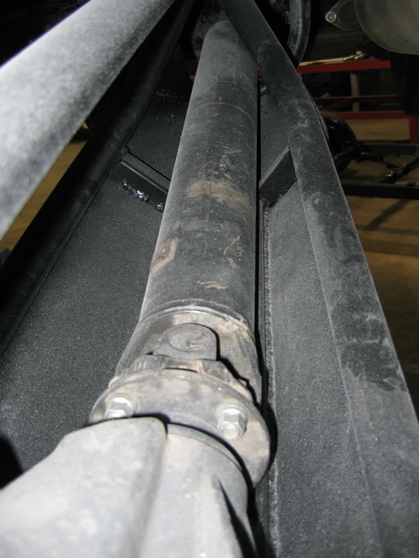

    Brady, the best way to protect the driveshaft is to 1) don't use a one piece and 2) run a traction bar that sits close the the driveshaft and is made out of heavy enough material to act as a rock slider of sorts for the DS. i believe MJP2 and jandrews have/are running similar setups.

    you use a combination of bushings and johnny joints on the traction bar, so articulation isn't an issue. Wyatt also ran a traction bar now that i think about it, up until he 3-linked the rear. he had issues with ripping the welds that held it the the axle, but there was a lot more force in his scenarios....

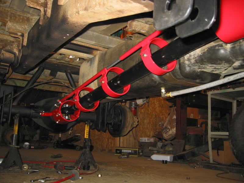

    that's meant to catch pieces of the drive shaft when it breaks, and keep them from taking out other parts of the truck, as well as keeping people in the area, and the drive safe. won't do much to protect the driveshaft.

    here's mikes driveshaft skid
