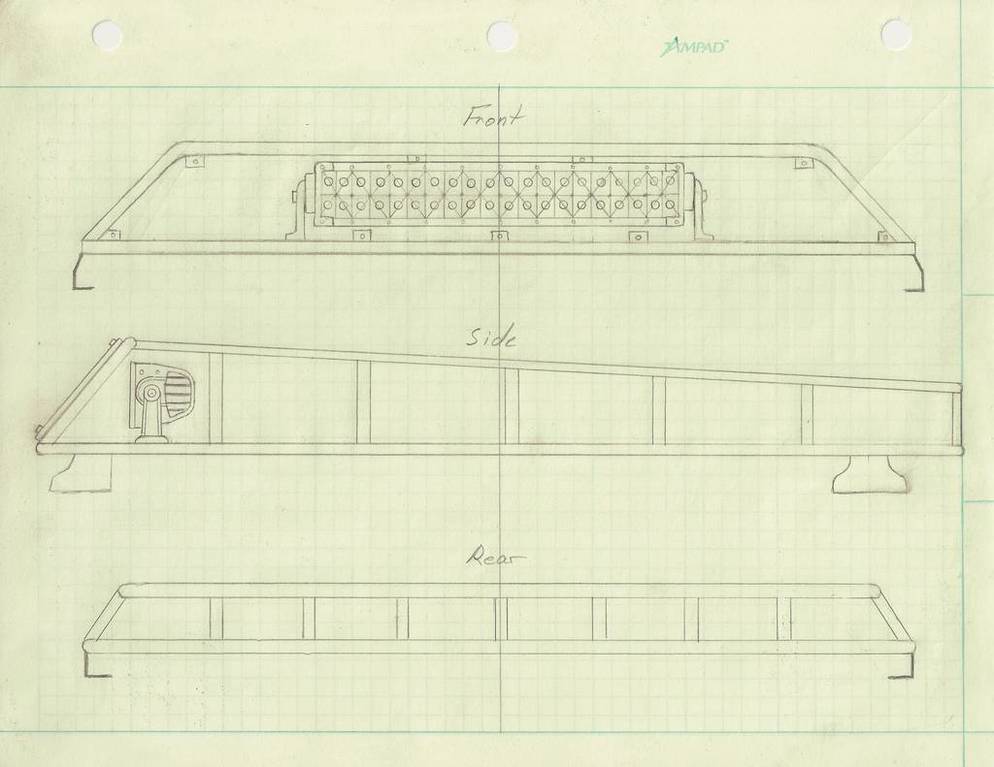

    i bolted it down to the factory holes, and drilled another hole for all of the wires.
    i make them about 45'' wide up front. if you follow the roof rails, you'll notice that they actually get a little narrower, so i usually taper is a small amount as it gets to the rear.
    I'm actually wirking with a member on here on a roof rack that i will probably start building in within a week. he's putting a 20'' rigid industries LED bar on it. i believe it will change a little, but here's the sketch of what it will look like as of now. per his request, i'll be cutting a clear acrylic sheet to cover the front to cut down on wind noise and keep bugs/rocks/branches etc away from the rigid bar.
    I may play with the length a little, but the drawing is to scale.

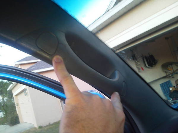

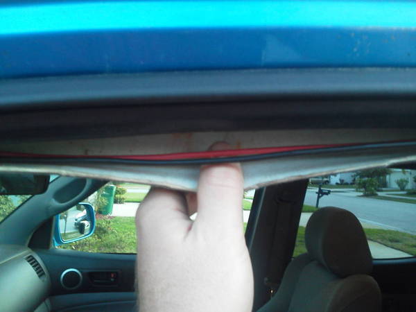

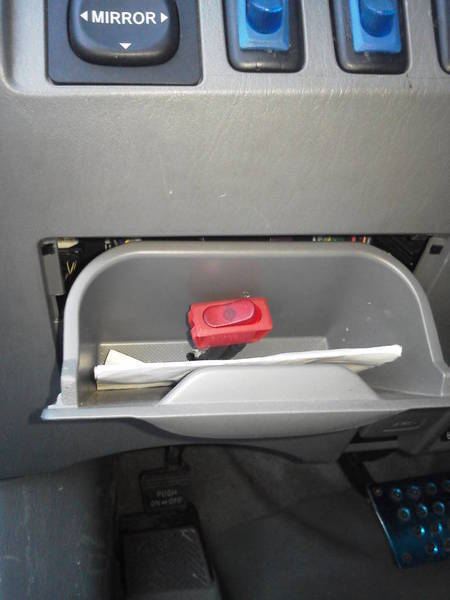

    here ya go coby.
    after you get thr wires through the roof skin, you can pull down the edge of the celing. it's just tucked into the rubber by the door seal.
    then you pop off the covers to two bolts on the oh shit handle. take the bolts out and the intire a-pillar should pop out with a little tug
    after you run the wires down the a-pillar and reassemble, pop out your little change holder and you can grab the wires through there and under the dash by the pedals. you via those two points, you should be able to get the needed wires throught the firewall and to your switches
    as for the LED bars, Rigid is unmatched in durability (youtube "rigid industries torture test"), but for the price of the one you linked to, it's worth a shot for pretty much half price of a RI bar.
