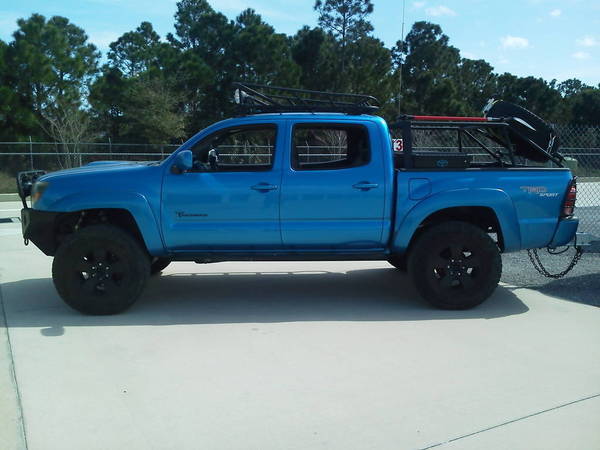

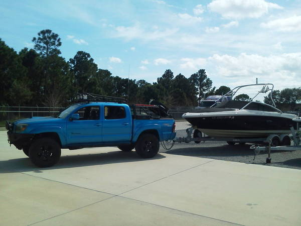

    boat's all set to hit the water!!!! nice and warm 'round these parts
    truck sit's nice and level with the boat hooked up.......but i'm still tearing the rer suspension appart and redoing it this summer :cool:

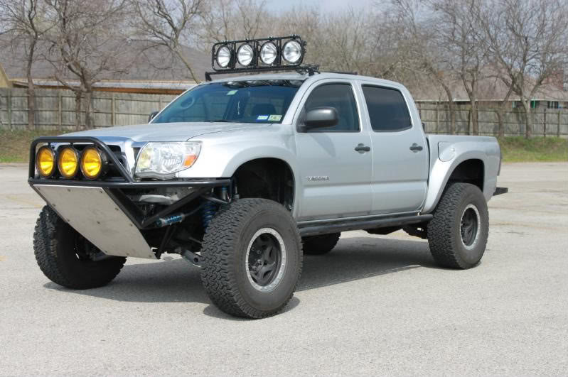

    how hard do you think it would be to fab up a straight bar like this but for an LED light bar? and do you think there would be too much glare off of the windsheild if it was a little more low profile to the roof itself?
  14. Mar 14, 2012 at 1:34 PM
    #294
    colinb17
    colinb17 [OP] If at first you don't succeed, don't try skydiving
    Jan 6, 2008
    #4127
    20,174
    Colin
    Charleston, SC
    '07 TRD Sport 4x4
    Build thread in sig... 4-link long travel
    the bar itself would be pretty easy to make, and using the stock mounting points, it's about as far back as my lights sit, and i don't get bad glare. mounting it lower would only help since the angle with the windshield is less. most likely though, he is running an electric actuator to a point further back on the roof for both bracing purposes and to adjust the light angle on the fly. if you were going to use a solid version (no actuator), you'd probably want it brace to somehting further back since that's a lot of torque to put on the bolts to the roof.
