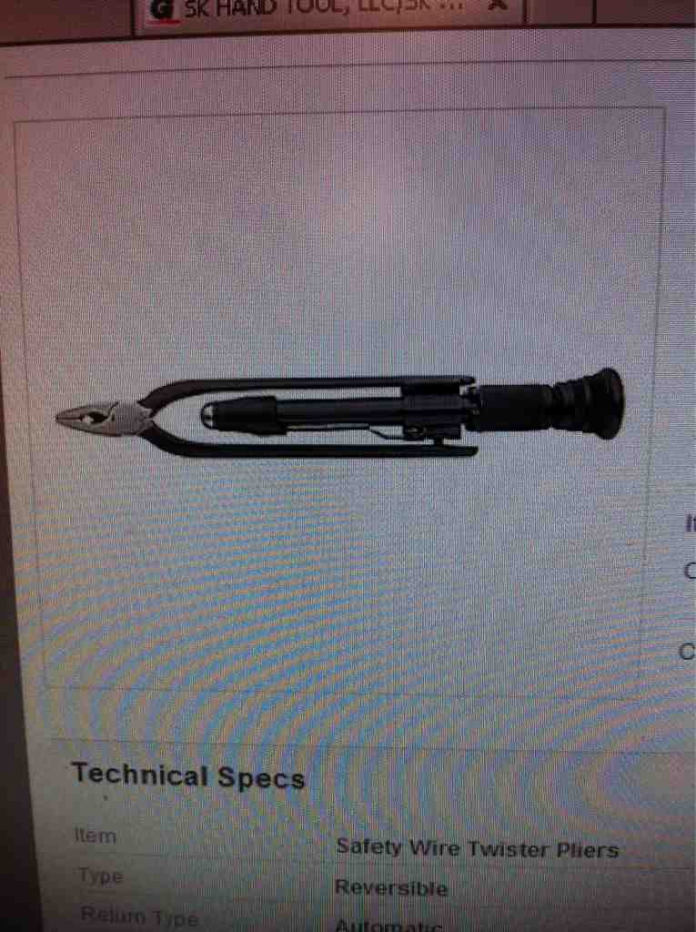

    i forget who made it, but we had a nice tool that spun the wires together real quick and neatly. made it a little less painful.

    Glad to hear she's still running strong. That little fridge has to be coming up on 7 years old now. I think that's pretty good as it goes for mini fridges.
    My buddy that used to be an airplane tech had that tool. Just like this one. Works like a charm.

    and that's definitely the tool. ours looked a little different, which means it was probably a different brand. it pains me when i see people twisting wire by hand :facepalm:

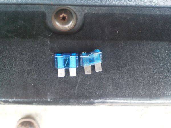

    Where's the picture of that fuse?

    good call, completely forgot about that. uploading now.

    so thanks to Mark's keen eye, a potential fire risk was found under the hood. we've speculated, but are still not sure as to how enough current went through the fuse to heat it up and melt it, but not pop it :eek: it;s a fuse to on of my light relays. lights still turned on with the fuse, but something has obviously gon wrong. had it wired like this (same relay setup) for years now and never run into this issue. going to check all of my gonnevtions for proper contact, and if i don't find anything wrong, i'll may up a wire size. however, i don't want to jump into anything too quickly, as it could very well be just a faulty fuse.
    it compared to a brand new 15A

    Damn man! Was the fuse holder fine or is it warped now too?

    little distortion of the plastic for that slot, but it was very localized to that indevidual fuse. the new fuse went in just as easy as any other slot though. so functionally, it should be jsut fine, once i track town the cause. blue sea uses some nice plastic. the kind of heat it takes to melt a fuse like that could have easily toasted a good part of a fuse box of lesser quality (like my old one)

    That makes me think most of the heat was probably in the fuse itself so I'd guess faulty fuse but as you said Blue Seas uses nicer plastic so I guess it's still possible that it could be something else but your wires might have damage to the insulation as well if it wasn't just the fuse.
    Did you flip them on with the new fuse in yet?

    flipped them on just to test, but didn't leave them on for any kind of long duration.

    I would have. Haha you've been using it with the "bad fuse" this whole time now anyway. That would be the fastest way to rule in or out a bad fuse. Just test the temp with your finger every so often and shut it off if it starts to get hot.

    it's not so much that the fuse is getting hot, but why is it getting hot. odds are, if it was a bad fuse, that's not what made it hot, that's just what kept if from popping. something esle is likely the cause, whether if be a bad connection somewhere, undergauged wire, or something else.
