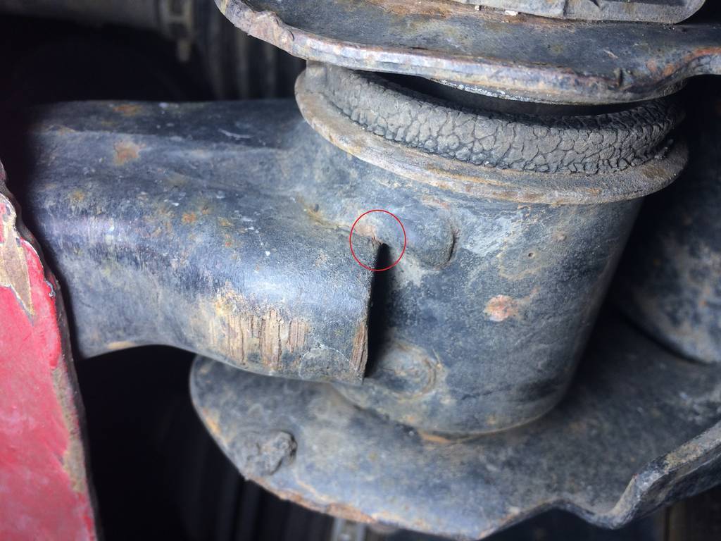

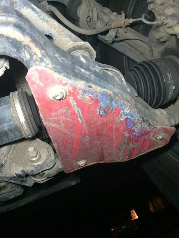

    From the always entertaining house of Tor last night, we did a real quick 3 qt drain and fill on the transmission. the fluid that cam out, while not pristine, looked better than i thought it would, after all of the wheeling and towing over the last 75k miles.
    Brady, I got some pictures of the cracked LCA welds. it's still very small, which is a good thing, but it mayb e hard to see in the pictures. the cracks in each arm are in the center of each red circle.
    the two or so people who i've seen who have torn stock lowers appart, have looked at the other side that was still intact, and saw almost identical cracks to what i just posted, so go inspect your arms everyone. the crack is easily confused as just a small rust spot, but if you look closely, you may find worse. get it repaired before you're stuck on the trail or side of the highway (and potentially seriously injured).
    on a lighter note, i got a chuckle when i crawled under the truck and had blue paint on all of my skids from the car crush a couple of weeks ago.

    Skids themed after a certain super hero? o_O
    In all honesty, I would likely have just noticed those spots as rust spots, until it was too late.

    Good call Colin.:cool:
    I'm working on rebuilding a set of LCA's now. I've seen a few pics of folks that have run a piece of steel around the outside of the bushing collars - I'm going to have mine reinforced before I install the new bushings for that piece of mind.

    and I would have thought the same thing about them just being rust spots, had I not seen the other people's mishaps before me. +1 for the interwez :woot:
    yeah, I've seen that too. great idea, and makes them very strong. I'd just need a second set of arms to do that, just like what you're doing, because if I'm doing a bushing out reinforcement, there are also some other parts of the arm that I'd like to beef up as well. i'll probably just bandaid fix these though, by slapping a new bead on there tonight, and then hope that I have LT arms on there before they disintegrate.
