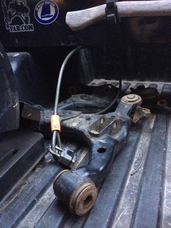

    just some reinforcing of the known weak points. mostly the bushing sleeves. going to wrap those with 1/8'', and gussett where the arm meets the bushing sleeve. maybe a welded 1/8'' skid. the bolt on skids i have now are great, but i don't like how the arms are full of dirt now, with no drainage. probable seal them up completely. then it's new bushings and ball joints.

    Yesterday's project: Fender guards for SMKYTXN.
    ARB claps to the headlight hoop, Ruff Stuff clamps down at the slider, and 5 bends per side. turned out stronger extremely strong.

    Swiggity swangin' biggity bangin'
    What's that sticker on the vise for?

    Shortly followed by the distinct sound of "something" running into a hitch, or in this case a vise. "Thunk"

    look, i even chipped the paint :rolleyes:
