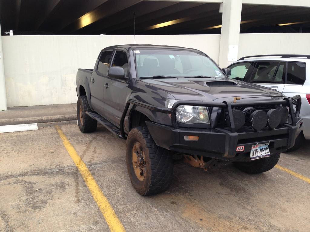

    Does he plan on trimming the arb bumper now to fit the fender less wheel well?

    i don't know. since he's on 33s, he's not at risk of catching a tire on the bumper, so if he does plan on cutting it back to match the fenders, i'm sure it's low on the to-do list.

    i don't know. since he's on 33s, he's not at risk of catching a tire on the bumper, so if he does plan on cutting it back to match the fenders, i'm sure it's low on the to-do list.[/QUOTE]
    Like Colin said, the 33's and the bumper get along just fine. There are also a ton of things on the list before I start cutting up a perfectly good bumper, although we did drill a few holes in it this weekend. :)

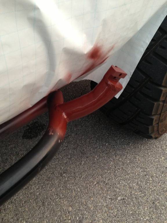

    The paints drying as I type. We'll see if they're set enough in the morning to bolt on before work.

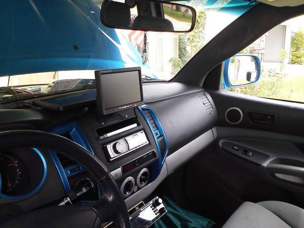

    monitor and cameras come on when I turn the truck on, and then I have a switch under the steering column to toggle between cameras.
    something to keep in mind if doing this yourself, is to make sure you have a quick and easy means of switching the camera display orientation. if you have two identical cameras, one facing forward, and one facing back, when you switch between the two, one will be a mirrored image of what it should be. the monitor I have has a mirror button right on it. if you were to get a monitor without the mirror button, you'd have to go into the menu settings and switch it like that every time you wanted to go between the cameras. and that becomes a big pain in the butt if you are spotting yourself, and switching between cameras every few seconds.

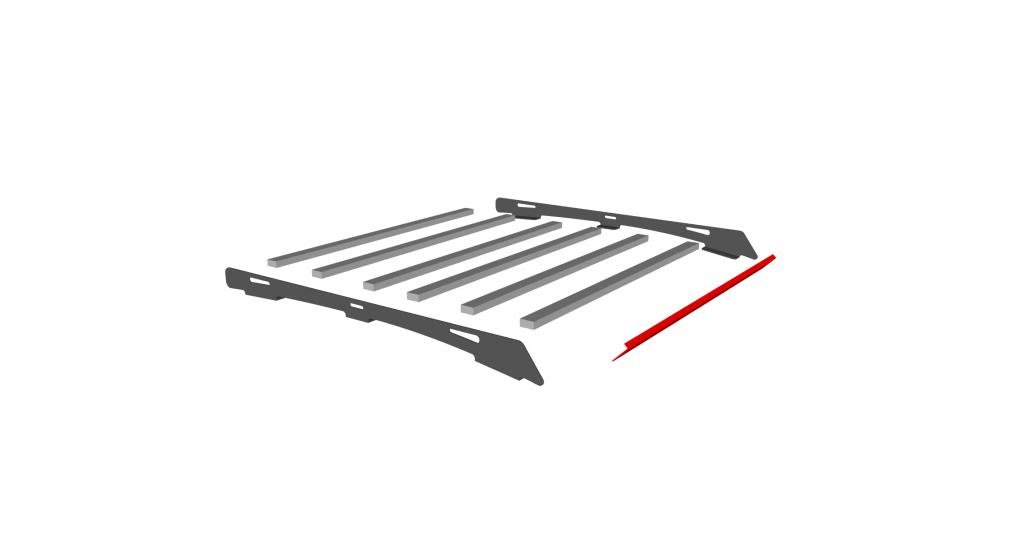

    I have my own ideas using 80/20 extruded shapes and some side plates similar to the this...
    I'm not a fan of putting the rails on spacers like this guy has done. I'd rather have the feet sit right on the rubber molding. I will also bring the front further out so it will hold a 40" LED bar.
    I'm planning on using one of these two profiles for the cross bars.
