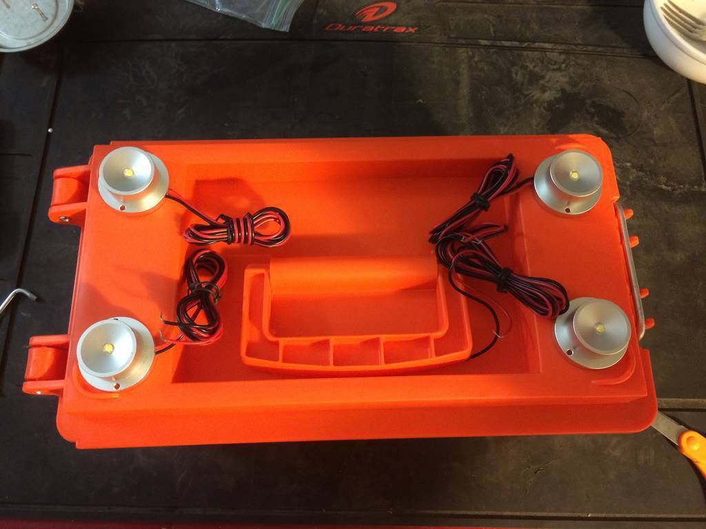

    New project started this evening. taking the ammo can light idea, and improving upon it.
    instead of a standard military style ammo can, I've opted for a watertight marine tool box. figured if it's going to be used at night, might as well make it really hard to lose in the dark and go with bright orange :p
    going to have a spot beam on the front, and 4 single LED floods on the top. the 4 will be on one switch, and the spot on another. the 4 top LEDs will be perfect for illuminating a tent at night, or for working under a vehicle, while the spot up front will cover everything else. Power is coming from two 6v computer backup batteries that i'm wiring in series. they are nice, high capacity batteries, so they should power the LEDs for plenty of time. I am also fitting the box with a 12v outlet. this will be how I charge the batteries, as well as give me an option to use the batteries to charge small electronics, in addition to powering the lights.

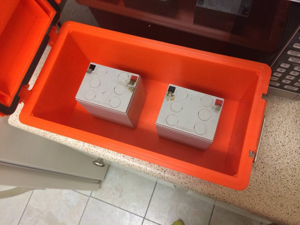

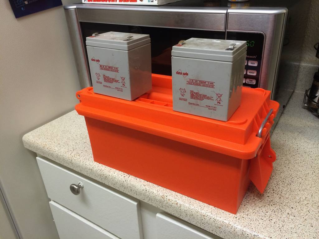

    here's the box and two batteries
    Some extra room in the box, but this will give me the needed space to pad and secure the batteries, as this will eventually be mounted in a quick release fashion somewhere in the bed. the extra space will also be used to secure the built-in charge regulator and any other electronic components.
    These are the 4 flood lights that will be mounted facing upwards. They are actually marine pods, that are designed to be permanently mounted under water on boat hulls, so water will not be an issue for these guys.
    This will be the general layout of the floods.
    The floods will be mounted recessed. I tapped the holes in the aluminum body of the LEDs, so two small machine screws through the top will have them nice and secure. then just seal it up and it's good to go.
    The rest of the parts I need will be here Friday. here's the LED spot I got.
    Got two Rigid Industries, waterproof rocker switches, that will be mounted on the top of the box.

    Vertical floods mounted and sealed. drilled and tapped the holes for 6x32 and used stainless hardware with some clear marine silicone. picked up some other stuff for it from the hardware store today. rest of the stuff comes in the mail tomorrow.
    darn box is so bright that it throws off my camera....

    Tested the batteries out last night after having them on the trickle charger for a day and a half. batteries are about 5 years old, and aparantly, spending 6 months in an un-airconditioned florida storage unit finally killed them.
    picked up one of these as a replacement. same voltage and capacity, just one battery instead of two, linked together. will be here tomorrow.
