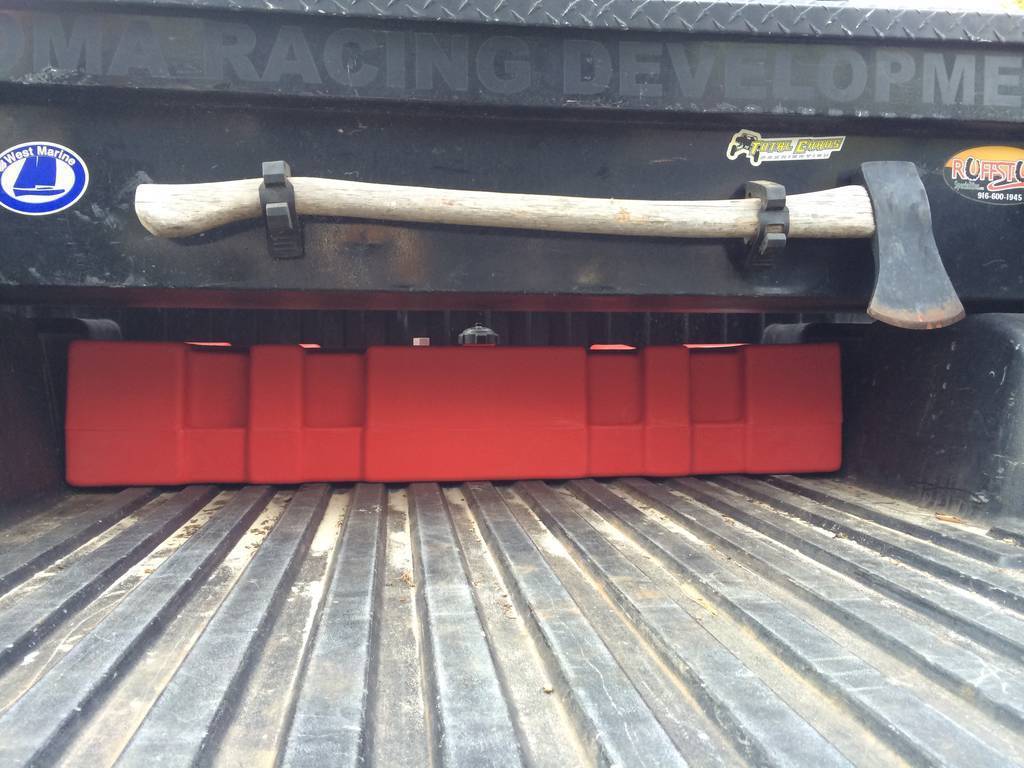

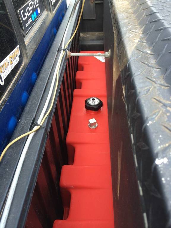

    I don't know if you've figured out the transfer system yet, but I'm wondering if a shrader valve and a OBA system would work. Install a schrader valve on the tank, pressurize with OBA and let it flow. Flow could be controlled with a brass on/off ball valve.
    Just a thought

    since it's a marine tank, there is a pickup at the lowest point of the tank, with a fitting on the top of the tank (seen in the picture). i have two fuel pumps that will connect to that fitting in paralelle, so with the flip of a switch inside the cab, all of the fuel will be pumped into the factory tank.

    If someone wanted to do a simpler version would a ball valve attached to the bottom fitting and plumbed to a T in the fillneck hose allow for a simple gravity fed system? You got me thinking. I was gonna mount a fuel can on the swing out I'm having built next week but this fuel tank looks like a better solution.

    that's a good option for a zero electronics setup.
    or you could use an electronically actuated ball valve if you wanted to use a gravity feed system while still having on the fly control from in the cab.
