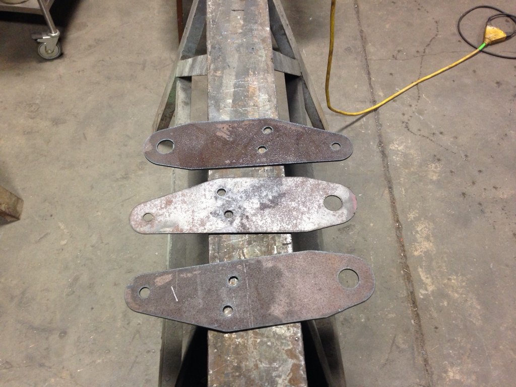

  15. Aug 7, 2014 at 8:01 PM
    #4735
    HomerTaco
    Mar 28, 2010
    #34129
    45,874
    HomerTaco
    HomerTaco
    HomerTaco
    Frame reinforcement?
  16. Aug 7, 2014 at 8:08 PM
    #4736
    SMKYTXN
    Mar 11, 2011
    #52810
    14,040
    Nathan
    Houston
    11, 4dr, TRD Sport, 6sp
    DCFB
    Those are the start of the new rear bumper that's going to sit under the flatbed. They'll be thicker of course, just cut them out of 10 gauge to see how my measurements lined up.

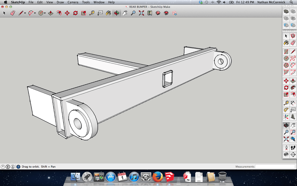

    Edit:
    You can see the recovery points in this sketchup mockup. I didn't fully model the frame plates in this model though.

  17. Aug 7, 2014 at 8:24 PM

    you going to buy chamfered weld washers, or straight cut your own reinforcements for the shackle eye on the cnc?
  19. Aug 7, 2014 at 8:30 PM
    #4739
    SMKYTXN
    Mar 11, 2011
    #52810
    14,040
    Nathan
    Houston
    DCFB
    I'm going to cut the cheek plates out of 1/4" plate and weld them on. They're not needed for bearing, they'll just take the slop out of the shackle.
