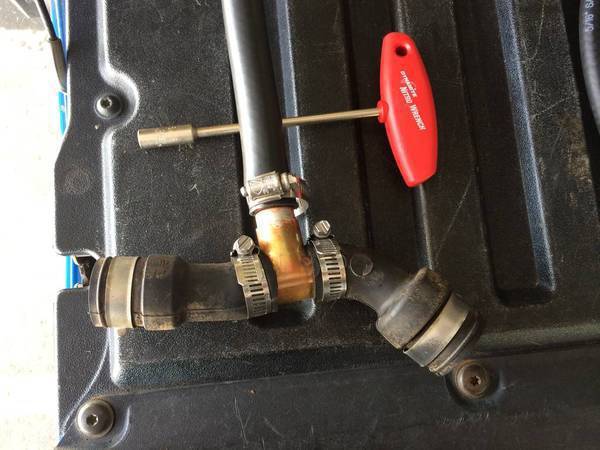

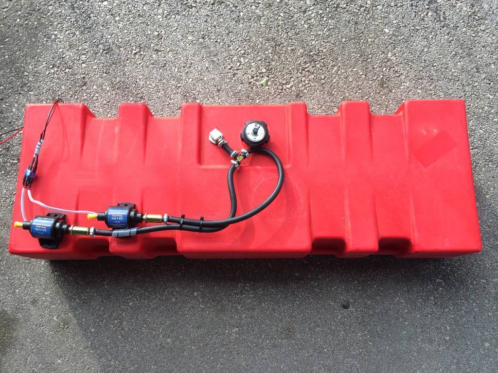

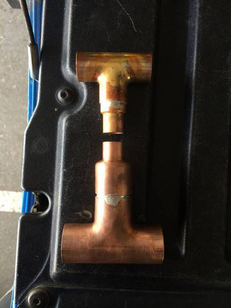

    With lots of help from Nathan yesterday, the auxilary fuel tank instal was completed. tested it out last night with 5 gallons, and it works well. i'll have to do a full fill on it and time it to see how long it takes to transfer and entire 16 gallons.
    Had to make an emergency trip to the hardware store so a new tee could be built. inlet size was correct, but the thwo ends that fit the existing filler tube were too large. on on top is the new one.
    Rubber portion of the filler was cut and trimmed to fit.the new tee
    installed
    little yellow clip is a bitch to undo.....
    the tank and pumps that now sit under the tool box.
