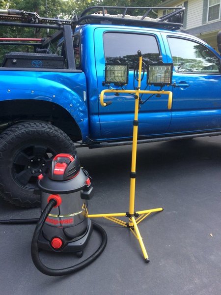

    speaking of her being away, I think my mind goes into cruise control when she leaves. I left the house at noon to go get a haircut. came back an hour later with the below garage goodies. 5 0'clock rolls around, and I realized that I never actually got my hair cut :facepalm:
    curious what new tools i'll come home from tomorrow's haircut with...
