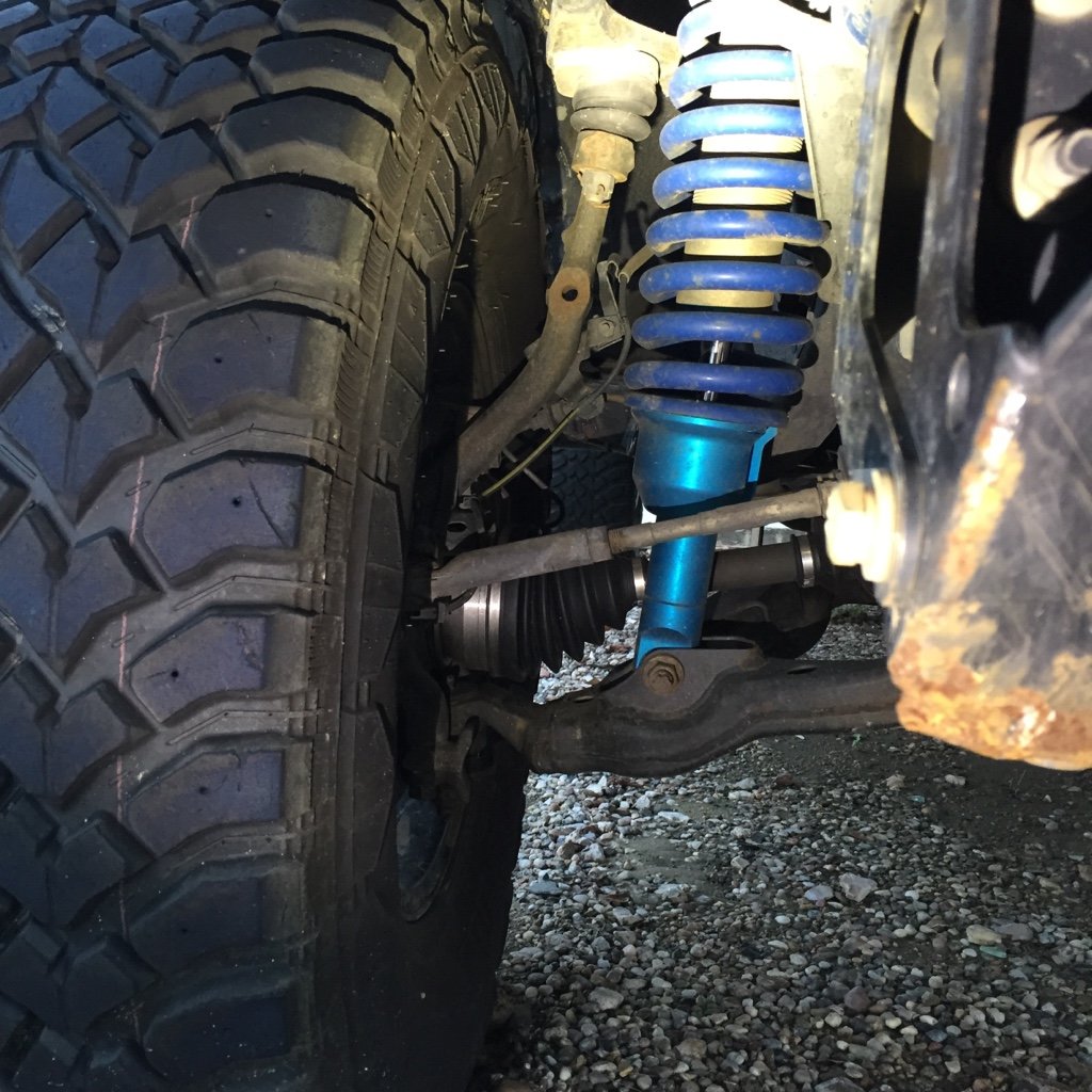

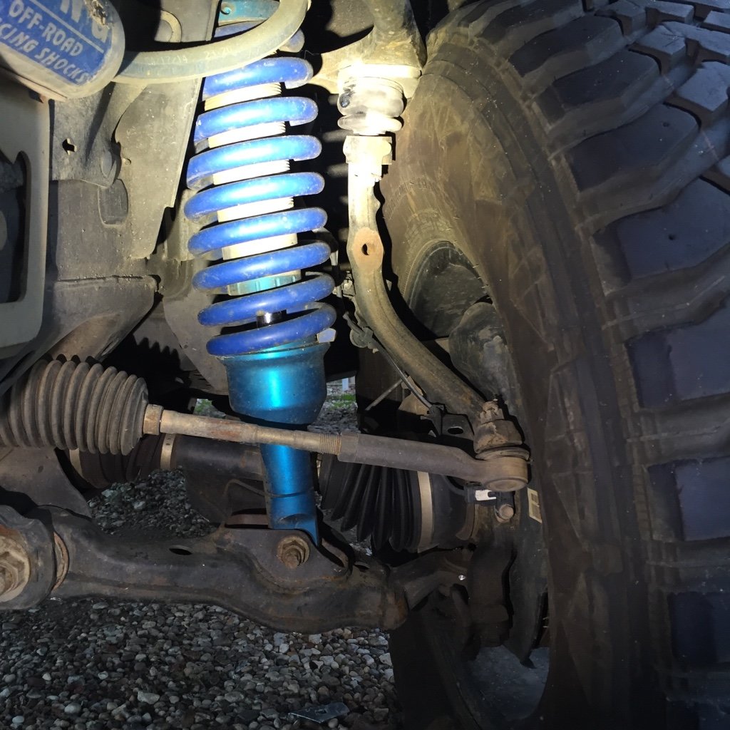

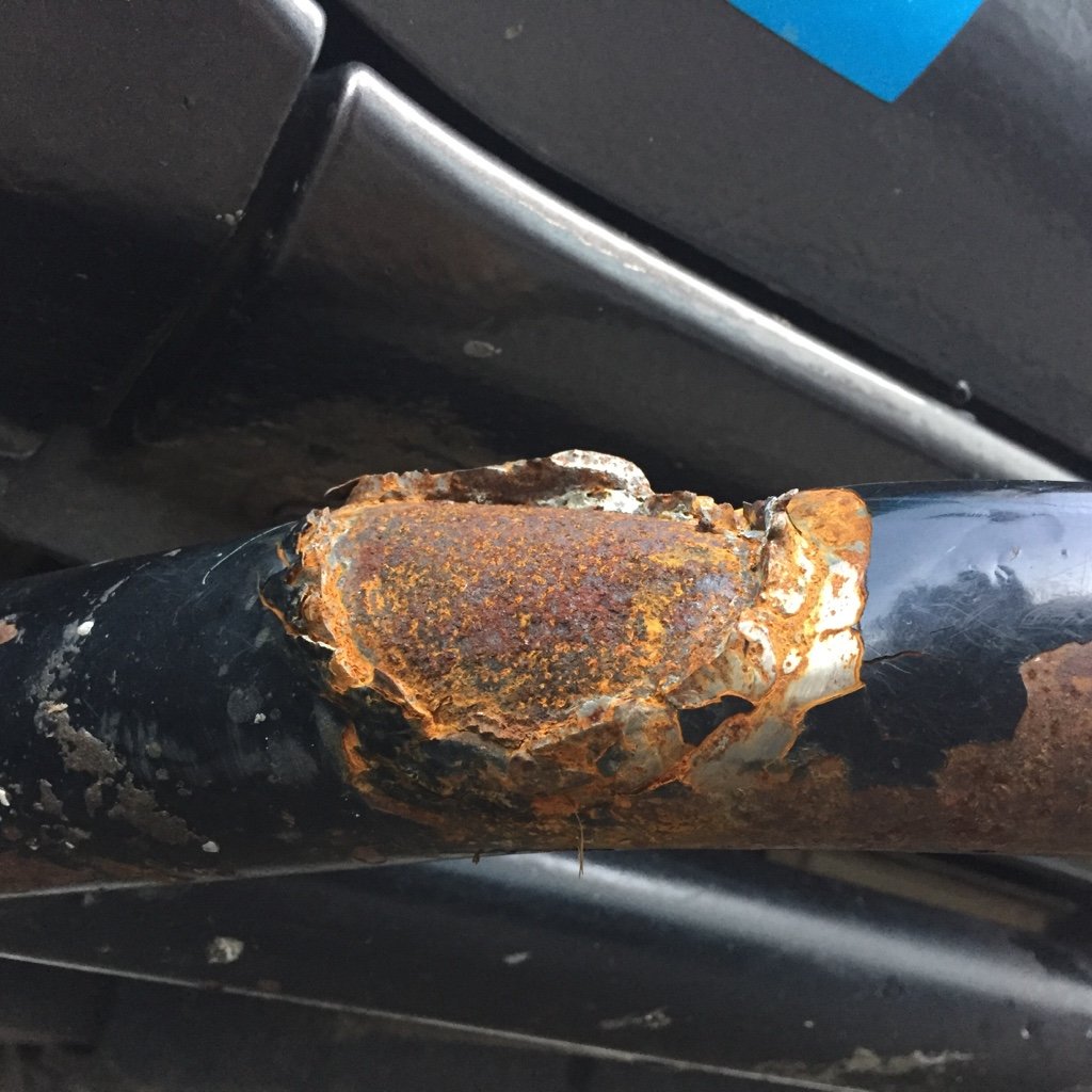

    Here's the slider in question.
    I'm gonna go out on a limb and say the spindle is bent.
    Here's the passenger side for reference.

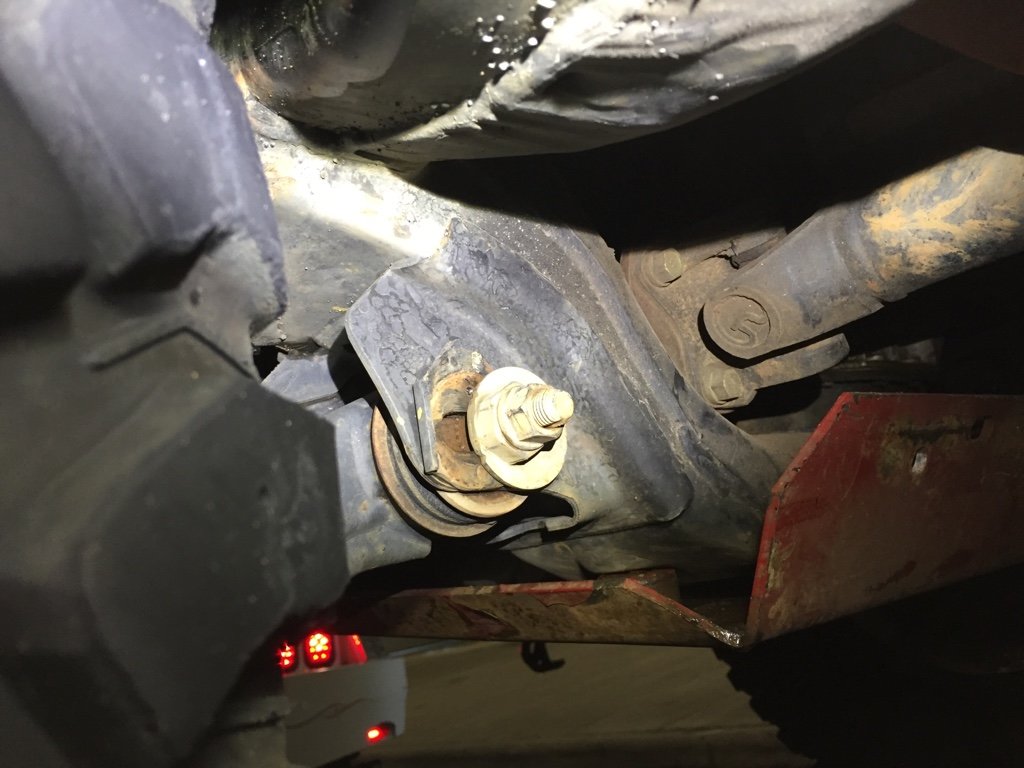

    And the lower control arm pushed through the tab.

    My driver's side Lower Control Arm pushed through the alignment tab two weeks after I lifted my truck and took it off road. Purchased 3 year alignment program through sears and been taking it in every month or so to realign! Finally going to 6" lift this week, so will have new cross member and new tabs.. :) @SMKYTXN

    well shit......
    I don't know if it would have made a difference with a slam like that, but it looks like we got great penetration on the slider, but probably should have preheated (and maybe even post heated) the shit out of that billet coupler.

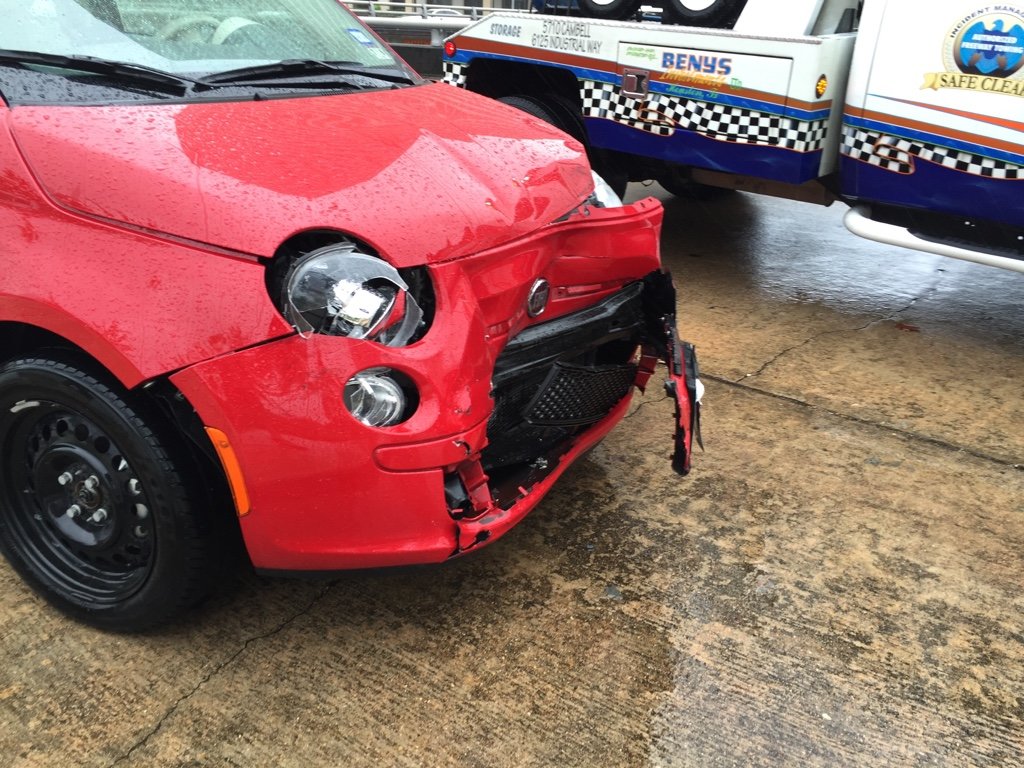

    Holy shit Nate! Who Trophy Truck launched that?
  11. Nov 3, 2015 at 9:08 AM
    #5071
    SMKYTXN
    SMKYTXN If it can't be overdone it's not worth doing Vendor
    Mar 11, 2011
    #52810
    14,040
    Nathan
    Houston
    11, 4dr, TRD Sport, 6sp
    DCFB
    This guy did. 04128802fd5f0d42250627014724c278_ef05857113177f3011dd4038990a6b6c748b5aa5.jpg

    The tube coupler was further up. We had a pipe to tube weld there, and yes, it held up pretty well considering. Guess I need to knock the one on the other side now. :D

    ah yes, I remember now.
    that's actually more impressive now, that the pipe did that to the slider. I would have figured that the lip of the pipe would buckle and the DOM slider would be fine. then again, we did ise sch 40 pipe, that has about the same wall thickness as .120 DOM, so that would have created one hell of a pressure point.

    Yup. The pipe was about 6" long, so there was a pretty good moment arm on it.
