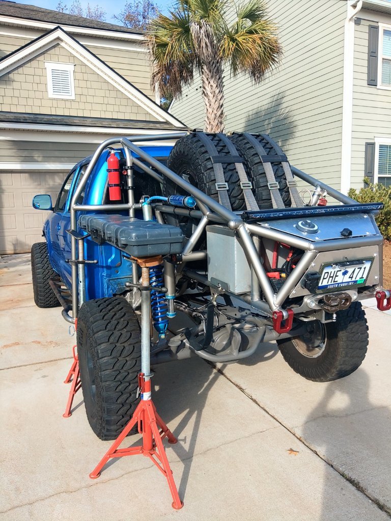

    Couple of videos I forgot to post.
    First is the new rear view/dash cam. With the spare tires right behind the cab, my rear view mirror is useless. I'm used to that though since my old setup blocked the rear window a well. What I'm not used to is not being able to see the back of the truck out of the side mirrors. That'll change when build the fenders, but for now, the main hoop going over the cab is the furthest back thing I can see, so I needed to do something before I put the rear winch through someone's windshield, backing out of a parking apace. I went with the Wolfbox. It clips over your rear view mirror, has 4k front and rear cameras. The front camera is built into the unit, and I put the rear one on the aluminum filler panel above the rear winch. Absolutely love this thing. Crystal clear and easy to use. Had all of the normal loop recording features that you'd expect from any decent dash cam, but the touch screen makes navigating and adjusting it super easy.
    https://youtu.be/DragPi9V_wc?si=_MNk07qzSvWypTMK
    Second video is just an RTI clip from another angle. Really shows off the rear tuck....and lack of front movement (for now).
    https://youtu.be/JcIS693WiR4?si=b3fxsTealnF-F91D

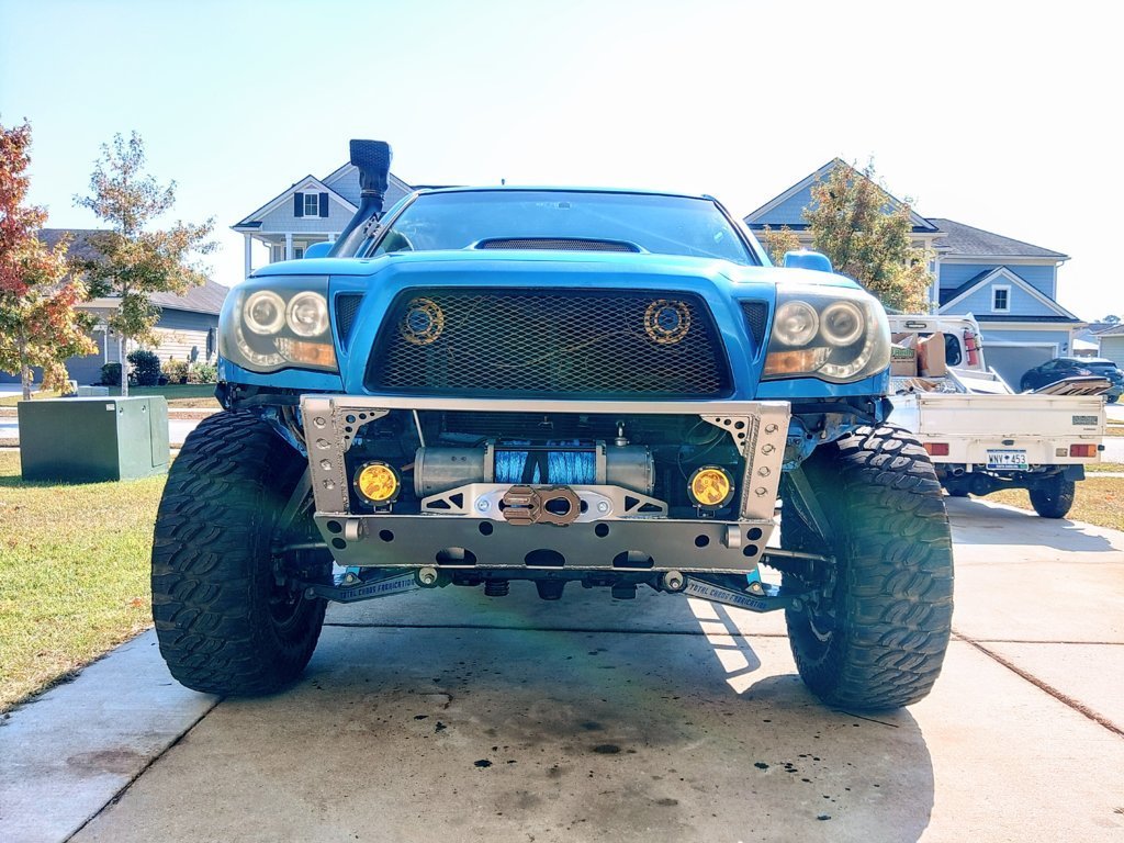

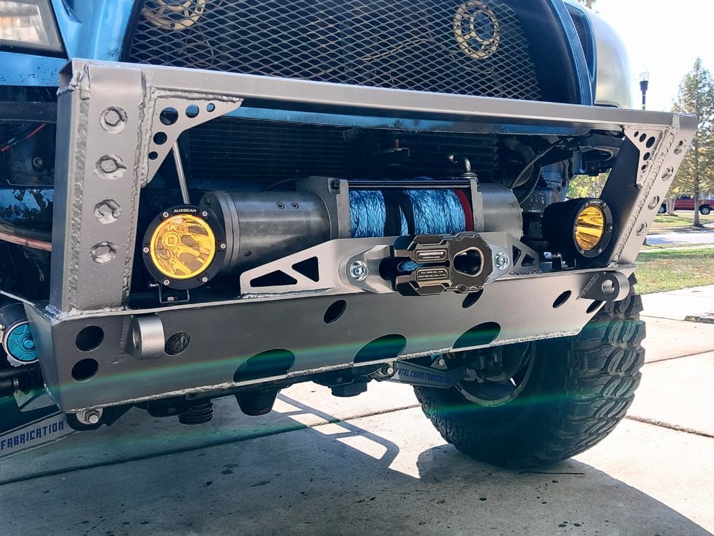

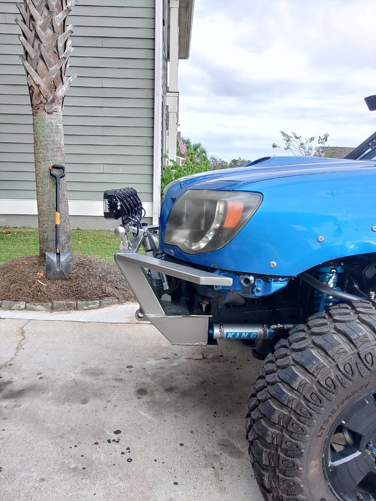

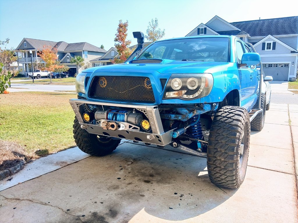

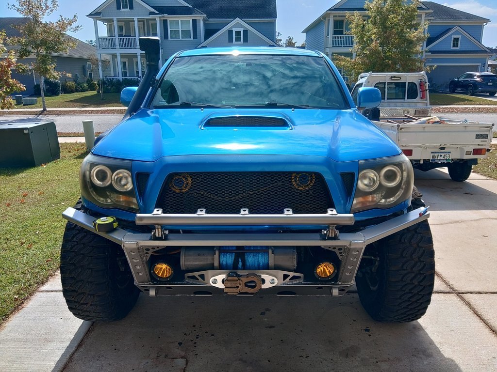

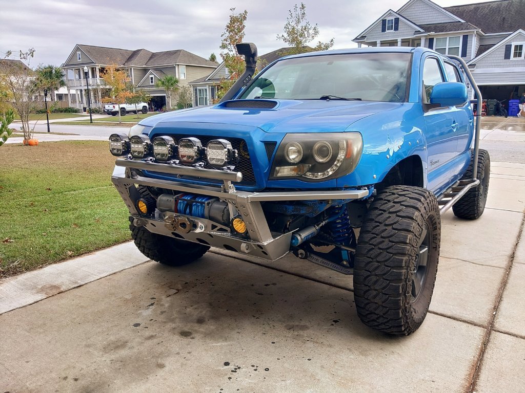

    Got a start on the new front bumper that will ultimately tie directly into the engine cage.
    I like having usable fog lights, and hate people who blind everyone else on the road, so I got some lower powered LED fogs and wired them into the factory switch.
    Winch is my 13 year old XRC 10 Comp that just keeps kicking. I took it apart, sand blasted each piece. Reassembled with new grease, and clear coated it. Painted the drum bright red as a visual indicator that I'm out of line. All winches should come with bright drums for in my opinion. No easier way to determine how much line you have left from 80 feet away.
    Got some new amsteel and the same agency 6 shackle that I have on the rear winch. I'll likely make an aluminum cover of some sort for the winch to keep the winch line shielded from UV damage.
    Fairlead mount is from TMR Customs
    Bumper itself is about 20% of an OG high clearance All Pro. I chopped the lower radiator crossmember off and welded in a new one about 3-4 inches higher. Chopped the bottom of the bumper off the same amount and re-plated it with 1/4" steel.
    The two uprights are 3x3x1/8" square tube. It's a very strong and rigid shape, but because of the 3" wide flat face, it dents easily. Once dented, most of the strength disappears, so the front faces got 1/4" scabbing plates. The plates extend above the 3x3, and contour across the face of the 1x3 crossbar.
    Light hoop and wings will be next.

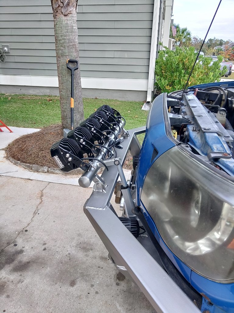

    Got a little further on the front bumper. Adding a twist to the light setup.

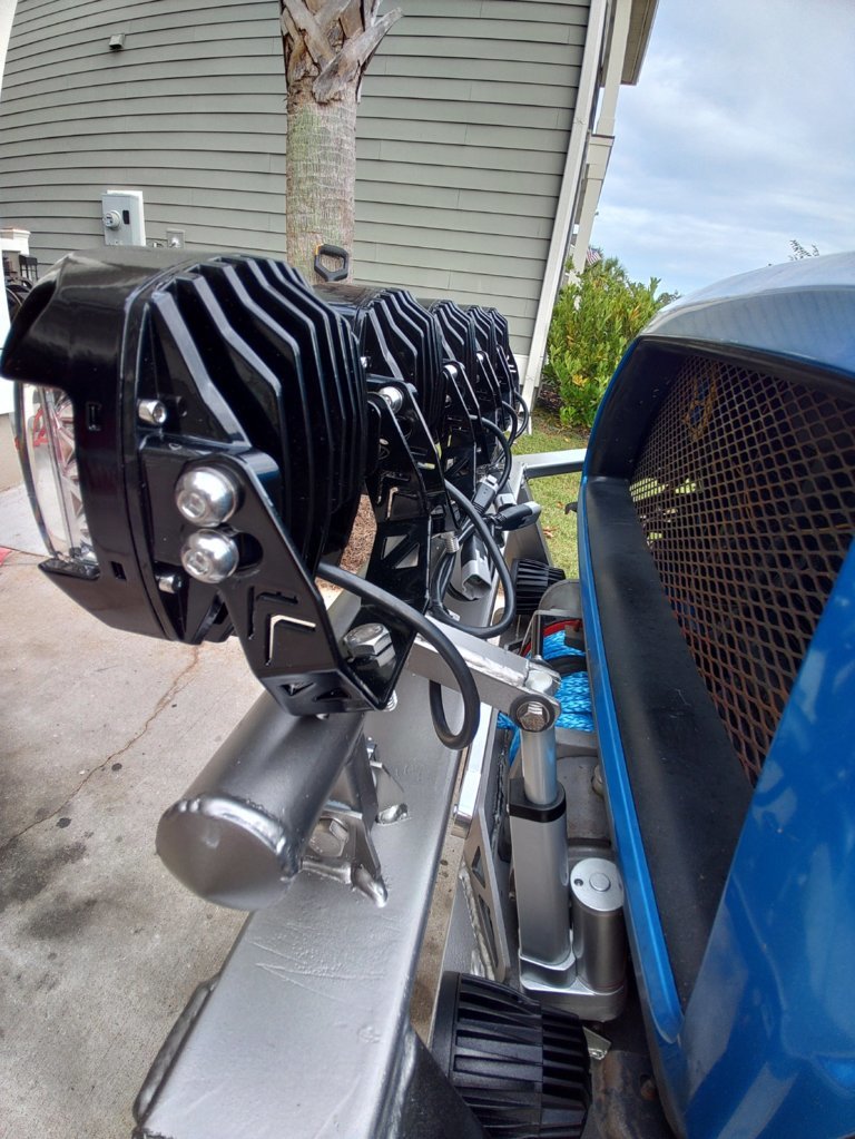

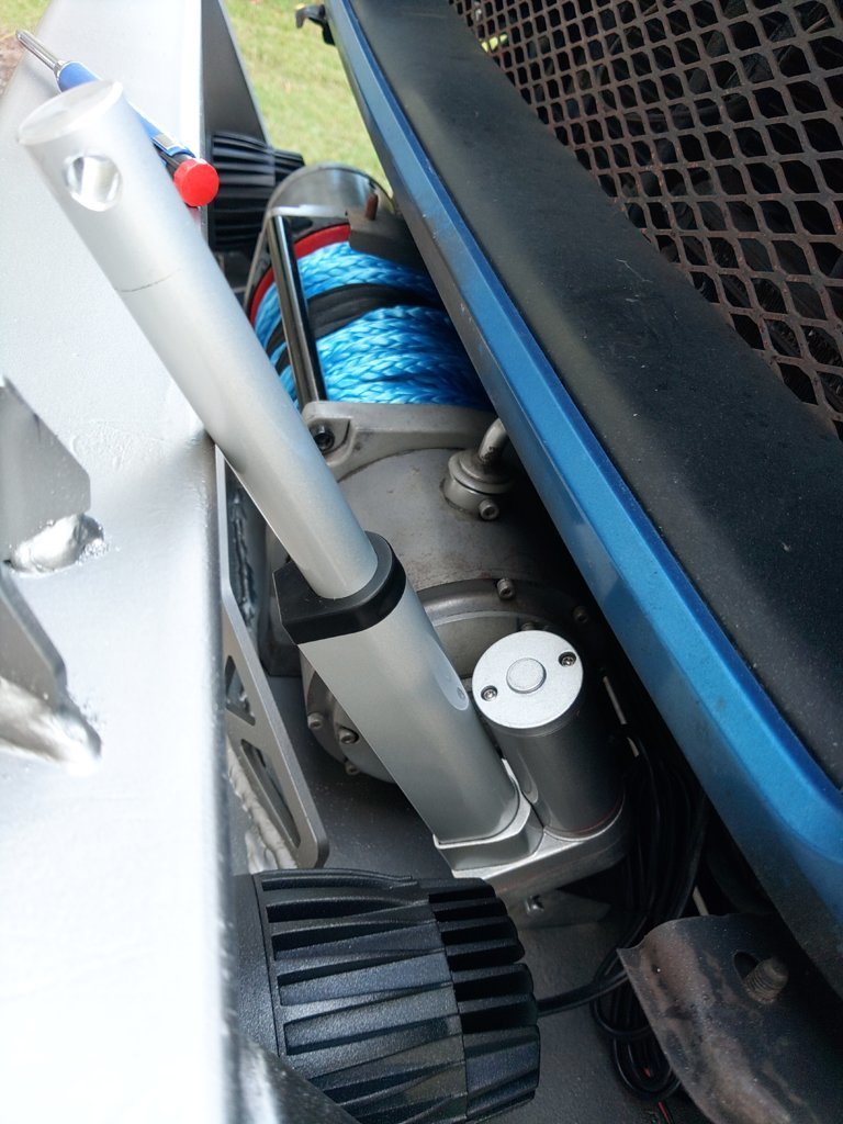

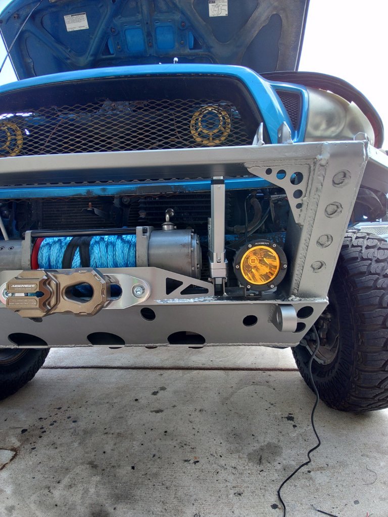

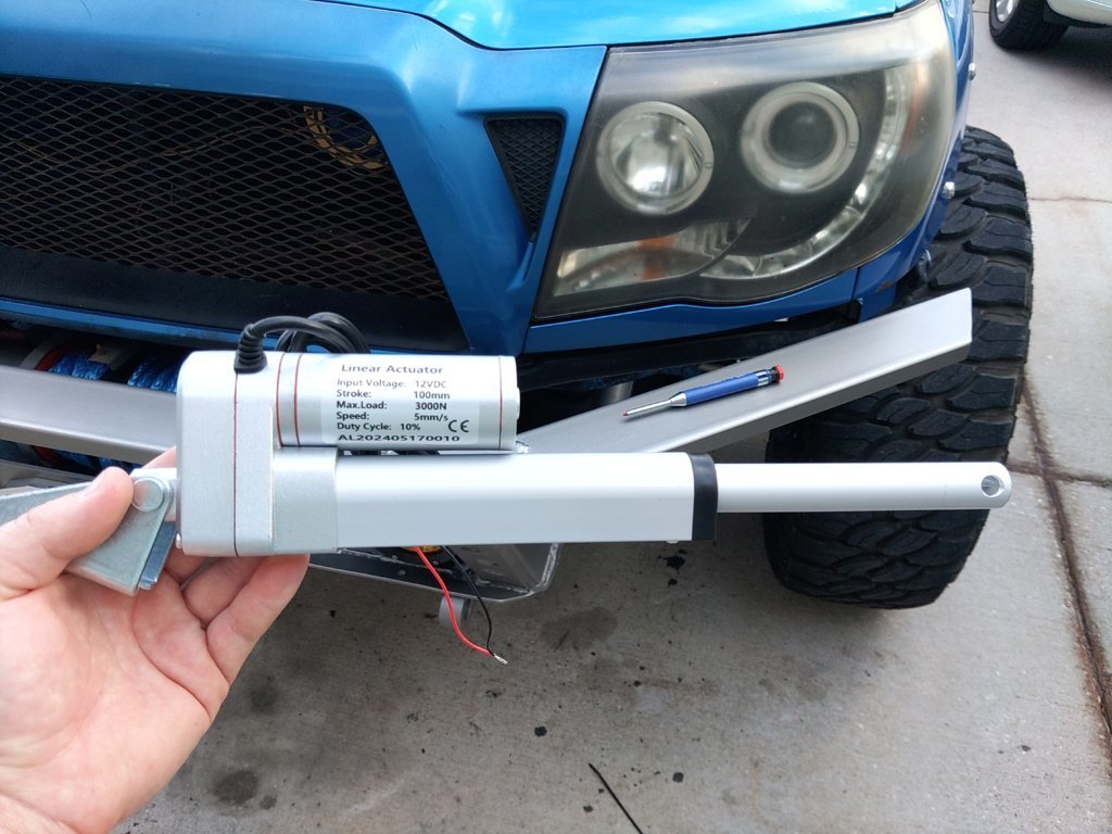

    finished the aimable light bar. manually wired up a test, but haven't hard wired it yet. still need to sort out a light hoop and wing supports for the bumper.
    linear actuator was a perfect fit on the planetary side of the winch between it and the fog light.
    lights aimed all of the way down. good for access to the wiring and hardware.
    lights in a general driving position.
    video of them going from limit switch to limit switch. with about 15 seconds for the 4'' stroke, they should be very finely adjustable once they're properly wired.

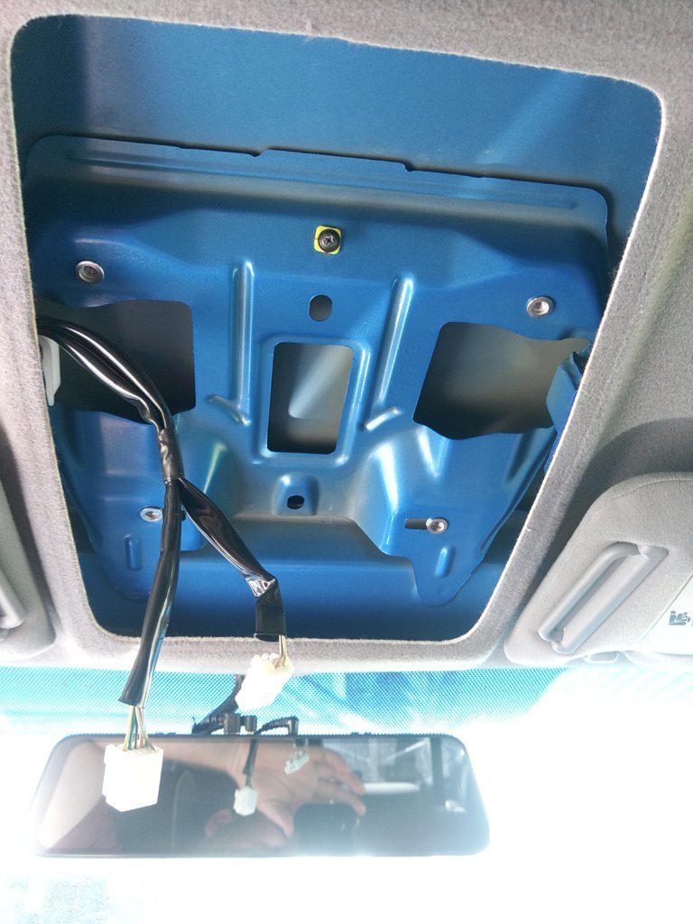

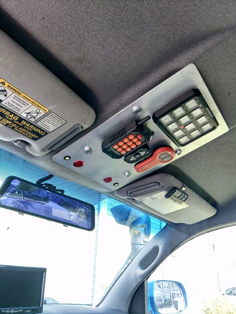

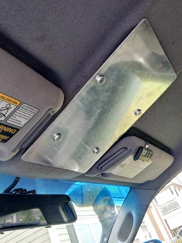

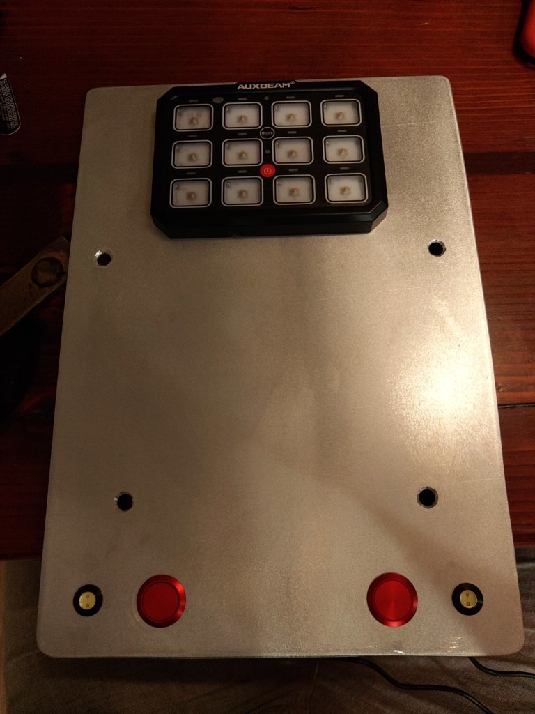

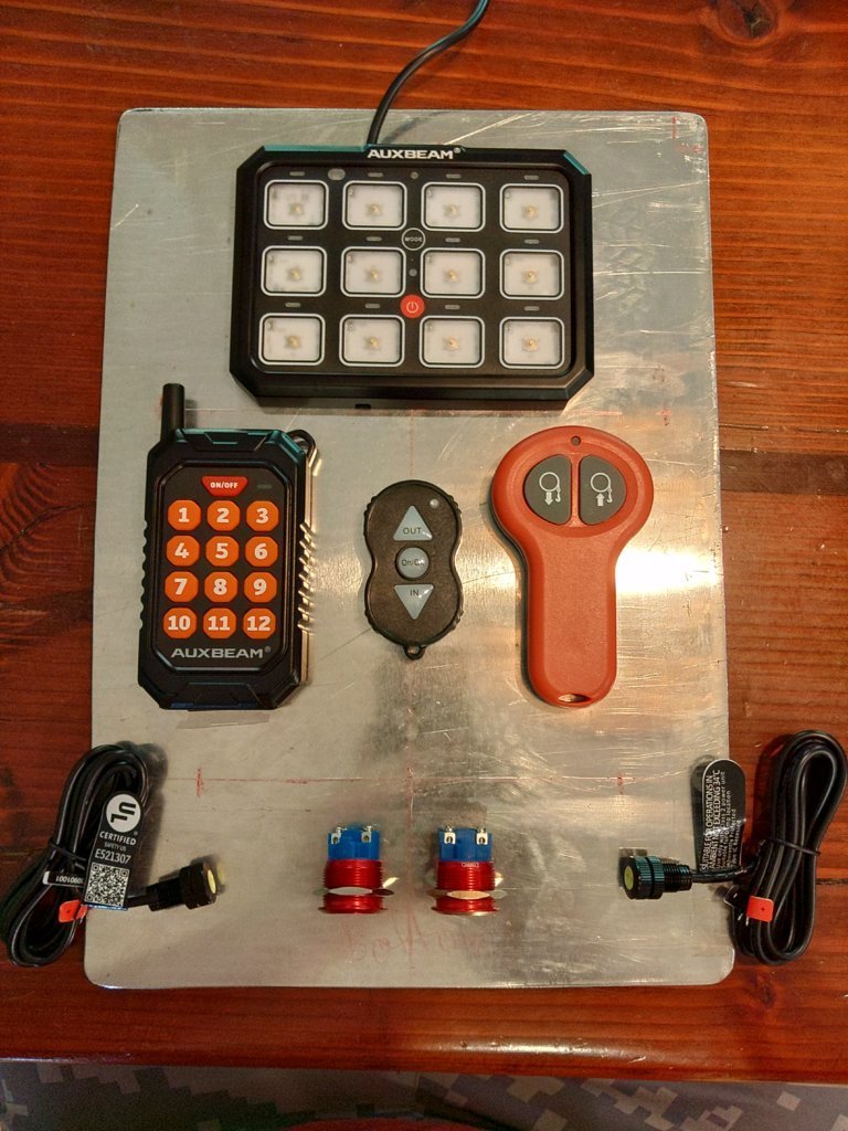

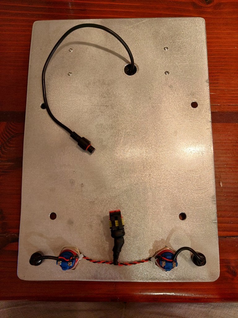

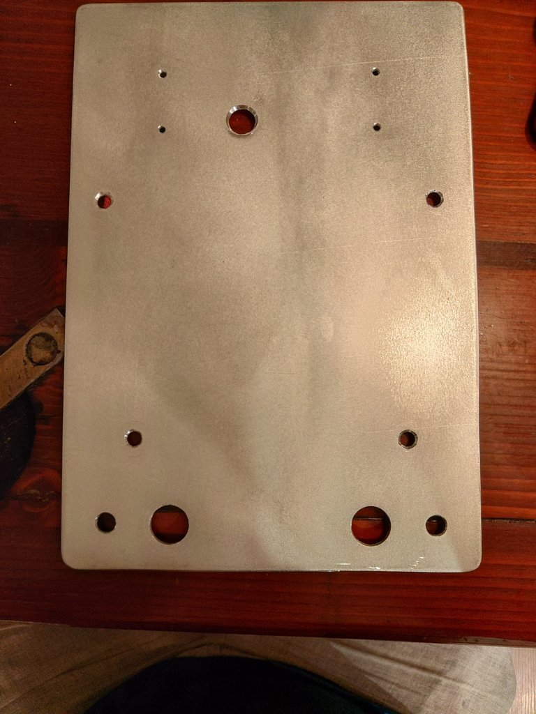

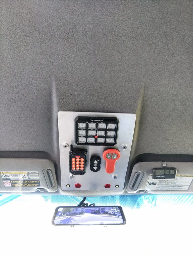

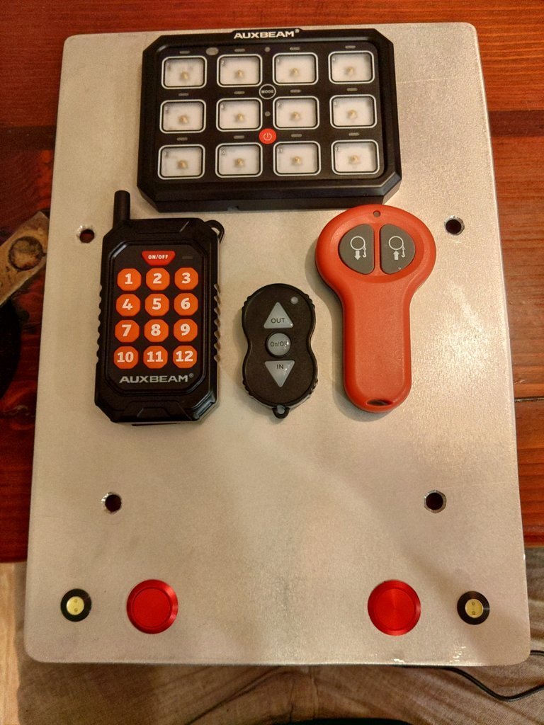

    Redoing a bunch of wiring. Decided to pull the sunglasses holder/compass out of the headliner and build a more useful panel to house a new switch system and mount the wireless remotes.
    Pretty simple project overall. I'll get I mounted up this weekend.
    Started by putting some riv-nuts into the existing structure and laying everything out around the mounting holes.
    Test fit it before .moving forward.
    1/8" aluminum plate
    Mounting and cable holes for the switch panel and the replacement map lights and buttons.
    Panel and map lights mounted
    Heavy duty Velcro attaching winch remotes to the rear and suck-down winches, and the remote that can control the switch panel.
    Plenty of room left under the remotes for future additions.
    Back of the panel wiring.
    Torspd and Wishbone Runner like this.

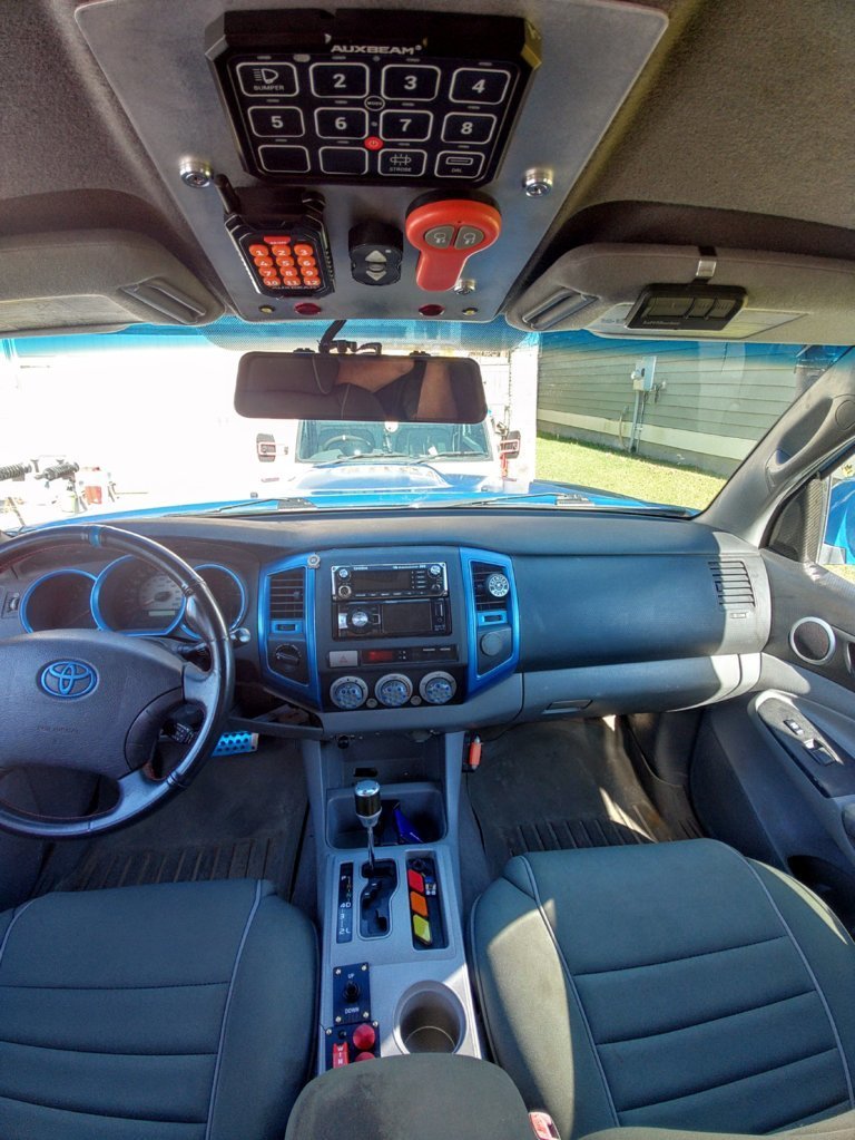

    All done, with the data cable running to under the hood, where I need to mount the relay box.

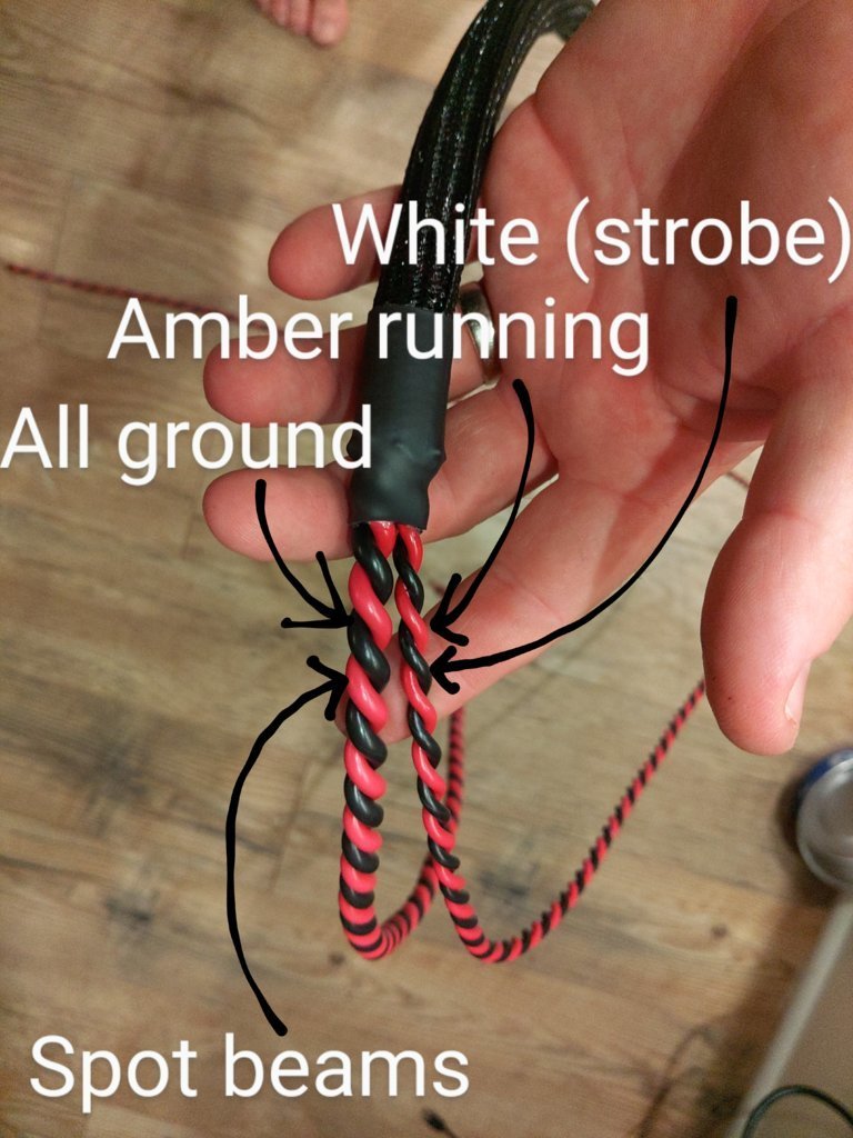

    Finally ran the 4/0 power cables from the rear winches up to the battery. Got everything hooked up, including the 600 amp fuse. Hooked the rear winch up to the kie truck and drug it 100 feet with the parking brake on to spool the synthetic line.

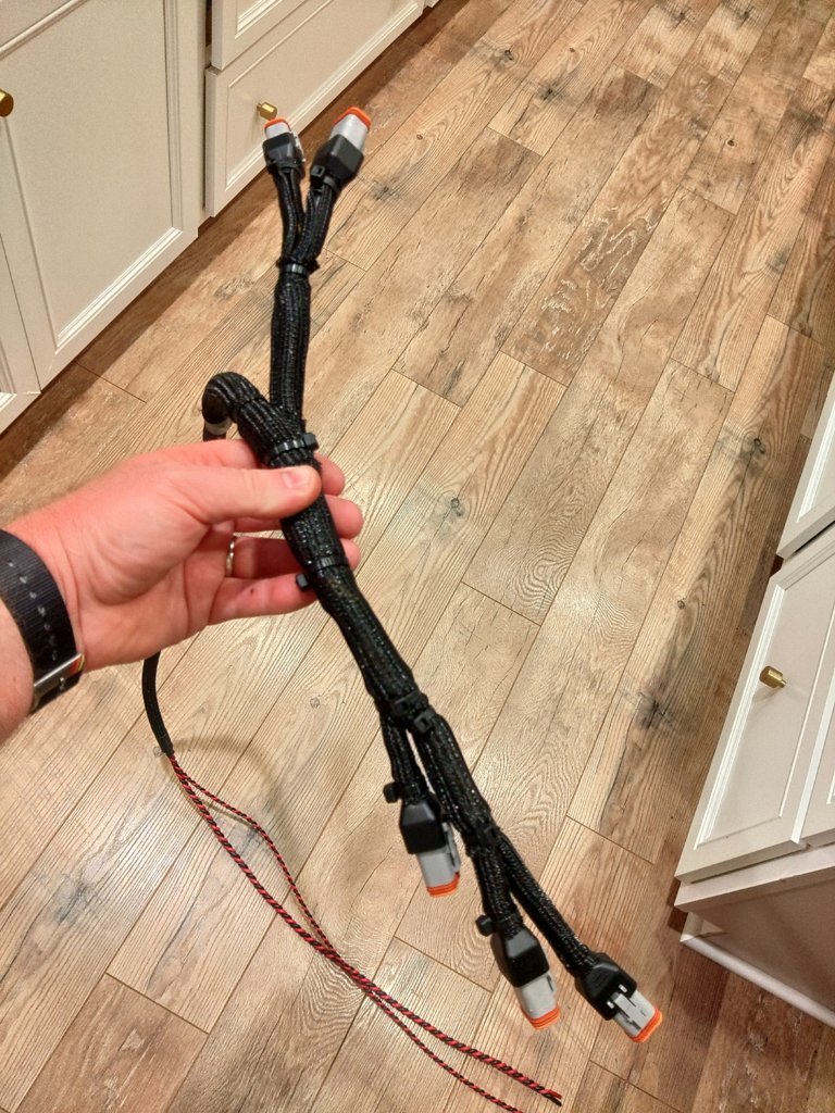

    Made a harness for the front lights on the actuated mount. Not my prettiest harness, but getting 20 wires down to 4 with as few solder joints as possible wasn't a pleasant experience.
    Testing the various light functions with the wireless remote. Can also control everything with an app on the phone.
    Spot beams > amber running lights > white running lights programmed as strobes.

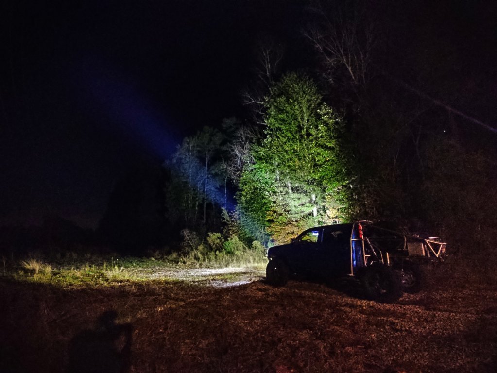

    Night test with the aimable spot beams. Probably illegal to aim this much light at the sky, so it was a quick test. Shot the range finder at the large steel high voltage towers in the distance. Came in at just under 1000 feet away. Couldn't get a good reading on the trees behind them, but guestimating they're another 3-400 feet out.
    They're no match for the HID pencil beam I had on the bumper previously, but they're on par with my old HID spot beams, and at 1/4 of the amperage, which is great.
    https://youtube.com/shorts/KHciWMvMks4?si=CfyQ6AeF1oRoDPLw

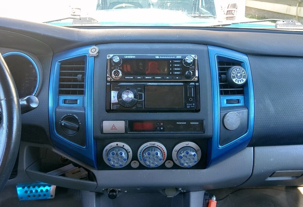

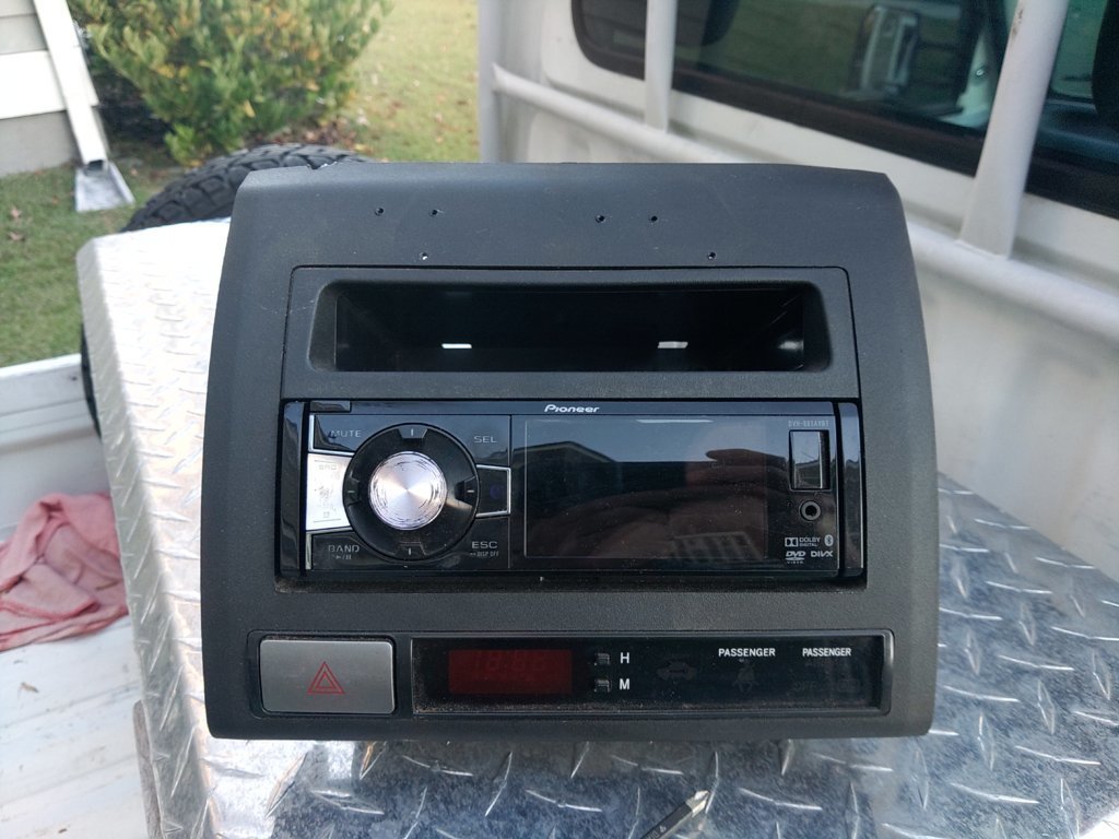

    Been wanting to relocate the CB for a long time. Had it tucked low in the center console cubby blocking the two front cupholders and the 12v outlet. Got that space back by cutting out the useless little pocket above the head unit. Ill power it off the stereo so it comes in with the ignition if I leave the dial in the on position.

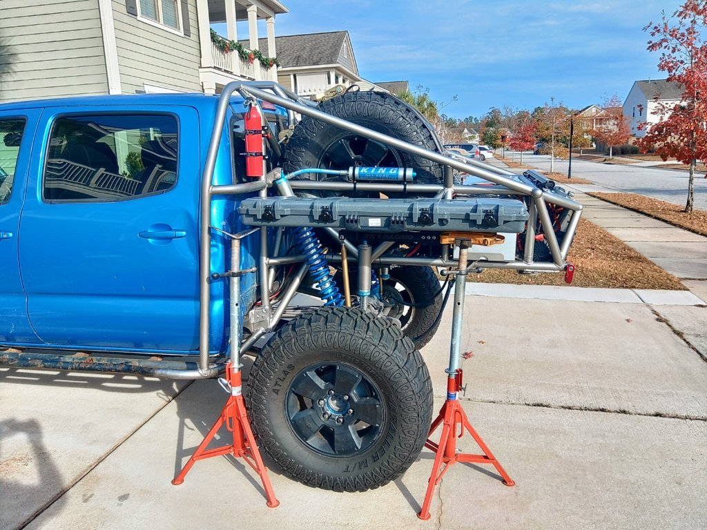

    picked up two Boyt single rifle cases for the fender build. single rifle cases generally fit the bill on width and height, but it was tougher than i thought finding one that wasn't 5 feet long. these are 4' inner dimension, so about 50 inches end to end. I got one for each side. one will hold tools, and the other will hold recovery gear. they are going to be integrated into the fenders, with protective tube below them, and the aluminum plate fender above them, which will act as a mounting surface for some future things. i have some 250 lb drawer sliders coming today. the cases will site under the fender, so that only the 5'' profile is visible from the side. they'll slide out on the rollers far enough to open the lid and give you access to everything at once. the sliders lock in the out position, so if i have to get to them in an off camber position, they'll stay out and accessible when needed.
    i believe i'll actually have to have them higher than pictured in orter to clear the tires at full compression, while leaving room to go up a size or two in the future if desired.
