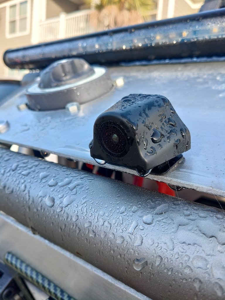

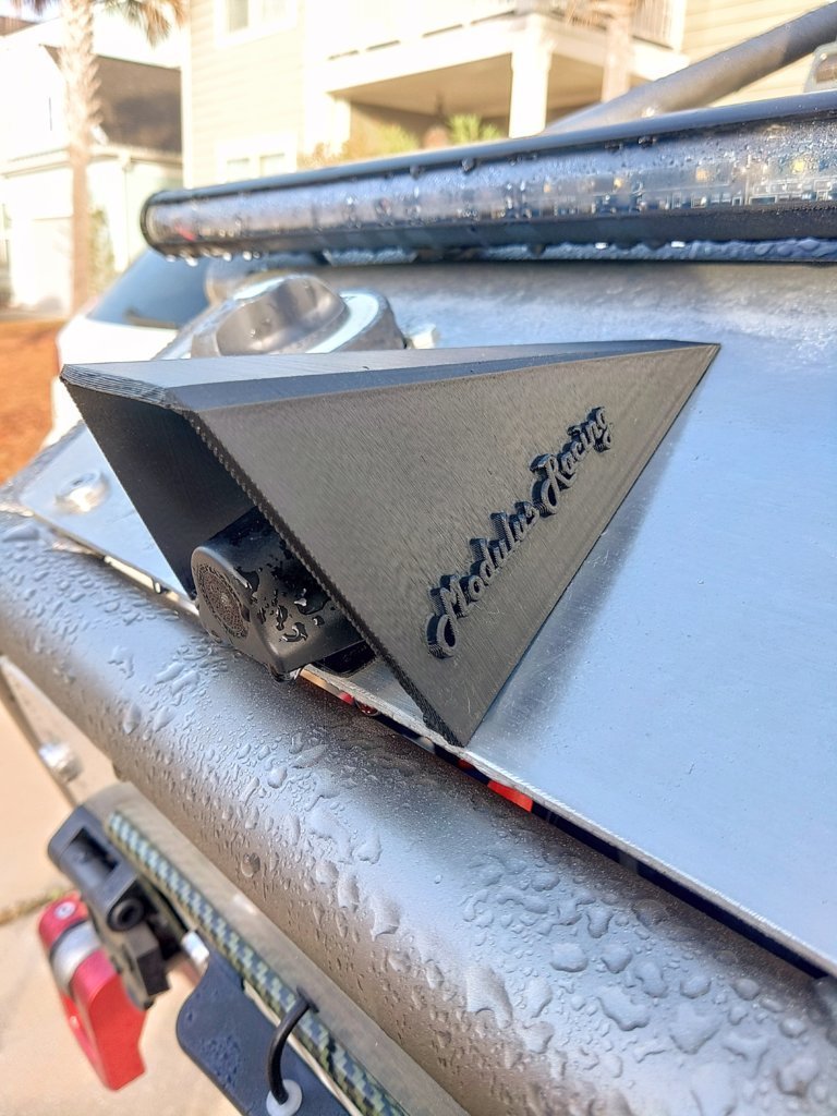

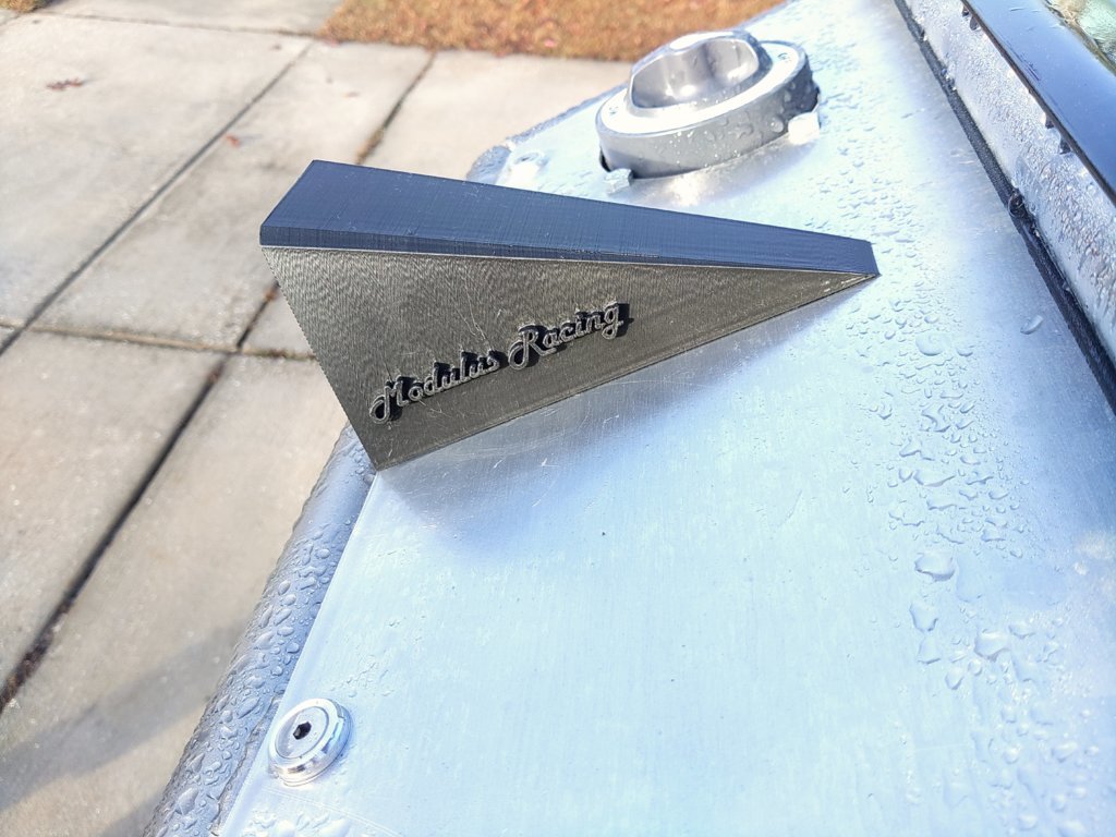

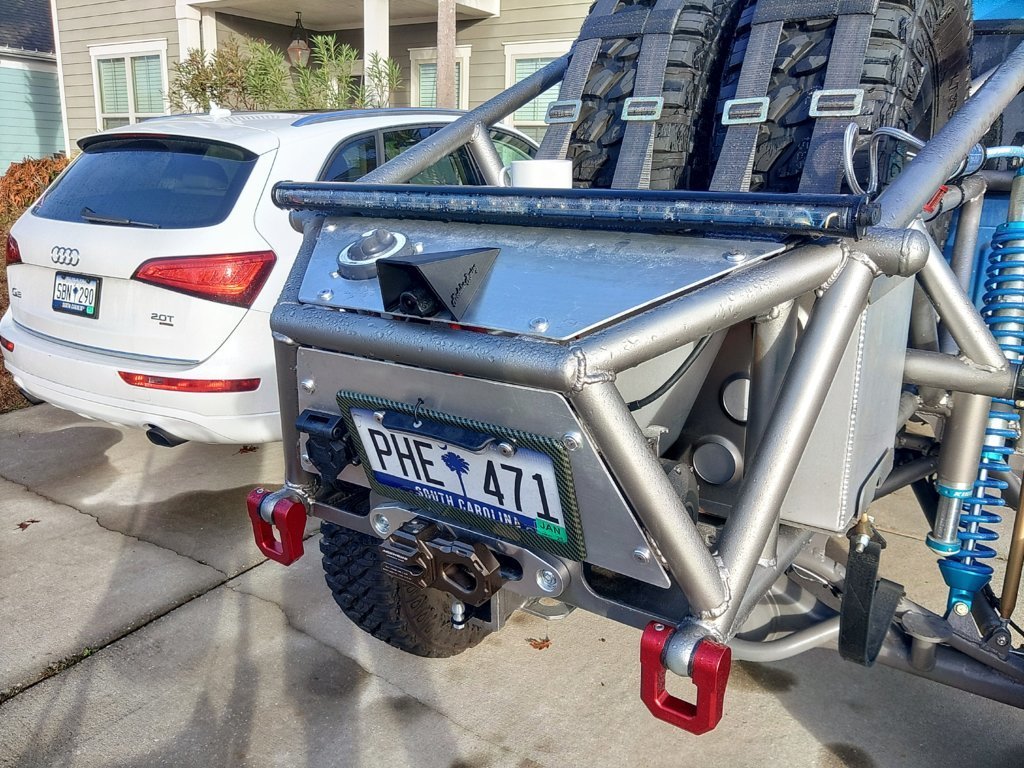

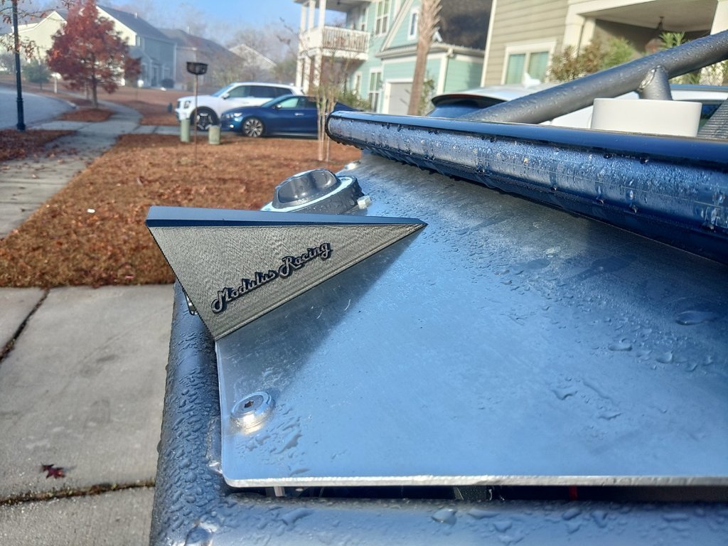

    This 3D printer has been a treat and very powerful tool for solving small, but unique challenges. I've had different rear facing camera locations throughout my trucks life, but it turns out they've always been mounted below something (unintentionally). last camera was below the spare tire on the bed rack. With the new rear-end to the truck, my camera is not underneath anything and gets covered in dew every night. Rain-x doesn't change anything and even if you wipe the camera down, it re-fogs the outside of the lens for the first 5-10 minutes of driving. So I designed a shroud that should solve the issue.
    It did not rain last night, it is just humid and dewy here. Probably 9 mornings out of 10 are like this, year round. so it's a constant problem that I'm glad to have a solution to.
    Just need to sand that front edge a bit before prime and paint, and it'll be ready to mount.

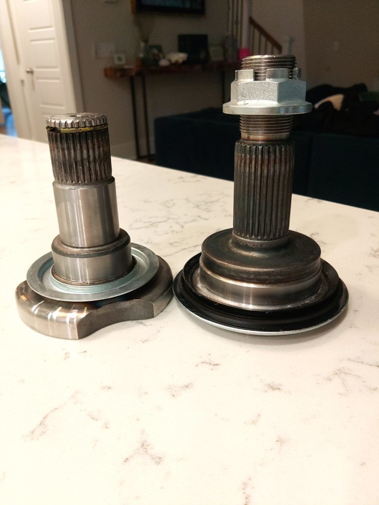

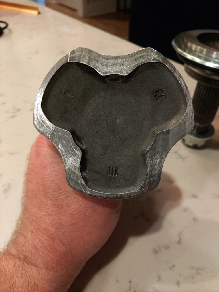

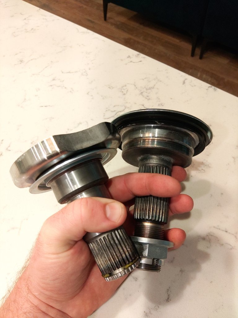

    Doubt I'm the first person to do this, but I can't say I've seen it done before either.
    Preface:
    Between buying new OEM CVs and extended axleshafts from total chaos, a spare set of long travel CV assemblies to carry on trips is in the $1,500 arena. I may go that route in the future, but with a lot left to do on the truck, that 1.5k is going elsewhere for the time being.
    Until I decide to buy/build a spare set of axles, I made a way to easily keep driving if I blow one or both CVs.
    Using my old, worn out CVs that I used to carry for mid travel spares, I cut the inner and outer joint housings off close the the seals. These are now super small and relatively lightweight, especially compared to an entire axle assembly. The inner one will keep fluid in the diff, and the outer will keep the wheel bearing together.
    I drove around with these in for the last two days and they worked great. So now I'm going to cut down the housings from the other old CV so I have two sets for myself, or the ability to use one for me and loan the other set out if me and a buddy both get stupid on the same trip.

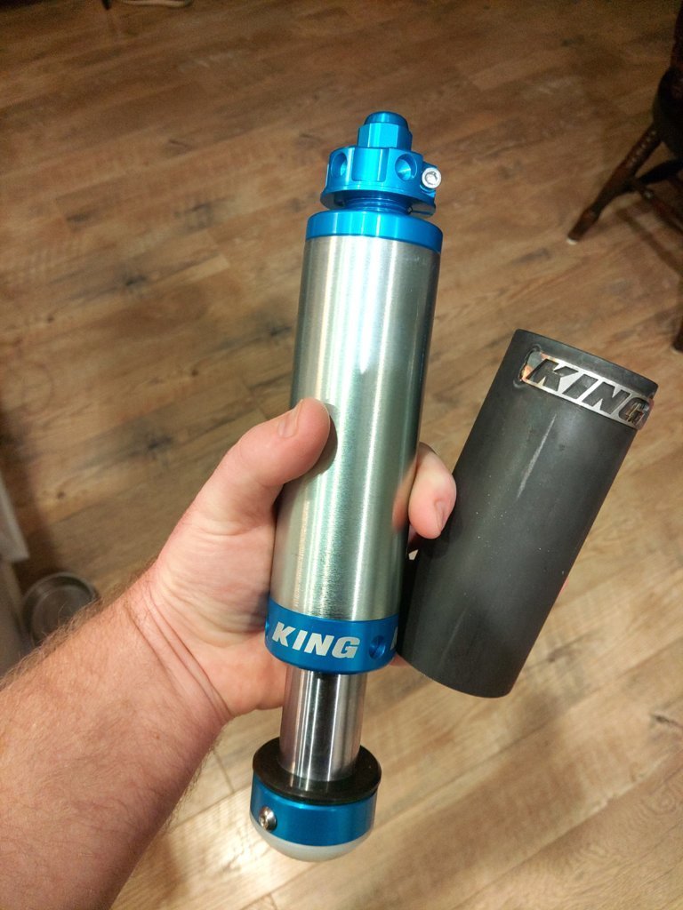

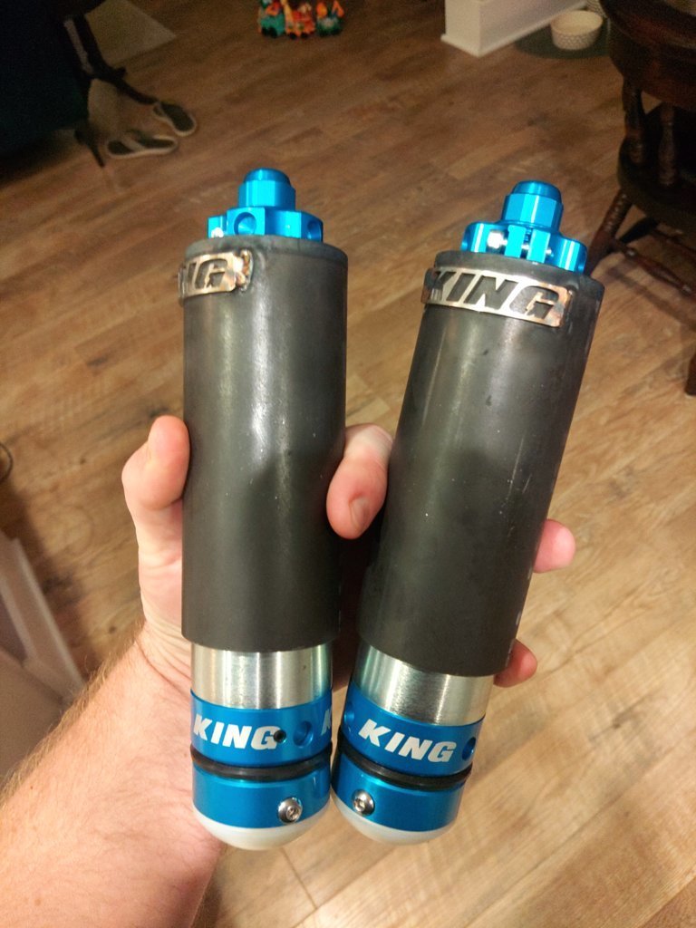

    Front pogo-sticks came in. Smaller flavor than the rears.

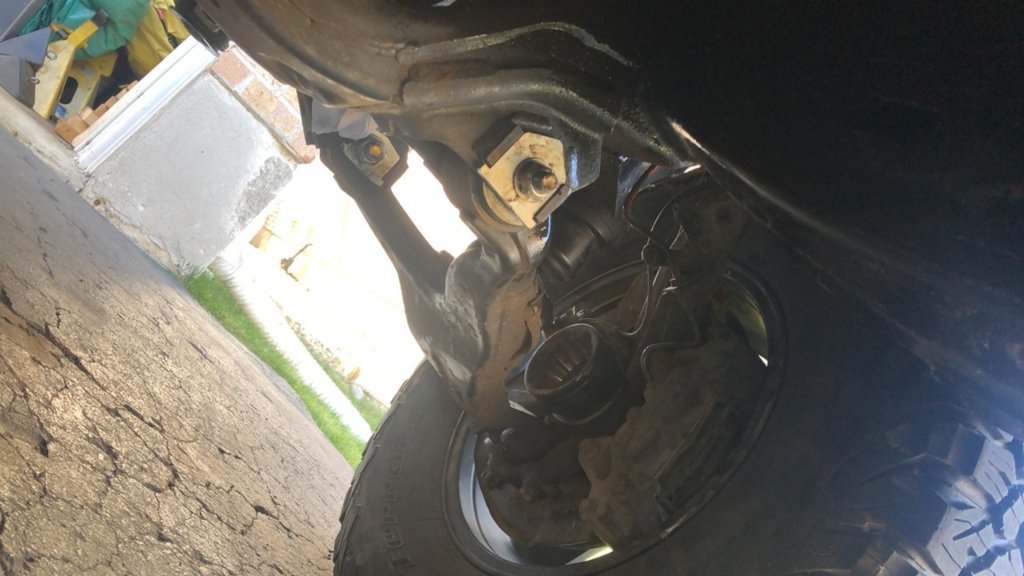

    Like how much you shaved them down. I keep some in my truck for the same reason but I didn’t think to shave them down, saving weight and ultimately space is always a good thing.
    drove around like this for a while when my front diff was being rebuilt. Works
