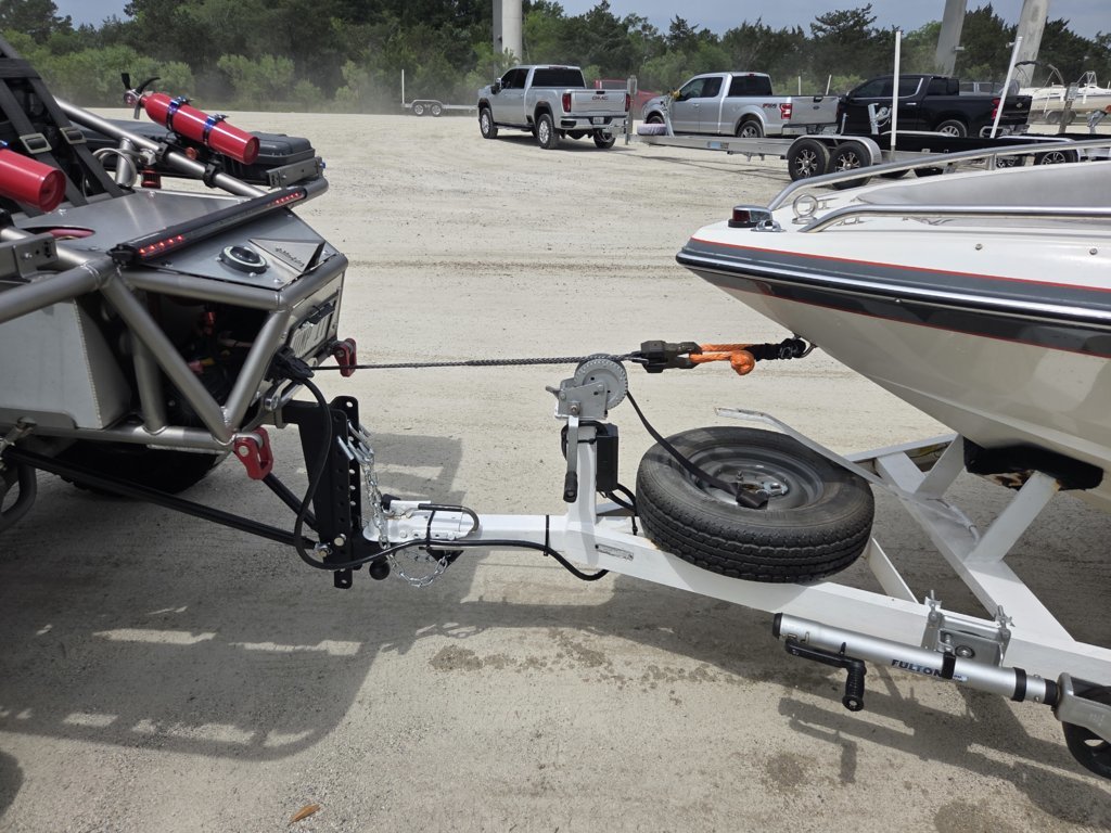

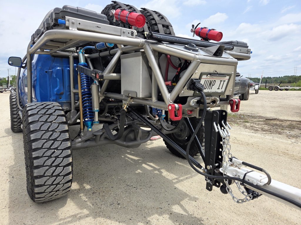

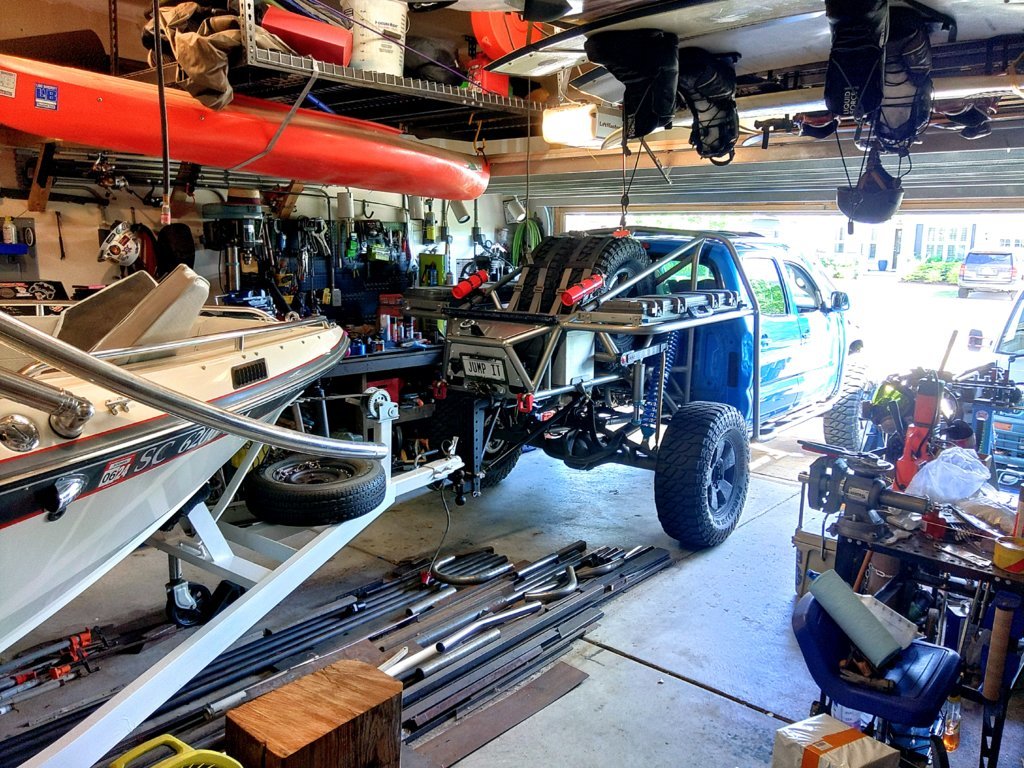

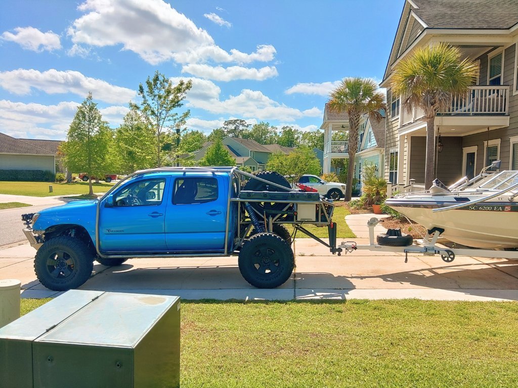

    got the boat out for some spring leaning. first time towing it with the new setup. The hitch works great. 16'' of drop is the perfect height. the roll center of the truck is actually higher than the hitch ball, so with a trailer on the back, the truck stays flatter in corners than without it. It's a double axle trailer which means a lighter tongue weight, but i was still surprised at the minimal suspension sag when i put the boat on.
    Unexpected benefit is that with a near stock ride height, and the cage being lower profile than my old roof and bed racks, my truck fits in the garage! no longer have to push the boat back the last few feet, and now i can work on one end of the truck at a time if it's raining. it's the little things sometimes :)
    sound clip of the boat's V8 :rocket:
    https://www.youtube.com/watch?v=xsncj0v3Z8s

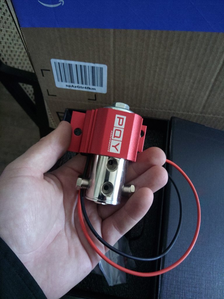

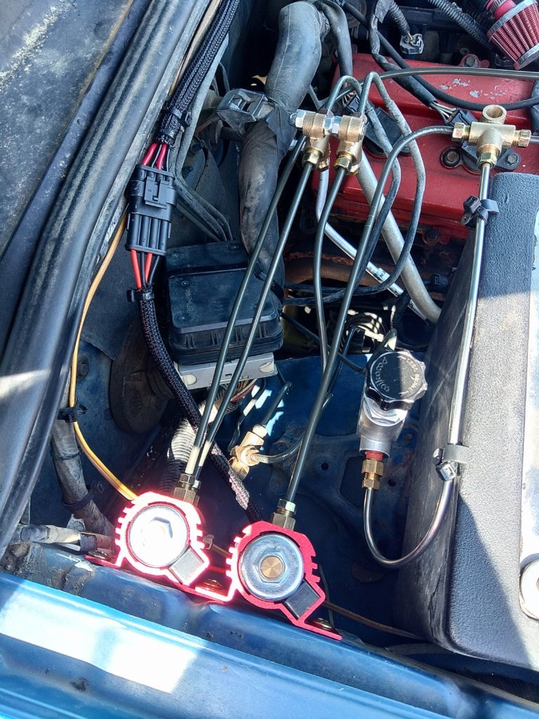

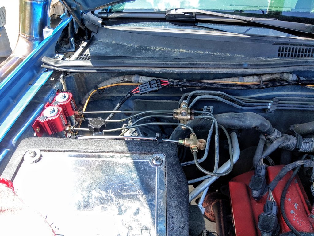

    been working on creating something new with the brakes.
    -removed the ABS module completely.
    -added a willwood adjustable proportioning valve on the rear brakes.
    -installed line locks on each of the rear brakes.
    Line locks are used primarily in drag racing, to lock up the front brakes only for burnouts. However, while not specifically designed for it, they have played a part in custom off road braking systems for a long time. the line locks serve two purposes for me. the way i had to route the factory parking brake cables required a pretty tight turn for one of them, making the parking brake unbalanced and therefore a little stiff to both engage and release. I really only ever use the parking brake at the boat ramp, and when I need get out of the truck when it's in a precarious spot off road. in both scenarios, the truck is left running, so electronically actuated line locks should be a good solution. the other benefit is that now when I'm off road, I can lock up the just the inside rear tire for tighter "dig" turns.

    Any electronics causing problems? Been following the discussion in the long travel thread. Curious how you are going about it.

    With the ABS unit removal?
    If you pull the unit completely, as in unplug it, you won't have speed, and your odometer will stop racking up miles. 4 small screws and the computer art of the ABS unit separates from the mechanical portion. So I just plugged the computer part back in and secured it under the hood. Now everything works like it should, but I don't have ABD to worry about. And of course I had all the room in the world to add all this new valving and hard line
    BradyT88 and tacoma16[QUOTED] like this.

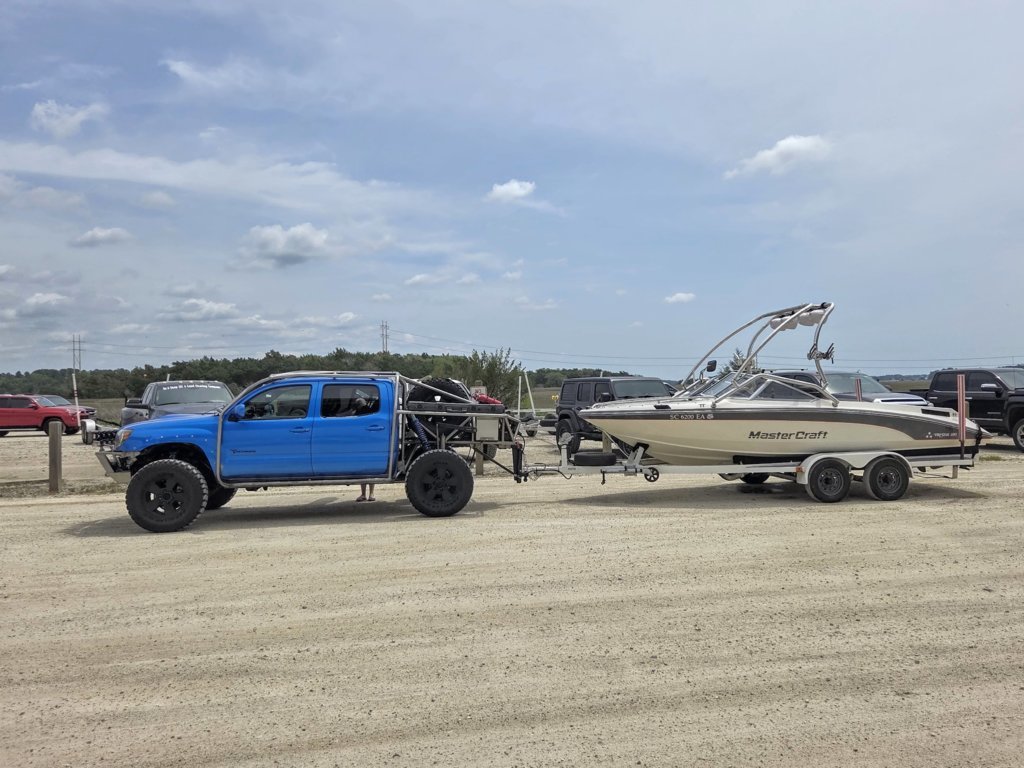

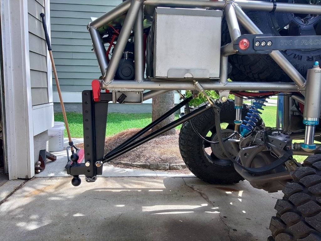

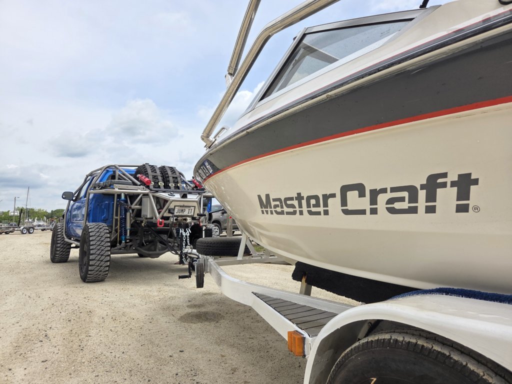

    Pulled the boat again. worked great. i was convinced i was going to have to put some removable air shocks on the back to handle the tongue weight, but i can deal with this amount of sag. it'll actually be less than this since i need put another couple of turns on the coilovers for break-in settling. the Bulletproof drop hitch is a great match. until i adjust the coilovers from the settling, i actually had to pop the hitch up to the 14 inch drop setting from the 16 inch full drop. really pleased with the hitch overall. worst part is removing and installing the 60 lb chunk of steel.
    also found a cool new trick. my trailer has an extra safety bar on the front attachment that requires the boat to be perfectly positioned on the trailer to work. instead of trying to screw with it on the ramp, i just get the boat loaded close enough, and give it a little tug forward with the rear winch once we're out of the way
    family loves having the tow vehicle back up and running after missing out on a season of boating last year with the truck still cut in half.

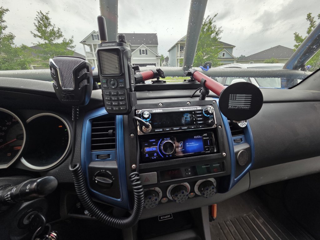

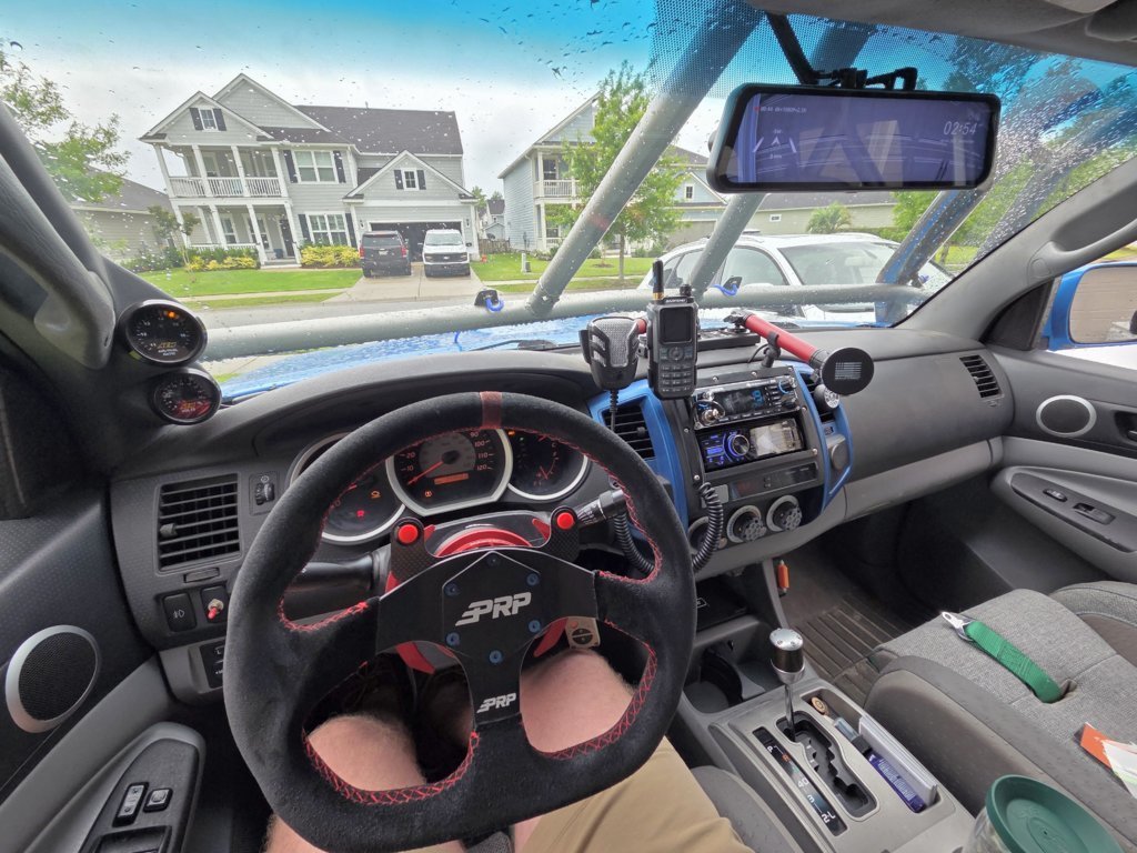

  16. Jun 4, 2025 at 8:17 PM
    #5436
    colinb17
    colinb17 [OP] If at first you don't succeed, don't try skydiving
    Jan 6, 2008
    #4127
    20,255
    Colin
    Charleston, SC
    '07 TRD Sport 4x4
    Build thread in sig... 4-link long travel
    Found some time to finish up some lingering center console/dash things.
    Swapped out the head unit. Bluetooth went out on the 10 year old Panasonic.
    While the radio was out, i hard wired in USB-C fast charger that hides inside the dash. It powers the wireless charging pad in front of the cup holders, as well as the mag-safe wireless charging mount on the bulletpoint arm. Really likjng having essentially nonexposed xharging cables.
    The bulletpoint charger on the arm is pretty neat. Has a temperature sensitive fan on the backside that kicks on when needed. It does add a little weight to the already long arm, so secured the 3D printed arm support. The arm and mounting are plenty strong, it's the plastic dashboard that flexes.
    Also installed the 3D printed radio bezel that trims out the gap around the head unit and CB that I've had on my workbench for a long time.
    After a few months with the bulletpoint mounting system, im truly thrilled with it. Great products and great company/customer service.
    If I didn't already have ram mounts in the kie truck and non the bost, I'd absolutely have bulletpoint stuff.

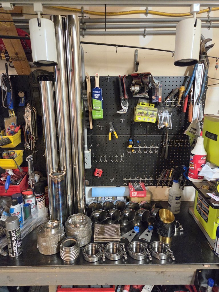

  17. Jun 8, 2025 at 11:11 AM
    #5437
    colinb17
    Jan 6, 2008
    #4127
    20,255
    Colin
    Charleston, SC
    '07 TRD Sport 4x4
    Going to try and finish my exhaust this coming week. Currently juat dumpint it under the truck. So loud...
    Need this done so I can do the skid plates.
    Going to be a pain routing 3" pipe the whole way, but this is the end result im hoping for.
    Chopping the tabs off thing and welding a v-band to it.
    BabyBilly and tacoma16 like this.

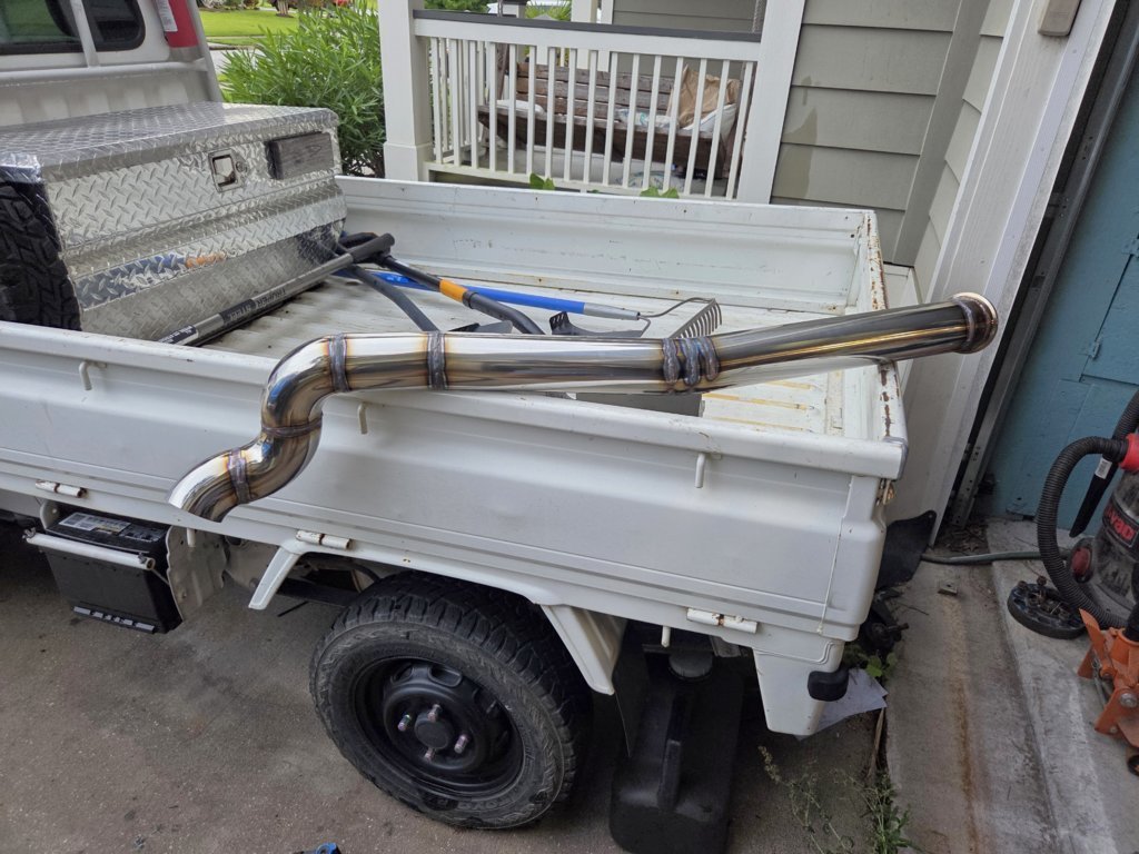

  18. Jun 8, 2025 at 6:04 PM
    #5438

  19. Jun 9, 2025 at 5:22 PM
    #5439
    colinb17
    Jan 6, 2008
    #4127
    20,255
    Colin
    Charleston, SC
    '07 TRD Sport 4x4
    Thin stainless definitely isn't my forté. Overcooked the welds a bit. Fitment is super tight. I definitely didn't design the suspension and cage with a 3" exhaust in mind. About halfway done at this point. Fortunately I'm about 3 welds away from being clear of the tight fitting areas.
