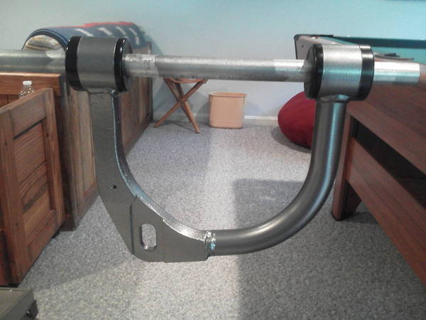

    alright, pictures......
    for anyone doing this, be prepared for that gold top nut on the balljoint (the 1.25 inch nut) to be tight as hell. i hadn't loosened mine in 2 years. took a pipe on a pipe on a 3 ft breaker bar to undo it.
    waiting for the new paint to dry after i took out the old bushings and pressed in the new ones.
    new bushings, new ball joints, and fresh paint. pretty much new arms.
    closeup to show the new boot and new bushing design
    Back on the truck, sitting and ride height.

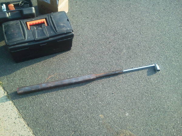

    I've been telling people this for 2 years, but never taken a picture to prove it.......here is the proof that LR UCAs will work fine with extended travel coilovers. far from maxing out the balljoint. the coilover is still the limiting factor for drop.

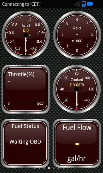

    Got a cool new toy for the truck. Bluetooth OBD2 sending unit.
    takes all of the information the OBD2 port provides and sends it to your smartphone (via the "torque" app).
    so pretty much a scanguge, but a hell of a lot cheaper, easier to use, easier to read, easier to personalize, and displays more data at once.
    the unit was $17 with free shipping off of Amazon (prime), and the app was about $5. there is a free verson of the app, but hell, for $5, why not get the extra features.
    just like on the "desktop" of smartphones, there are 7 pages to scroll through, each of which is customizable with any combination of informational displays.
    here is my main screen so far

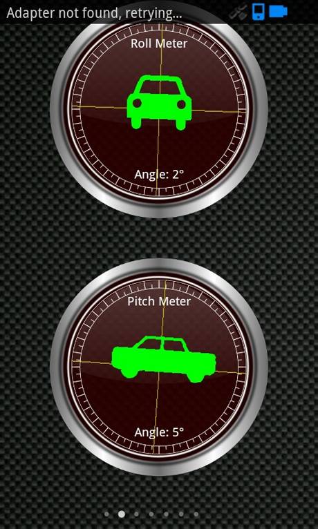

    and this is one page over.....should help with the off camber pucker moments while wheeling. i'm curious to see a hard number for the timming threashold for out trucks. i'm guessing about 35 degrees off camber....we'll see next weekend.
    there are a TON of other things you can monitor. I have been getting a check engine light on and off in my truck relating to an o2 sensor and cat efficiency. it likes to go on and off when i'm bouncing around wheeling, so i'm pretty sure it's just a loose sensor, however, just to check in on them, i have another screen showing all 4 cat temperature sensors.
    so far i love this thing and can't wait to really use it. there are a ton of other features other than engine monitoring, but i have yet to really experiment with those.
    so my recomendation is that if you have a smartphone, less than $25 gets you a better and more versitile product than the scangauge and ultragauge (i've played around with both before)
