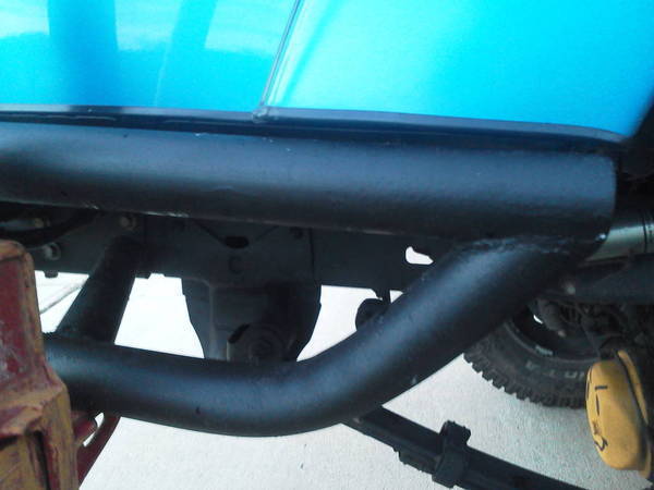

    tested out hi-lifting from the bumper wings today.

    Looks solid to me!

    biggest concern was that i didn't leave enough room for it to flex and it would hit the body/flare. fortunately, under a static load, it flexes up less than 1/8''. obvously a dynamic load (hit something while wheeling) will flrx it more, but i'm happy with what i saw so far
