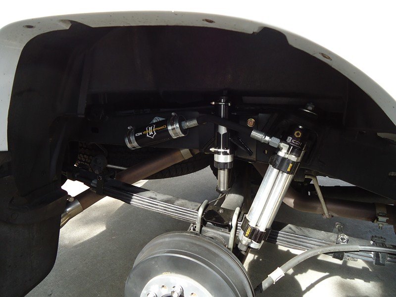

  9. Oct 11, 2012 at 7:35 PM

    i hadn't seen that picture yet. wyatt did post this on RST though
    very interesting. price will probably determine weather i go with those vs some foxs with weld on cans.

    What rears are those? Wonder if they're any longer than all the other oem replacements.

    those are their stock replacement bypasses. they've beentesting them like crazy on their 4-runner. this is the first time i've seen them on the tacoma. they're probably the same length as any other aftermarket extended travel rear. shock. with stock shock mounts, you can get more drop out of the factory leaf pack and shackle, but the shock body will get in the way of up travel with too long of a shock, so you're fairly limited with how long you can make the shock for stock mounts.
