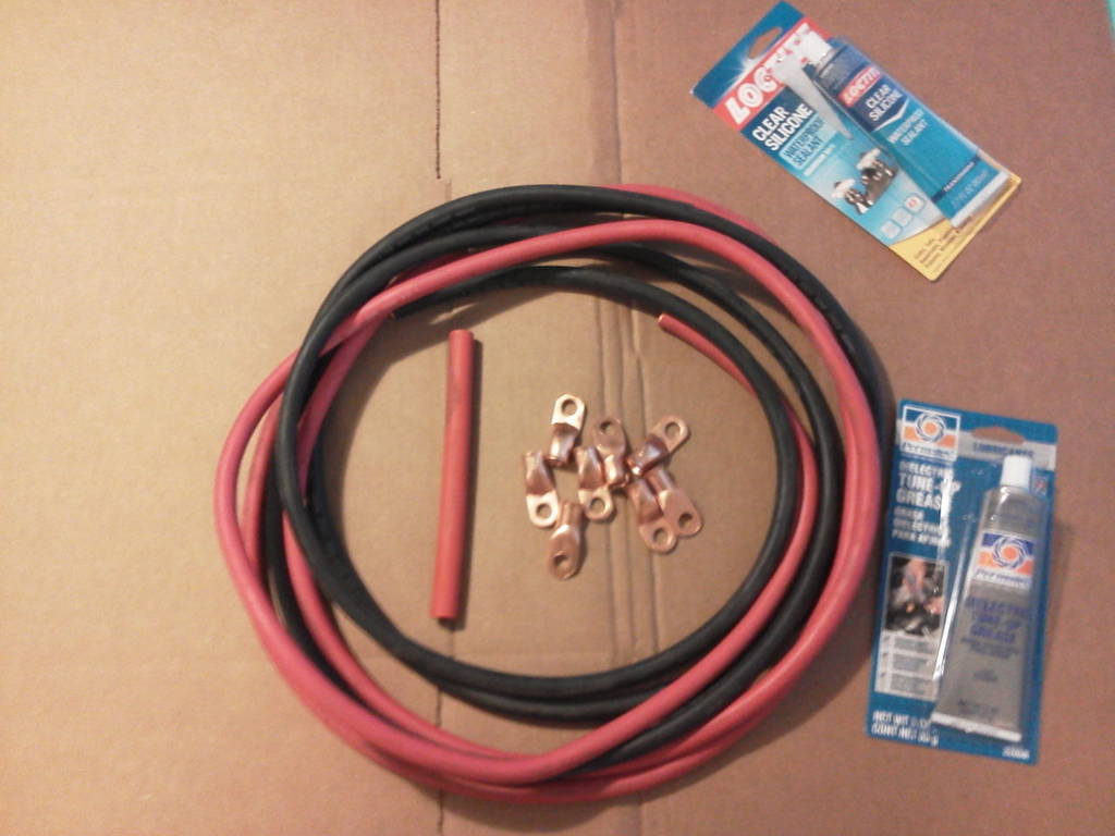

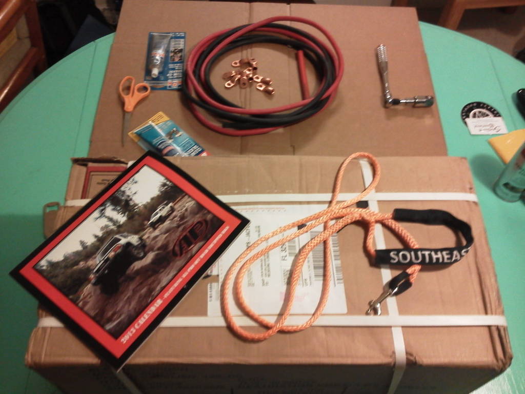

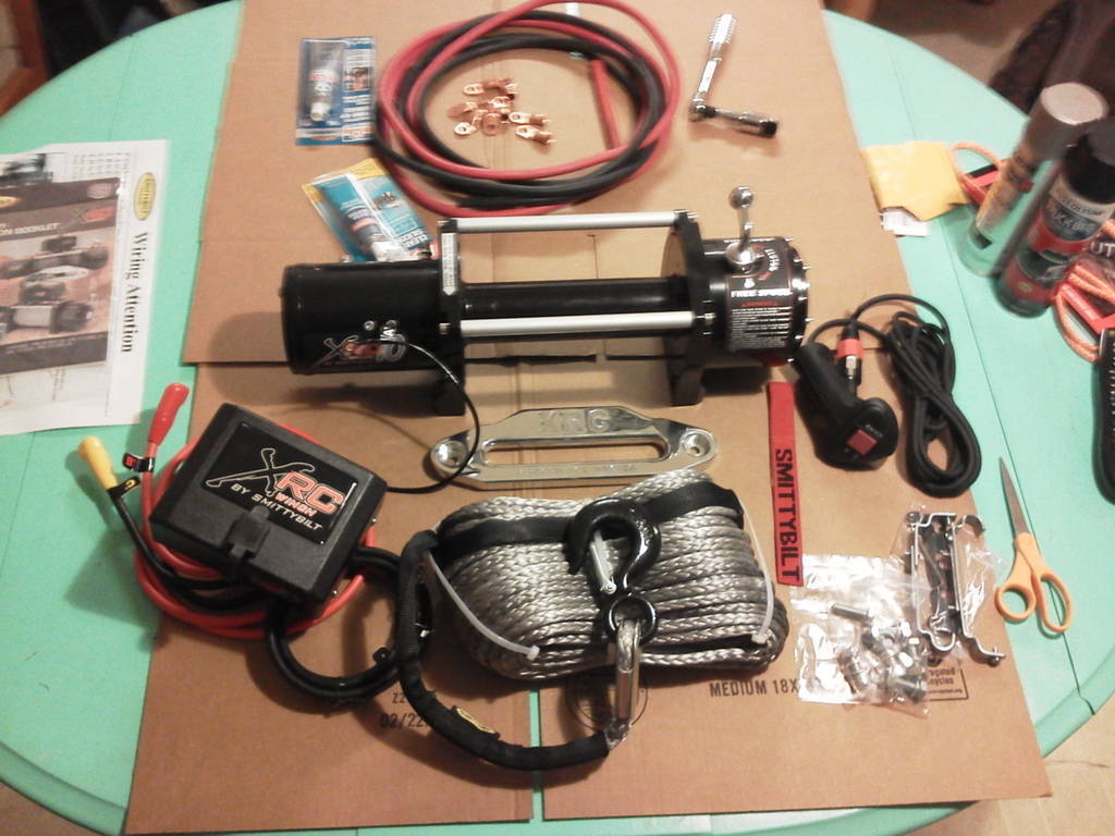

    Winch came in today! went out this afternoon and got silicone and grease to seal up the solenoid. gonna seal it up tonight and installt he winch tomorrow. Alsogot some 1ga cable to power the winch. the winch comes with 4ga cable, and not a lot. If i've learned anything over the years, it's never skimp on wiring ANYTHING. got the heavy duty cable with a thicker shield, in hopes that i never have to mess with the wiring again.

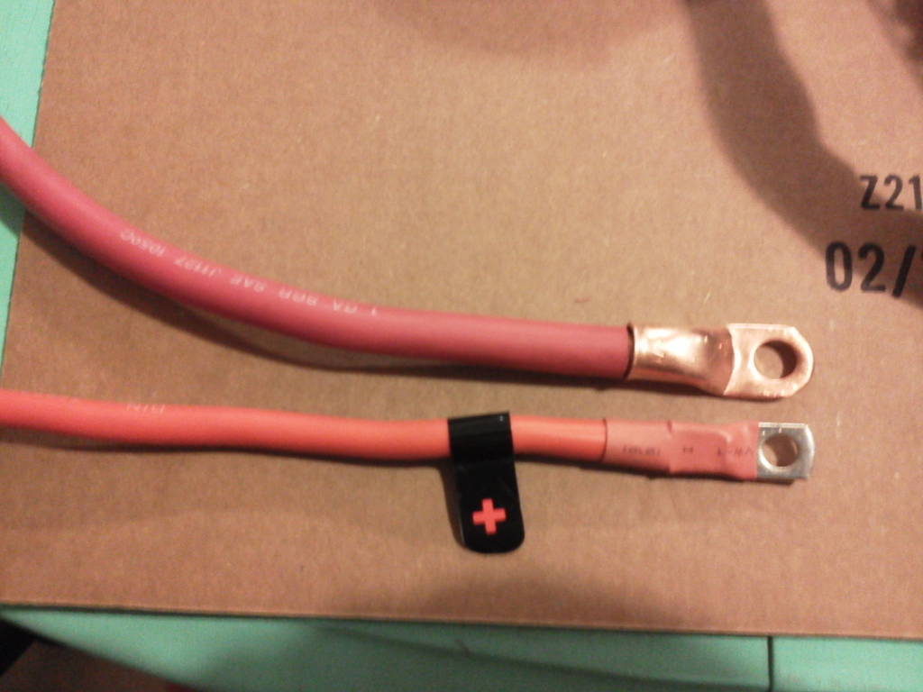

    good cable comes at a price though. about $100 in this picture :(
    Also made the All-Pro callendar again this year. honorable mentions this time, with Mr. hard2kill! we're going 2 for 2 buddy!
    Tomorrow's project
    and the difference in the smittybilt cable vs the stuff you get at a welding shop. other than the size, the better cable also has more, smaller strands of wire in it instead of fewer large strands. you can see the effects of this by looking at the kinks in the smittybilt cable. the nicer cable just curves smothely, without holding kinks.
