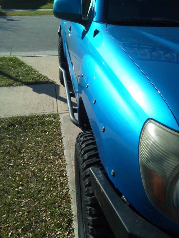

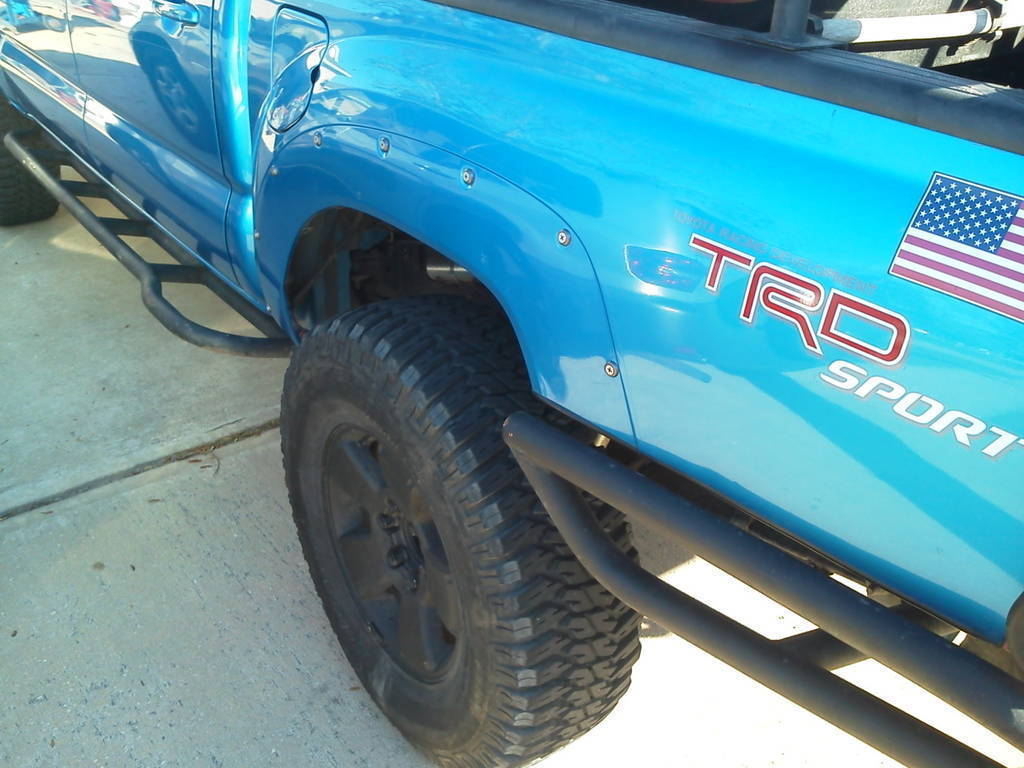

    some pictures of the painted recess washers and stainless hardware.
    doesn't look fantastic, but i like it better than the empty holes.

    Colin that turned out pretty good. I might have to do that.

    Thanks, Coby. only costs about $25, including paint, and that's because it's all 1/4'' stainless hardware.

    Looks good. It was painful to watch and hear you destroy your fenders :(

    the flares are fine. just popped a couple more of those little plastic clips

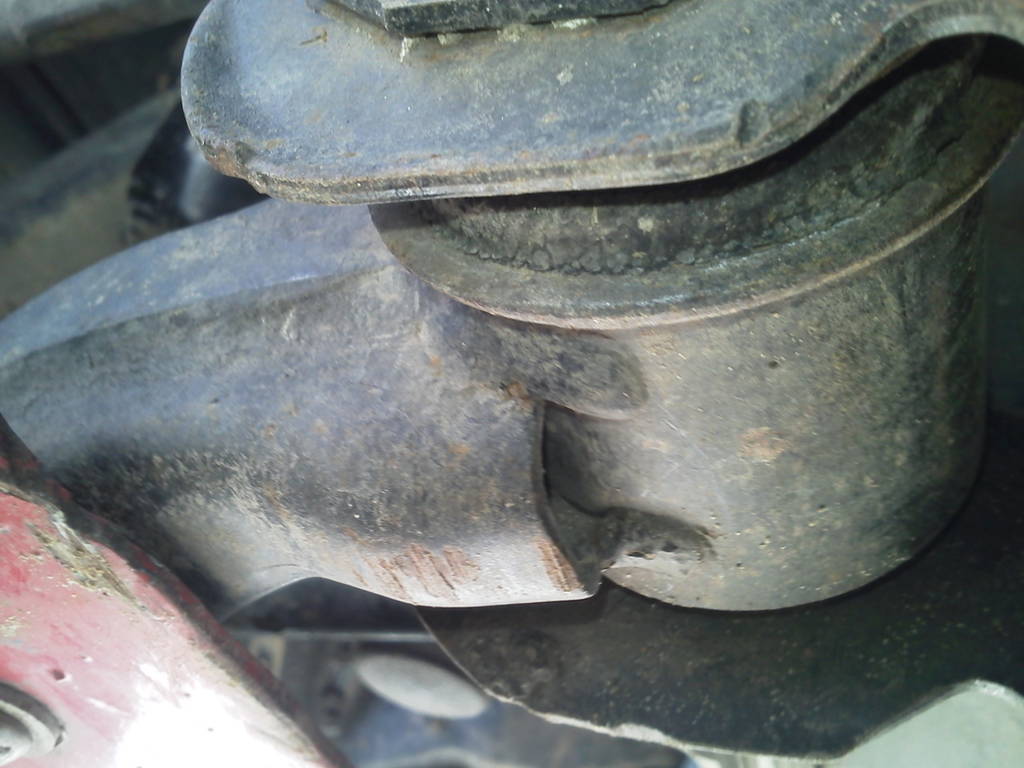

    on another note, i was crawling around under the truck, doing one of my routine post-wheeling inspections, to make sure everything was in order. looks like i have the very very early stages of a crack forming in the weld or one of my LCAs. going to toss a fresh weld on it in the next few days to prevent any further issues.

    just looks like a chip in the paint, but you can tell it's the start of a crack if you look at the inside of the weld. i couldn't get a good picture of that though.
