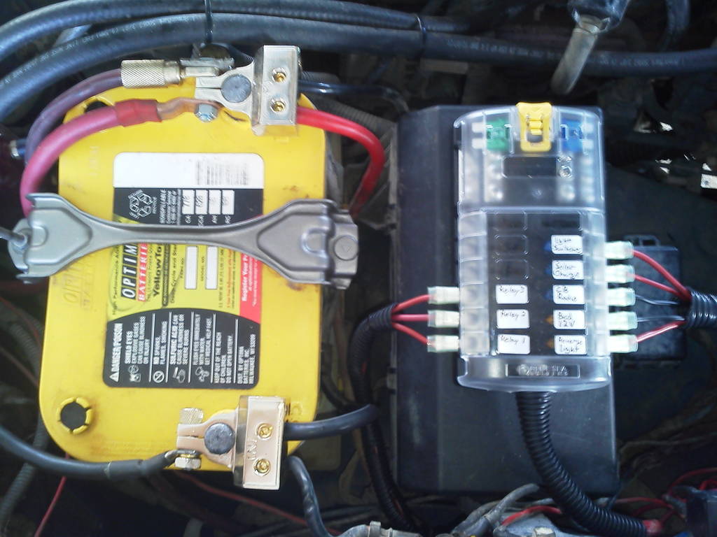

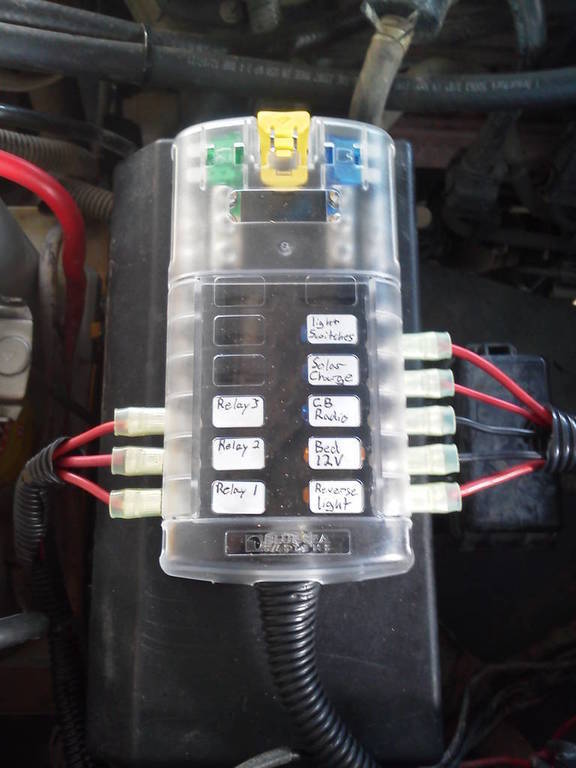

    Had a beautiful day to spend working on the truck.
    finally took care of the rat's nest of wires and home built aux fuse box i had rigged up. Went with the 12 port blue sea box with the ground buss.
    while I was at it, i slapped on some tsunami battery clamps to organize the heavier gauge wires i have going directly to the battery (winch, amp, power to fuse box).
    should be all set to work on the trail/rock cameras come wednesday/thursday.

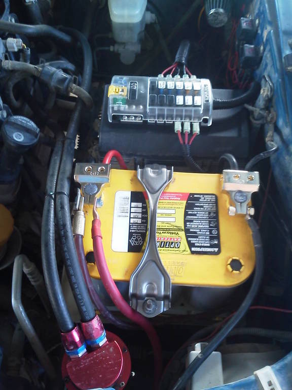

    i've always been able to make electronics work, but until more recently, didn't really pay much attention to neatness and organization.
    this picture is from 20011, since then, more relays and some other wires have been added.
    you can see that i just slammed everything onto the factory positive clamp, and spliced two 8 port piece of junk fuse banks together. real crappy exposed little things. when this picture was taken, i had at least 3 fewer lights, so it got even messier. something needed to be done.

    What's that filter for on the right? Oh, and if I give you $10 and a beer will you clean up my wire job?

    the filter is my rear diff breather. i didn't like the gas filler area, because it gets wet and filthy all of the time. where i have it under the hood never gets wet, and usually only get dust. never direct mud spray like other areas of the truck/under the hood. also wanted to run a filter to it, instead of the factory style breather, that to my knowledge, has no filter element in it.

    the front diff and transmission breathers are under the hood from the factory. in the picture of what my wiring used to be like you can see them. they are the two small circled just to the right of the open fuse box.
