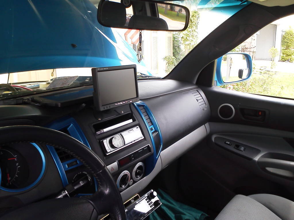

    got the monitor mounted and wired, selector mounted, and one camera mounted/hooked up.

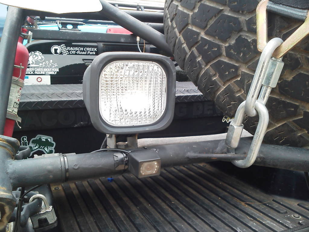

    just mounted the first camera as a standard backup. they pivot, so i'll angle it down at the ground when i wheel to see what i'm backing over. the 2nd and third cameras will go under the truck to compliment a spotter, or make it easier when one is not available

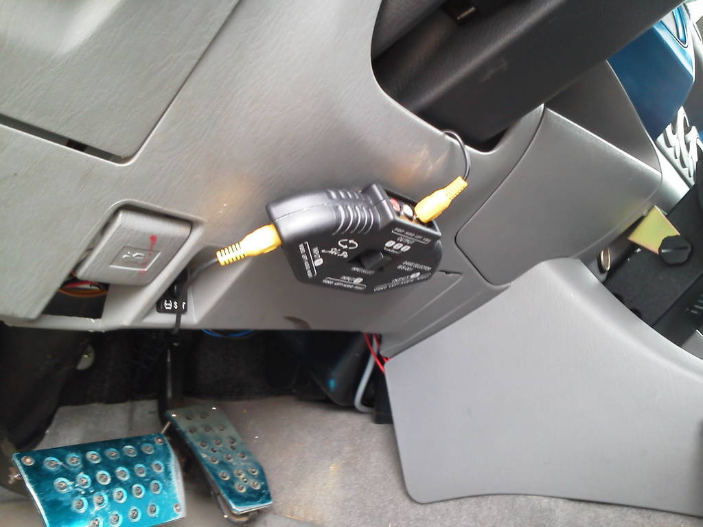

    selector hooked up to the first camera, tucked up out of the way.
    monitor mounted. it pivots on three axes, so it's nice and easy to aim in any direction. got a plug in the storage bin above the head unit so i can quickly take off the monitor and store it when i'm parked in the city or an otherwise shady area.

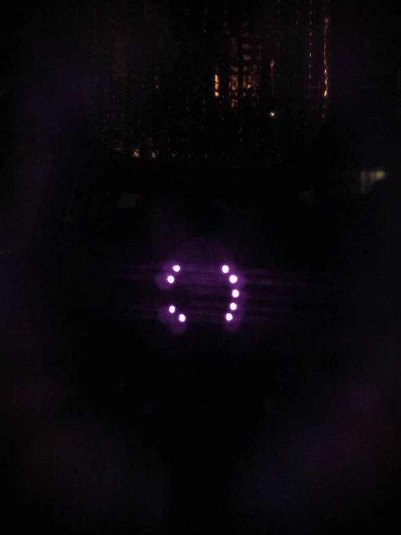

    camera #1 mounted. it has a photocell that turns on the infrared LEDs below a certain light level for "night vision". Works well, but only to about 4-5 feet. so that's why it's under my reverse light. with the reverse light on, it's clear for 40+ feet.
    the lights only put out a faint red glow, but a digital camera will pick up the full spectrum of the IR LEDs.
    it looks like there is one LED missing from the halo, but that's just where the photocell is located.
