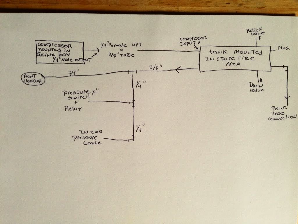

    yooo
    does this look good?
    for in viar 450c with tank...

    Oh man, I love your drawings :D
    How ya been man? haven't heard from you in a while.
    What are you looking to do with your air system? As far as everything being hooked up properly, you're good to go, and seem to have covered all of your bases.
    I ask what it's for though because of the tank. the majority of the time, a tank in an OBA system is useless. If you're going to use it to fill tires or power air tools, you'd need an absolutely giant tank. even the larger 7 gallon tank that viar sells won't do you much good. when at full pressure, even a tank of that size will be equalized with the pressure in your tires in a matter of seconds. therefore, even with all of that air in there at a relatively high pressure, your compressor is still doing 100% of the work to fill your tires, a mere 20 seconds after you start.
    The only real reason for a tank on an OBA system is if you are powering air lockers, and don't want to hear that couple seconds of the compressor buzzing every time you turn the lockers on, or having te ability to briefly blow things off with an air nozzle.
    the size range of tanks you see viar selling are ideal for a truck/train horn sized air consumption, but i don't imagine that's why you're adding the system.......right? :p
    So, bottom line, if you are using the compressor to fill tires, the setup will be just as effective without the tank. for lockers, you see the benefit with the compressor not having to fire off fora couple seconds each time you activate a locker.
    short of a belt driven compressor, CO2 is really the ultimate. Some of the non-toyota/tacoma guys i wheel with from VA/MD who use CO2 wheel every few weeks. they fill their tires, sometimes other peoples tires, run air tools when needed, and power their lokers from a single 20 lb CO2 tank strapped in the back, and only fill it every year or longer.
    but in the end, 100% your call. your drawing is correct, so if that's what you want, i'll be looking for install pictures :thumbsup:

    dam you must be on a computer to type all that
    yea just oba..i got a great deal on a whole setup
    the tank will be more for my scepter pressurized air splashdown system....
    and i never even thought of an air horn
    thanks my neighbors will love you.......
