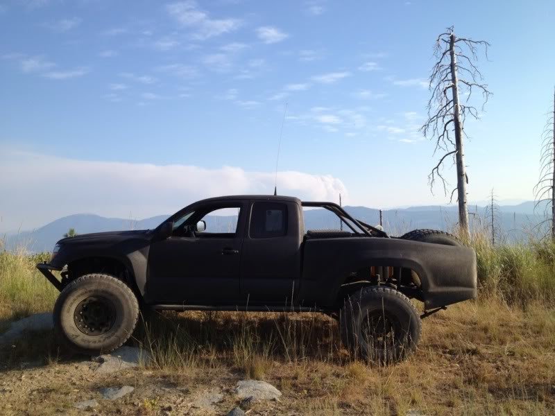

    I wanted to do that as well, but everybody I have talked to so far said that the leaf springs actually move towards the front of the bed as they compress which is why leaning them forward is more favorable to backwards. Mine will likely still be angled slightly backwards but I am going to shoot for as close to straight up and down and as possible.
    My problem with ground clearance a good line can't just fix... but I am trying to keep up with guys like this around here:
    Yes those are 40's...
    The Commanche is on 37's
    Lots of lift and 35's
    I think those are 40's or 42's...
    That's not even all the rigs, but you get the idea... When I go out, I am almost always the only guy that is IFS up front... and I have the longest wheelbase too and usually the smallest tires... All of that combines to result in me having a hell of a time trying to keep up. haha My saving grace is that I am one of the few locked up front and sometimes my longer wheelbase allows me to take more interesting lines. There's a reason why I have killed 2 rear driveshafts now though and there isn't a spot under my taco that isn't scratched... but I got a little talkative about me there...
    Anyway... I know what you mean about the center of gravity thing and I just hope to fix it with LT up front and trying to get to about 90" wide up front. Username (I'm sure you've seen his truck before) is about 91" wide up front and he said he can pitch his truck sideways on pavement at about 60 mph without lifting a tire:eek:
