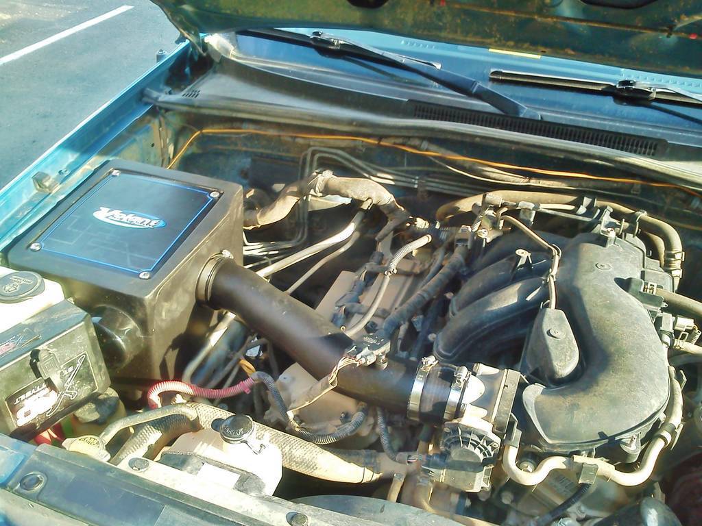

    Snorkel shipped today, and the Volant intake arrived today. so today started the snorkel process. tossed the intake in. real easy, only abotu a 15 minute job to remove my home made one and install the new one.
    first impression is that it's a quality kit with a nice fit and finish.
    still plenty of room under the hood, which was the goal of figuring out how to hook up the snorkel to one of these instead of a stock intake.

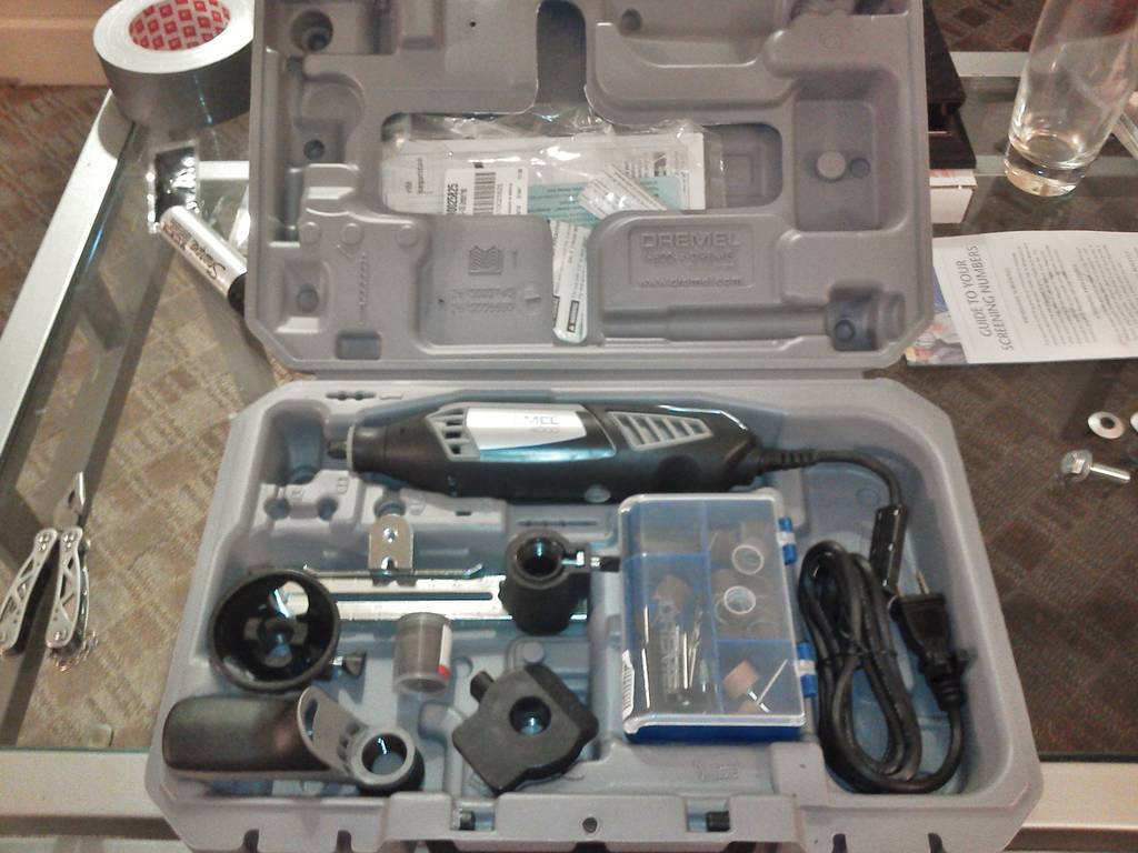

    been wanting a nice dremel for a while now, so i figured cutting up my fender was the perfect opportunity. last time i installed a snorkel, the dremel turned out to be the perfect tool for the job. opted for the 4000, which was the most powerful one home depot had in stock. I really liked it because of all of the attachments too. circle cutting attachment/jig may come in handy for this.

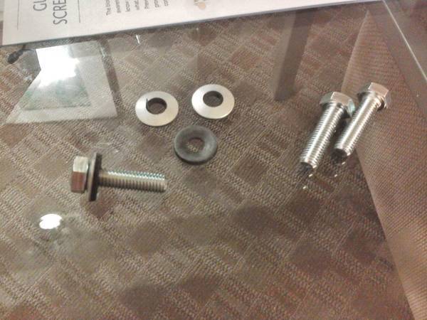

    taking as many precautions as i can to keep this whole thing water and dust tight. come snorkel install, i will replace the hardware the hold the filter box in place with these steel washer/rubber seal combo. additionally, they will be globbed up with a heavy duty marine grade sealant.
    also ordered a 4''-3.5'' polyurethane reducer, which will hopefully allow my to connect the snorkel to the filter box without having to perform any modification to it. all connections will be sealed up with the same marine sealant.

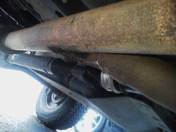

    it also turns out that the last two wheeling trips have put a beating on my exhaust, specifically the y-pipe. first dent is sizable, but not something i would worry about if it were the only issue
    unfortunately it gets worst. took a real big hit right at where the Y-joint is. it was hard to get a good picture with the lighting, but the pipe has been crushed to about half of the size. additionally, it partially broke the pipes apart at the weld. so now i know why my exhaust has sounded so crappy for the last two weeks.
    Guess the long tube headers and urd y-pipe just moved up tot the top of the list.

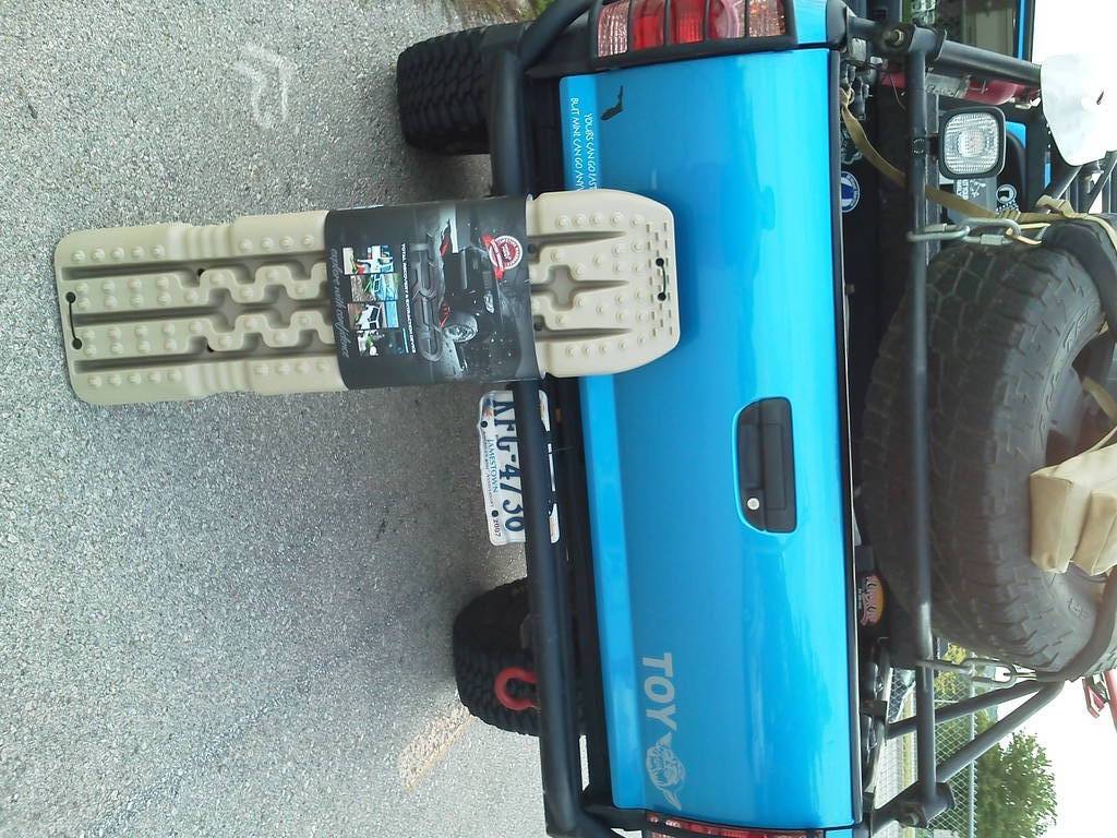

    Figured out what will be at least a temporary mount for the TJM treds. picked up some of those auto-spooling ratchet straps. holds the treds securely, anddoesn't leave any loose ends to flap in the wind. when they aren't stacked on one another, they actually sit very low profile. at 5'9'', i can barely see them behind the lights when i stand in front of the truck.
    also grabbed a little neoprene center console cover from a member on here who makes them and some other interior accessories
