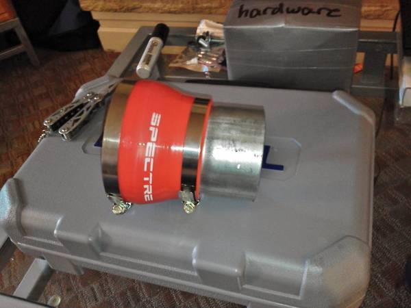

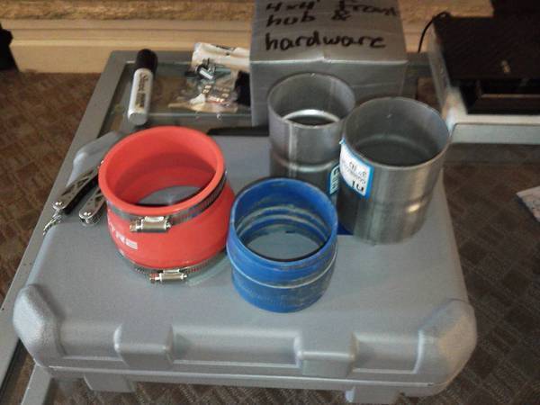

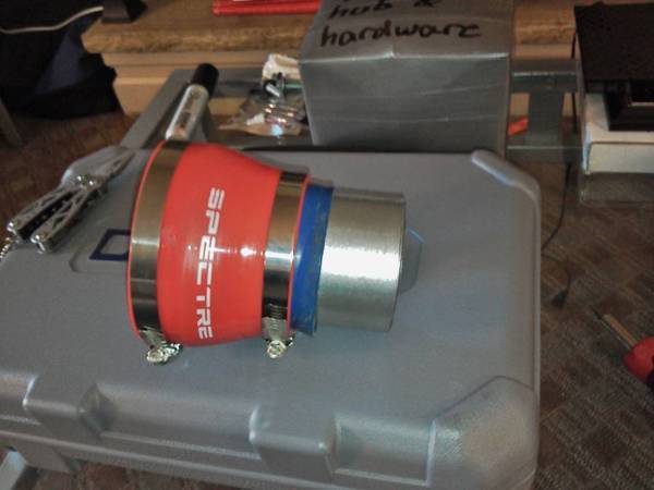

    So at the risk of completely jinxing myself, i think i've found a foolproof way to hook the snorkel to the Volant air box.
    Ordered a 4'' to 3.5'' reducer online that came in today (the red one). pulled a straight 3'' to 3'' connection from my old intake, and then picked up a piece of 3'' pipe, and a piece of 3.5'' pipe. I'm fairly sure the 4'' side of the red reducer will clamp directly onto the filter box. Then (in theory), all i have to do is pick the piece of pipe that the black 90 degree elbow, that comes with the snorkel, fits best.
    the parts
    what it'll look like with the 3.5'' pipe
    what it'll look like with the 3'' pipe, using the blue poly sleeve as a shim
