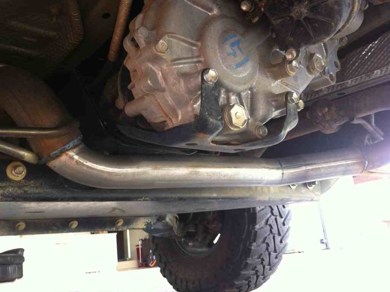

    Alright, so speaking of a challenge, i need some help fellas.
    still on this y-pipe thing, i was doing research, and realized the urd pipe routes differently than i had though, with it going under the tranny, and the high clearance skid i have there, it clears my skids fine, but damn does it hang low. i don't feel like spending $500 on some stainless pipe, just to crush it on my next wheeling trip
    for refference:
    so that leaves the pipe bomb. this one is routed in a similar fasion to my current setup, with the exception of my crossover being further back as to not cook the u-joints. i cn hear wrap for that though. my concern with the DT pipe bomb is if it will clear my transfer case skid (modified all-pro).
    for refference:
    I know it's a fairly unique combination (AP skid and pipe bomb), but does anyone have any idea if it will fit???

    here's a better picture of the pipe bomb. it's just tacked together becuse this was when they were still designing it.
    I really do think it will fit, i just want to try to confirm before ordering. this would all be so much easier if i had my welder with me :pout:
    i gues worst case scenario, i just pring the pipe bomb to a shop to have it altered a little

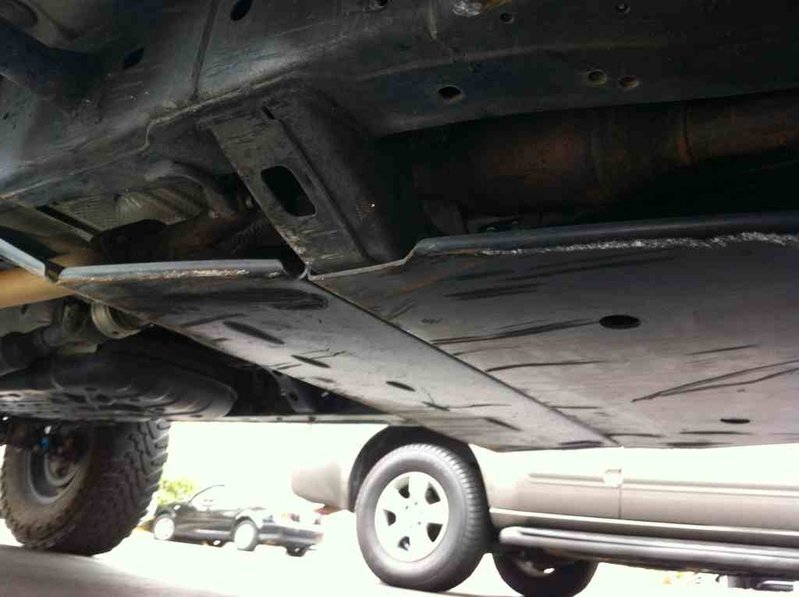

    I actually cut up my stock one in a similar fassion, but rerouted it behind the transfer case to so i could tuck my skid up higher and use a larger pipe. the reason i'm looking at a full replacement is because i recently managed to crush it in two places, even with it being tucked up in the frame rails. it now has two leaks as a result, one at the bolt-up to the passenger manifold, and another where it actually split the pipe, jsut before the y-collector.
    If i had all of my equipment here, i'd just build a whole new one, but i don't :(

    I went the route I showed you so I could fully cover the entire area and create a smooth transition from mid skid to rear skid and out

    i like that bend up at the end. My entire skid is angled up towards the rear, and has a tube frame, so getting hooked up on rocks while reversing isn't really an issue, but i feel like so many of the other fabricators out there overlook that and just have the skid going straight back, with a 90* at the rear lip. doesn't make a ton of sense when your solution really doesn't take that much extra work.

    I have the Doug thorley y pipe and a stock ATO transfercase skid will hit the coupling where the y pipe meets the section of exhaust pipe going to the muffler.
    My solution was to have Kevin (former ATO) to make mine 4" longer to get past the coupling.

    10-4, thanks! so if mine hits in the same place (different skit), it'd be real easy for my to jsut have an exhaust shop cut out the joint and move it rearward until it cleared.
