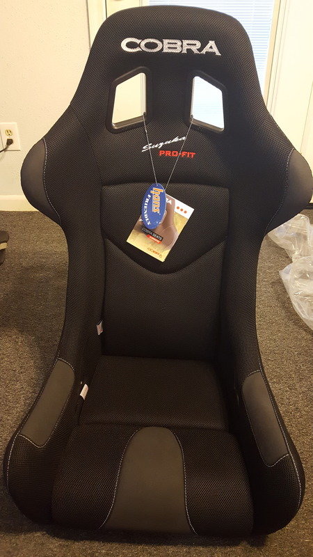

    I match your NRG bucket seat. ;)

    Sonofabitch! You haz big boy shoulder bolsters :pout:

    That's the "GT" series. Basically the wider version than the non GT. My shoulders definitely need it.

    Definitely not fiero seats then. I had to scour the depths of the interwebz to find seats narrow enough, and low enough to fit in this thing

    I'm still looking for a seat that won't break the bank and can fit a 38 waist in it. hard to come by for some reason

    The NRG seats will probably be your best bet then, Gaunt. They fit Lucario Runner's waist, and his is between 36-40.

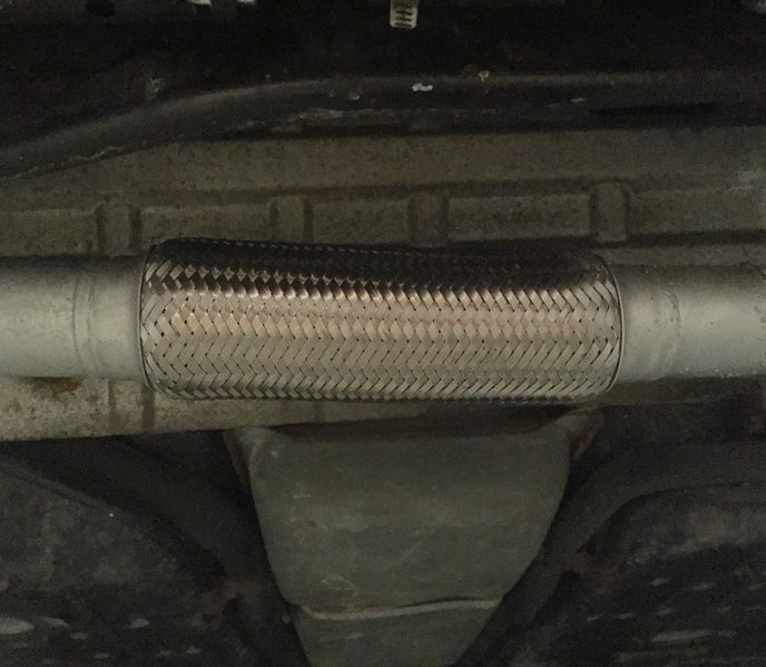

    Exhaust work is probably my least favorite thing to do, but last night was very much worth the hassle.

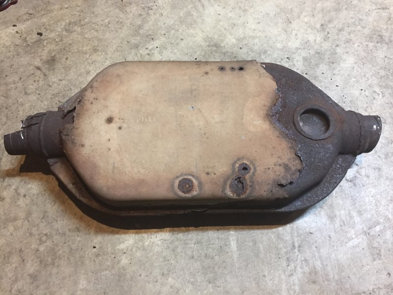

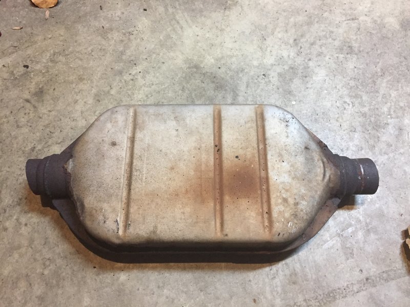

    Catalytic converter had seen far better days. Cut it out and put in my flex pipe last night.
    What a difference. Catalytic converter was a good 20+ pounds. Flex pipe is ~3. When I flipped the cat up on end, all of the catalyst material fell out. So it wasn't doing much more than restricting flow.
    Biggest change is the exhaust note. It may not be the fastest car, but it sure as shit sounds like it is now. :anonymous:
    I just have to add another hanger and it'll be all set. Without the rigid cat, the weight on the muffler side pulls down the flex pipe a little on that end.

    Oh wow. I didn't even think of the shape that cat was in. So the engine should now be putting a few more ponies to the ground now. Have you only revved it, or have you also test driven it?

    I drove it to work this morning, but my route to work at 4:30am is on low speed back roads, littered with deer that make bad decisions. My drive home in 2 hours will be on a main road, with the sun still out. I'll give it a test then. At the very least, mileage should go up a little with what I would assume is a significant reduction in back pressure.
    Speaking of mileage, I made my first full fill-up Friday. I have by no means been easy on the accelerator the last two weeks, and still spit out 33 mpg. I always thought people were bullshitting when they said they can 40+ mpg, but I'm starting to believe them. It's a far cry from the Tacoma on that front. Pretty cool to be able to go over 300 miles on 9 gallons of fuel, and have fun while doing it.
