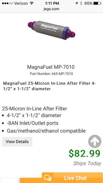

    I don't know if that's the one I have installed, I just know I can get that one. Those are good?
    Is there any drawback to going with one like this? If I go too small on the microns, do I risk overworking the fuel pump? Or is it just not worth the money on a car like this?

    If you were using very expensive injectors which required very fine filtration, then I would get the best filter you can. Yours is a much broader range, and I feel that the Mahle will do you perfectly.

    Fantastic, thank you Mark :)
