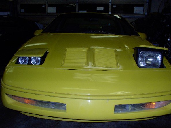

    Looks like that last one changed his lights as well.
    Guess you'll find out, the first time you get a wink. lol

    Yes, some of the guys have changed them out for recessed projectors. Obviously the light output is fantastic, but with how recessed they become, the light doesn't hit the ground until about 20 feet in front of you. Since I'm not a huge fan of always driving with your fog lights on, in going to stay away from that. What I would love to do though, is build a frame to house a flip-up projector. You can then limit how far up the light raises. And if a motor or gear box ever goes out and gives me a wink, there are a couple of reasonably priced aftermarket replacements.
    Stock vs low profile. He used a halogen, but it would looks the same as a projector.

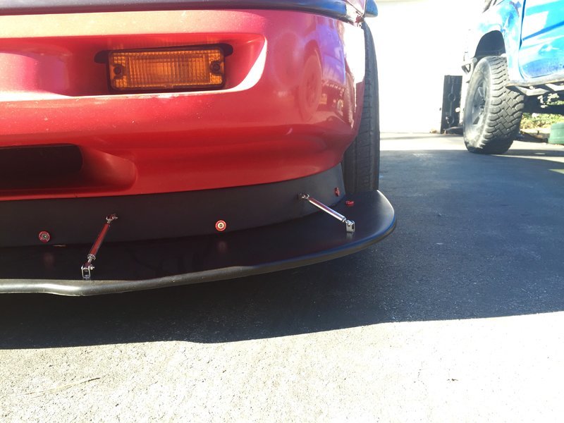

    Welded up a bumper stiffening frame that ties the lower bumper/splitter, back to the front crossmember. This should be a huge improvement to the splitters rigidity. All of the strength is now provided by the frame, and the turnbuckles are solely there to fine tune the angle of the splitter.
    I did manage to take it for a 65 mph spin out to dinner. You can hear that there is more air rushing around the sides of the car, vs under the car. This a good thing, as it the high pressure air going around the sides. The canards should be coming in tomorrow. These should keep this air flowing around the sides, doing so in a relatively laminar manner. The goal is to reduce high pressure turbulent flow.

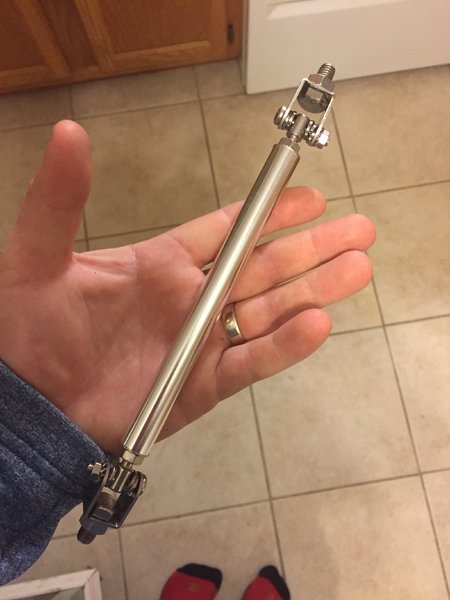

    Small turn buckle, vs the ones I actually need for the center two

    Where did you get those?

    They're just some cheapies off Amazon. Supposedly that are all stainless, with the sleeve being aluminum.

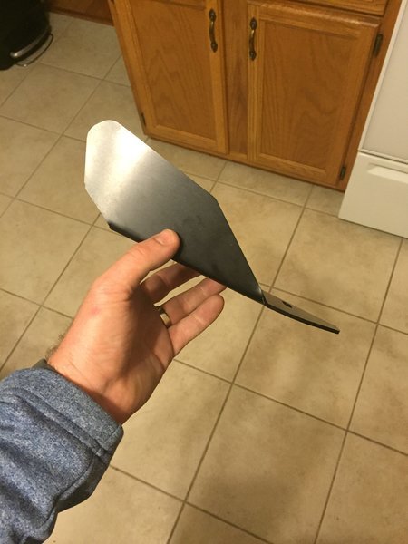

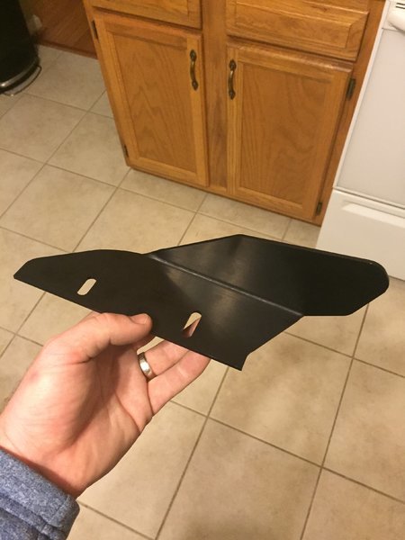

    Ooh, Canards o_O
    They'll be goin on the very outside of the splitter, right in front of the tires. Mounted to the underside of the splitter, coming up around the edge.
