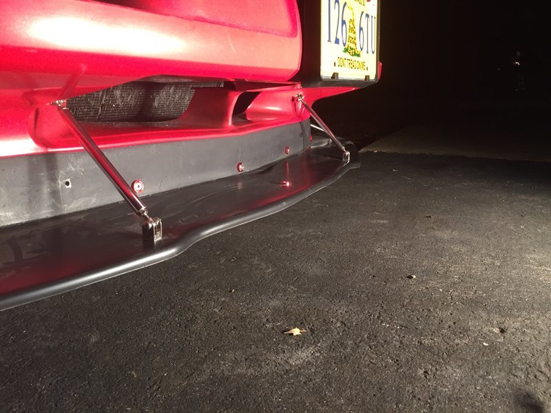

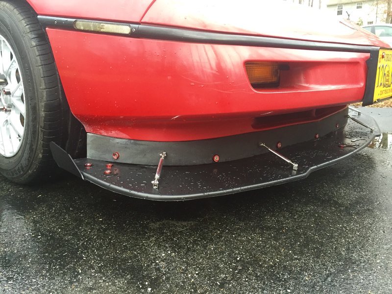

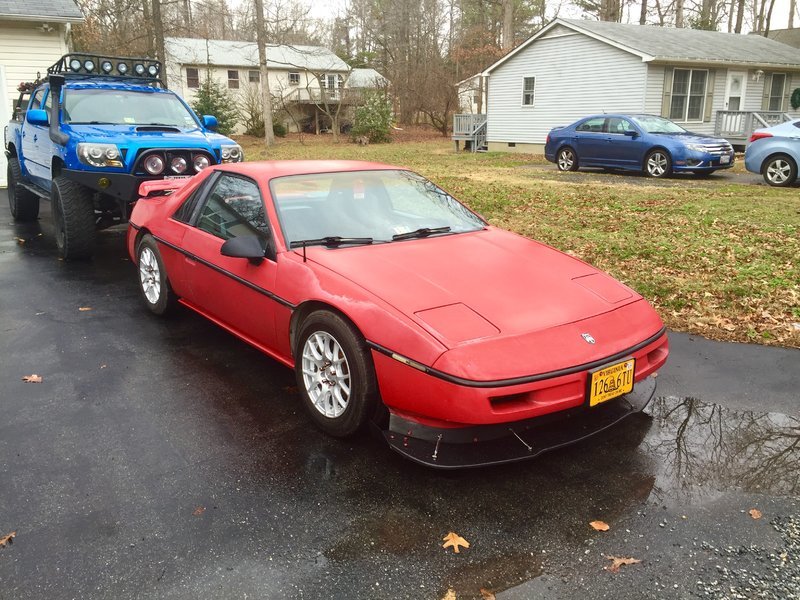

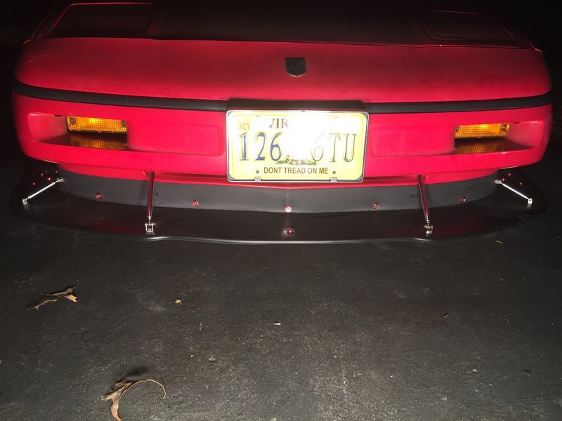

    Front end aero shenanigans complete, minus the larger turnbuckles that need to be swapped in for the center two.
    Noticeable difference at ~65mph and higher
    In the last picture you can see the two steel braces I built last week, that support the bumper and splitter from the front crossmember.

    Looks very nice. Subtle too. Has your wifey driven it yet?
    Did the headlights wink at you?

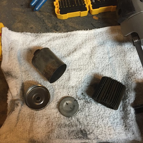

    finally had a warm non raining evening earlier in the week. go the fuel filter swapped out for the new one, and replaced the O-rings. old filter was dirty, but definitely not the stock one. couldn't have been more than 5-10 years old. no immediate differences were noticeable, but it's nice to know that at the very least, the fuel pump isn't working as hard.

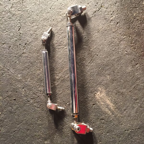

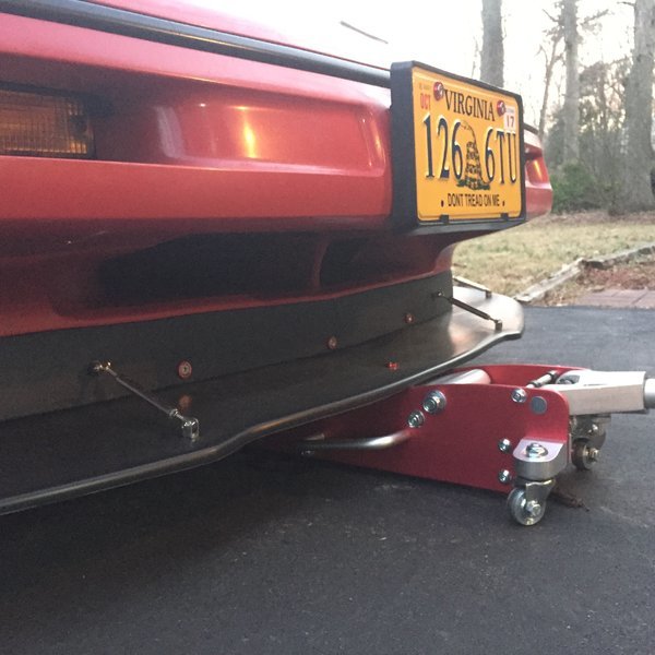

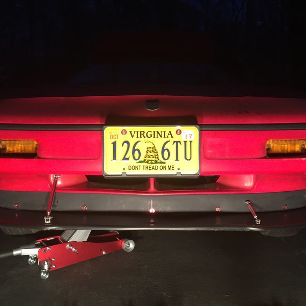

    also got the center splitter supports swapped out for the larger ones in a much stronger upper location.
    discovered the most recent first world problem.....
    uninstalled size comparison with the new, larger supports.
    new vs old
    bigger support at a much better angle.
    Done.

    That looks much better.
    That filter looks awful.

    the dark color of the filter is just because it was still saturated with gasoline. I let it sit out overnight, and it was a light tan once it dried. there was some crud built up at the bottom as you can see though. based on some of the photos I've seen on the fiero forums, this was not nearly as bad as some.

    Oh ok. That's good. Means the previous owner was a bit more attentive to its PM needs.
