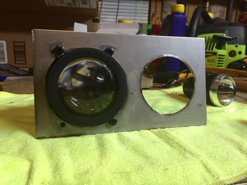

    Custom Headlights underway!

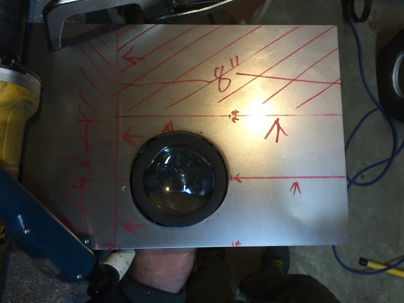

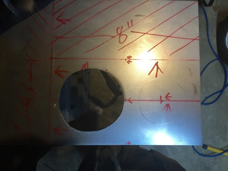

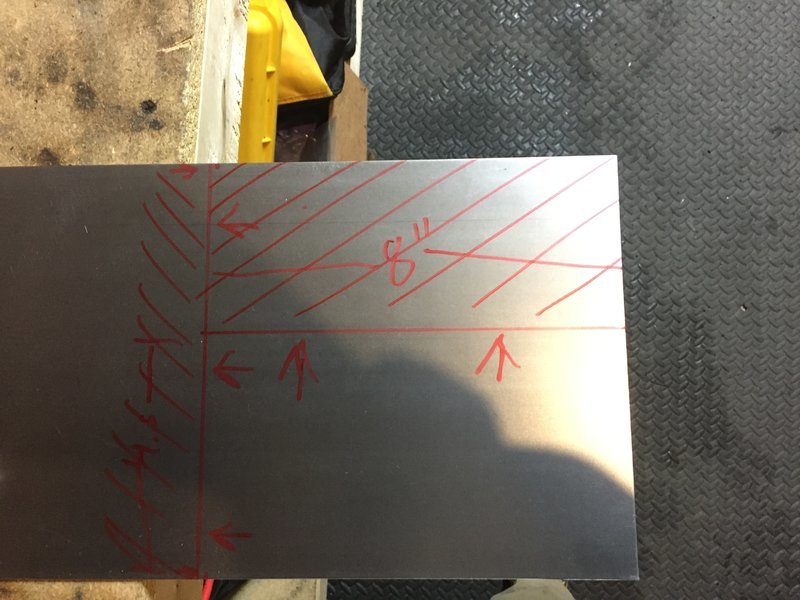

    Summary:
    -Hella 90mm projector low beams
    -off brand LED projector high beam (no beam cutoff like a DOT low beam projector)
    -low profile steel housing. pop-up lights will only raise up ~4'' vs the stock ~8''
    measured out the face plate. though the pop-up cover is larger than 8'', this will give me the proper width to hit the factory pivot points.
    don't have a 3-3/16'' hole saw, so freehand plasma was my only other option. torch got away from me a little in the lower right corner, so i'll round it out with a flapper wheel on the die grinder. tonight I'm going to build a little adjustable circle jig for the torch that will let me cut perfectly round holes. should make the rest go a lot easier.

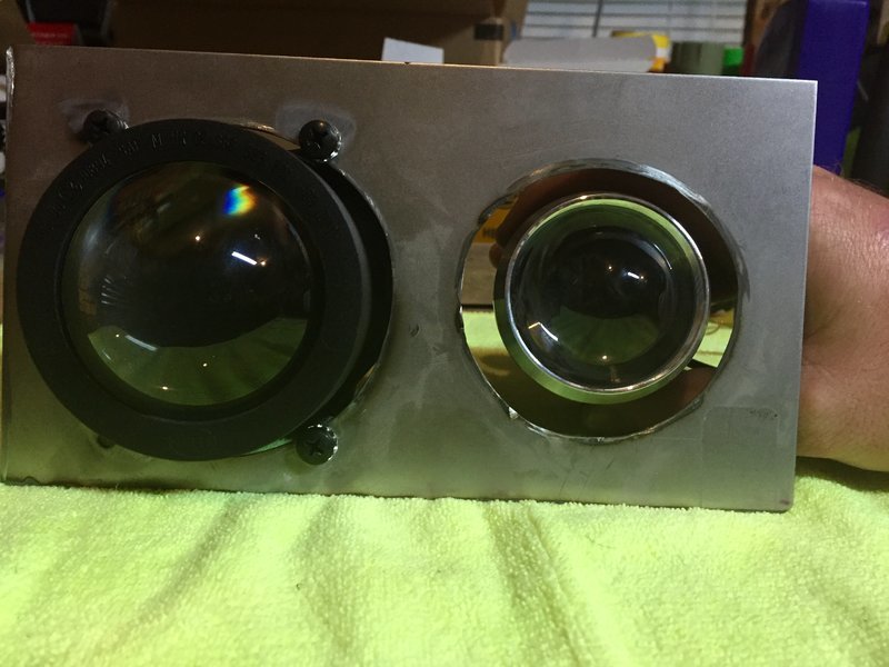

    This is pretty spot on to how far the projector will protrude past the face of the plate.

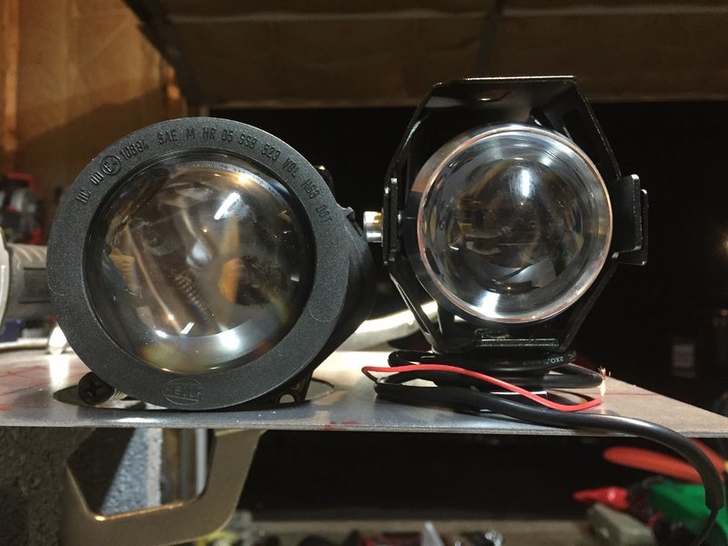

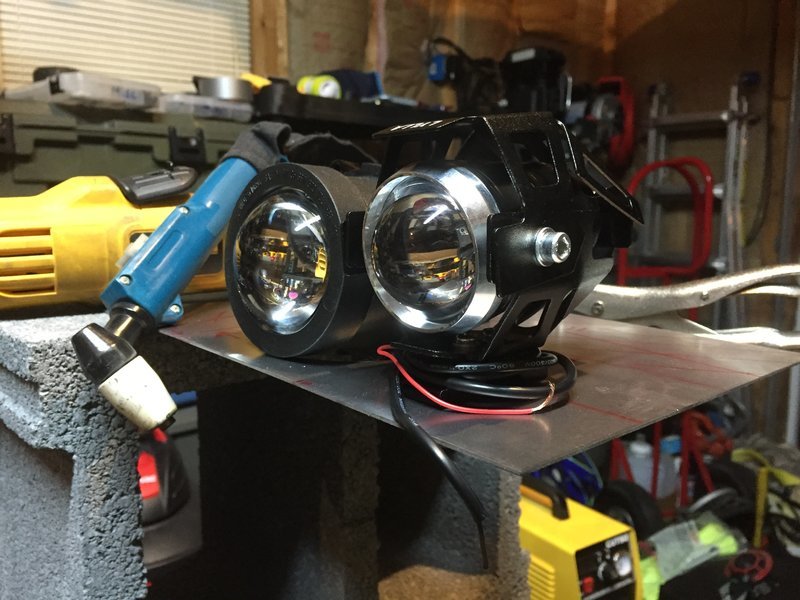

    I need to test the LED projector out tonight, to verify is truly bright enough. if it is, i'll likely take it out of the little steel cage it's in, and mount it in a similar fashion to the Hella.
    the hardest part of this project will be to get the geometry right, so that when you hit the headlight switch, the lights raise up to the right height and aim. more to come on that after I finish building the housings for the lights.

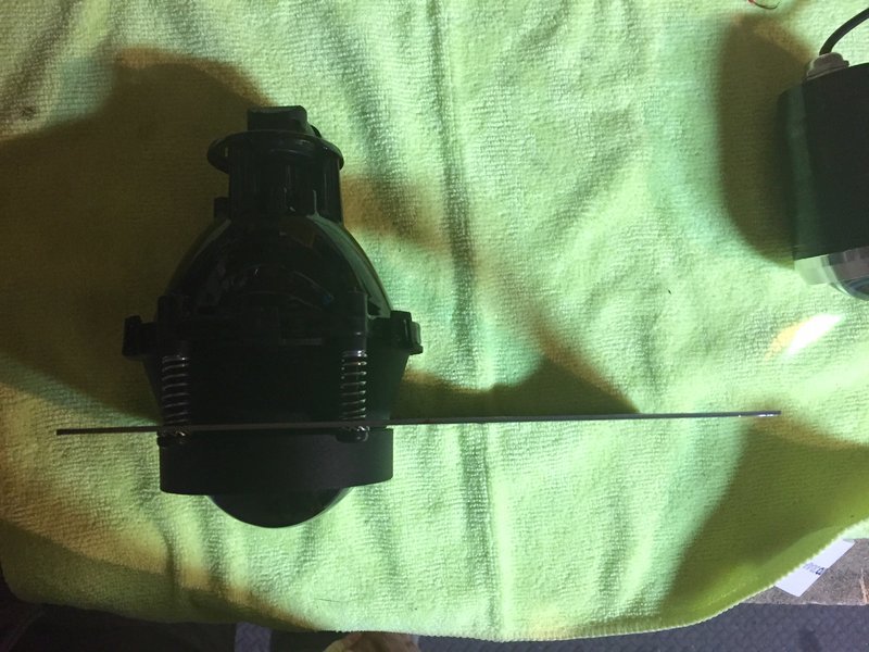

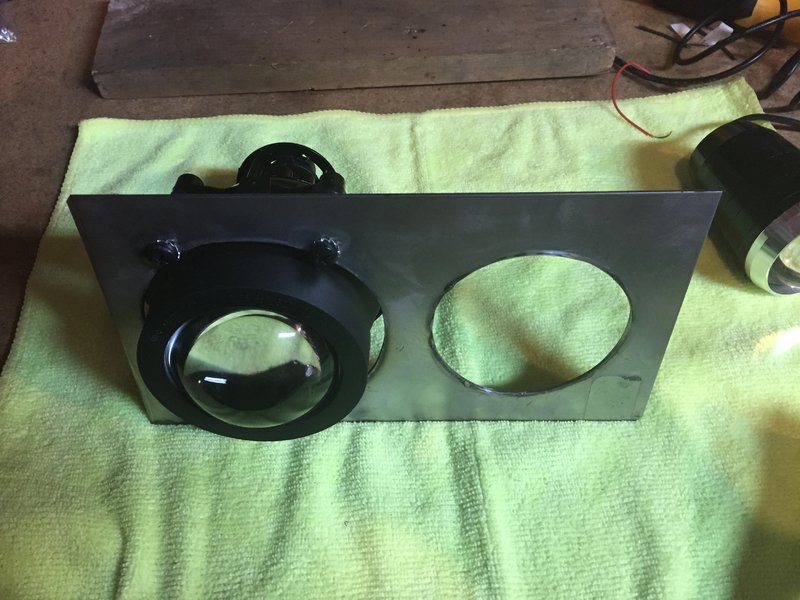

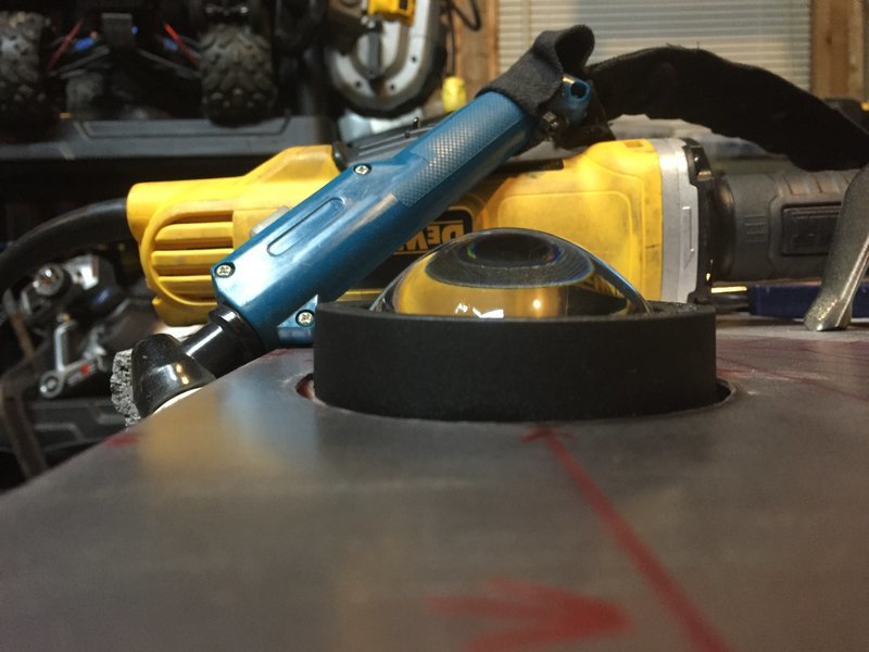

    Finished up the first face plate for one side.
    Hella low beam mounts up nicely with adjustable spring loaded bolts. High beam will have a tab welded on the back side for the aluminum housing to mount to.
    Tested out the LED projector high beams. They are a spot beam, and way brighter than I thought they would be. Should work quite well.
    Also, my redneck circle guide for the plasma cutter. Jose clamps, zip ties, and a nail. Secure the nail at the proper radius for your circle, and drill a hole in the center of the plat for the nail to go in.

    Compass plasma torch. Quite ingenious.
