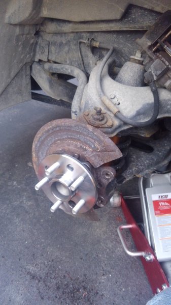

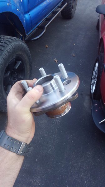

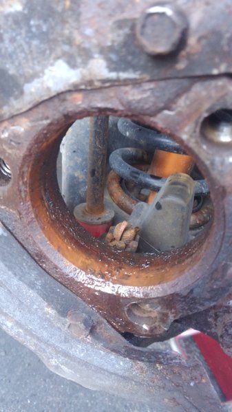

    Did a wheel bearing last week. The hub I pulled off seems to have a Pontiac part number on it, meaning it'll be worth keeping and rebuilding myself with some timken or better bearings. The one I I stalled is an aftermarket unit, but is professionally assembled by the guy who is known for having the best packaged bearing assemblies for these cars, so it should do the trick.
    The fact that this has a Pontiac part number on it, means that it could very well be an original bearing with close to 200k miles on it. Previous owner had a lot of service reciepts, and when bearing was not one of them.
    Anywho, an old bearing like that made for a difficult uninstall.

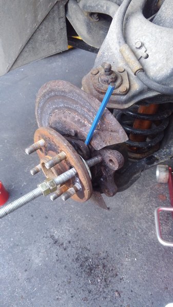

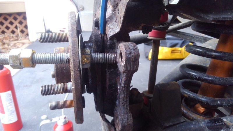

    Had to made my own press, since nothing I had was small enough, and the really want enough room to swing the 4lb sledge.
    Some all thread, 3 nuts, and a washer did the trick. Jam the two outer nuts so you can hold the all thread still, and then sure the inner but against the hub flange. The tip off the all thread will press against the spindle until the hub is out. If you get to the point that you can't turn the wrench anymore, slap the sides with the sledge to break it loose. Then start turning the wrench again. Repeat until the assembly falls out.

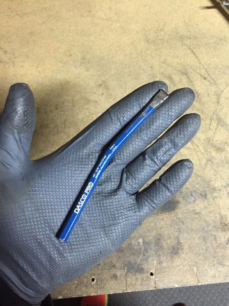

    I used a chisel as well to help persuade it.

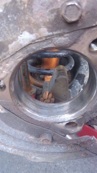

    After getting it out, you can see why it gave me so much trouble. The wetness is penetrant, not water, but still nice and rusted in.
    Cleaned up with a die grinder and fine grit flapper
    Anti seize on the new unit to make future swaps easier
    And done! It's a shame what salty roads and a gravel parking lot does to your vehicle. I never painted the dust shields, but the rest of the suspension was a nice shiny black when I started driving this a few months ago.

    My 2001 Subi was the same, when it came time to replace the rear bearings. Not only were they seized in the knuckles, but the axle shaft's splines were also rusted into the hub. Double fail. :frusty:
    Same as you, cleaned them up, and antiseized everything. I can always deal with that little mess, over that mechanical hassle. Yuck.

    When I pulled the motor and transmission out last year, I was legit worried that the axles were going to be stuck in the hubs, and that was going to be my big holdup. Licking they came right out, but it had me nervous.
    Side note, only one casualty while doing this bearing

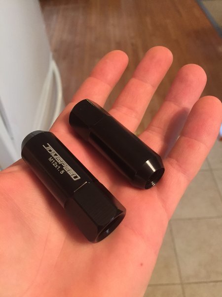

    New lug nuts. While I love the design of the ones I have, they just aren't right for my application. Current lug nuts are a steel body with an aluminum floating, conical washer. Unfortunately, the bore in the wheel for the lug nuts is so small, that when the nuts were torqued down, the aluminum washer squished a little, wedging itself in the wheel. So now when I remove the nuts, the washers are stuck in the wheel. Lucky me now gets to cut/grind each and every one of the washers out before the new, all aluminum nuts go on.

    changing gears, I finally got around to ordering a new trim piece with a new side marker/turn signal lens. factory piece has been faded and broken since I bought the car.
    Through the forums, I came across a company that specializes and reproduction "classic car decals". it's mostly muscle car badges and the like, but they have a great recreation of the old "Fiero Racing" logo. this logo was adapted from the "Pontiac Racing" logo, when fieros started to appear in more and more races (think TRD putting a Tacoma through Baja in the stock class kind of thing).
    Lastly, I used my lug nut debacle as an excuse to buy some more tools. thus, a nice selection on new die grinder bits.
    These things are magic. A little spendy, but they eat through hardened steel like butter. Radnor part numbers below in the same order as above.
