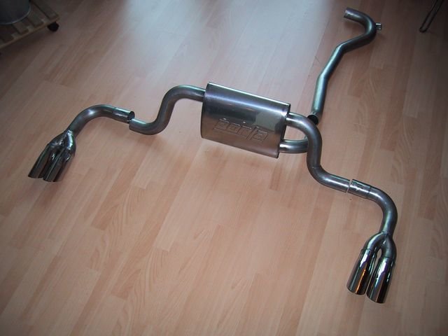

    made what I think is the last decent sized purchase for the fiero until paint time comes around. exhaust is in pretty darn good shape for a 1988 anything, but it does show some age. I normally preach to people that cat-backs are a waste of money, but that's because on tacomas, everything is straight runs of pipe, and you have 4 feet to play with if you're just swapping out a muffler.
    .....Fiero is a slightly different animal. except for about 6'', every bit of the fiero exhaust has a bend in it. sooooooooooooooo, catback it is. i really don't feel like spending the time to fabricate that intricate of an exhaust from scratch. though I will have to make up the pipe myself that will replace the cat itself.
    I went with with the Ocelot system. they build it using a Shuttleworth muffler (I've never heard of Shuttleworth, but they get very high marks on the fiero forums). Ocelot used to make them with borla mufflers, but has switched to shuttleworth currently. best picture I found was with the older Borla design. should arrive on my front porch next week :)
    the tip design is a little different on the new version as well.

    That is an interesting layout.

    tight quarters when you fit an entire engine and a trunk in the back of a car this small.

    What diameter is the exhaust tubing?

    2.25"

    That should flow well and keep the scavenging velocity high, on that little engine. :thumbsup:
