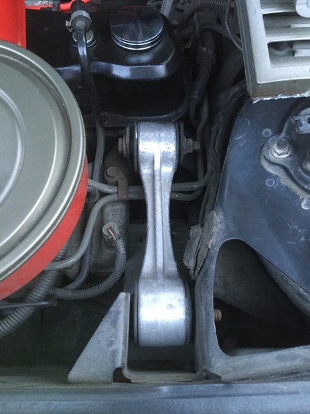

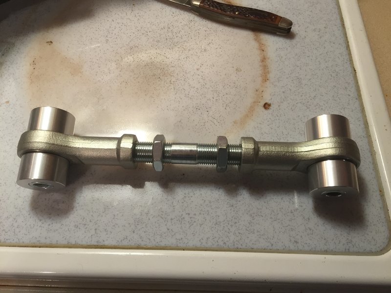

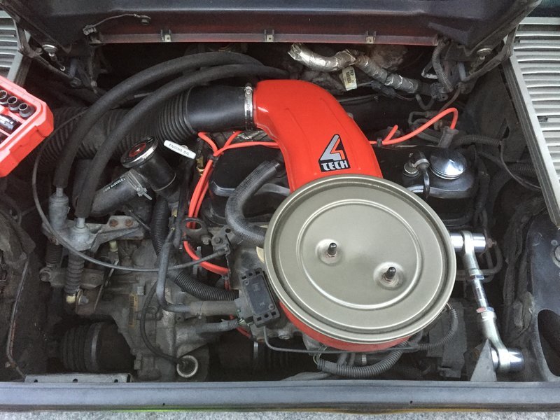

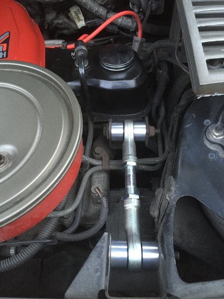

    Woot. Loving that new dog bone. Equivalent to me installing traction bars in the rear. Plant and go.
    Looks like I'll be grabbing some of those bits as well. :thumbsup:

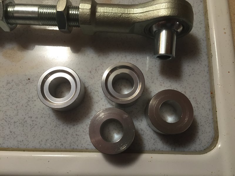

    With two right hand threads there isn't a chance of it loosening at least.
    Can't remember did you go through the rest of the bushings on the car? I bet that entire car could use replacements.
    I have a full set of replacement rubber bushings coming for my car (OE style). Unfortunately the company doesn't have a fiero set.

    good comparison. two different parts yielding the same result.
    you'll love the bits. just go slow at first, ask me how I know...... :bananadead:
    a number of the rubber components have been replaced, but I do need to do more.
    transmission and differential mounts were replaced when I had the motor out. the motor mount itself was in good shape though and appeared to have been replaced at some point. all of the bushings and rubber spring isolators were replaced when I redid the suspension. all that's left really are the bushings in the suspension arms. and the sway bar bushings. none of them are falling apart, but I would still like to replace all of them with polyurethane. prothane makes all of the necessary bushings. sells them In a kit for under $200 I think. it's like 20 different bushing sets :eek:

    29 years has probably deteriorated them a bit even if they do look ok. Guarantee the car will feel better once they get replaced as well.
