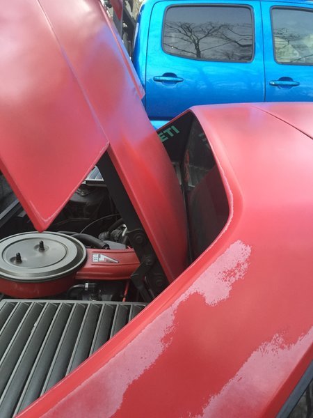

    hmm, come to think of it though.....the wrx scoop is 4'' tall. i'll have to mock it up to make sure I have 4'' of clearance in the correct spot when I open the decklid.

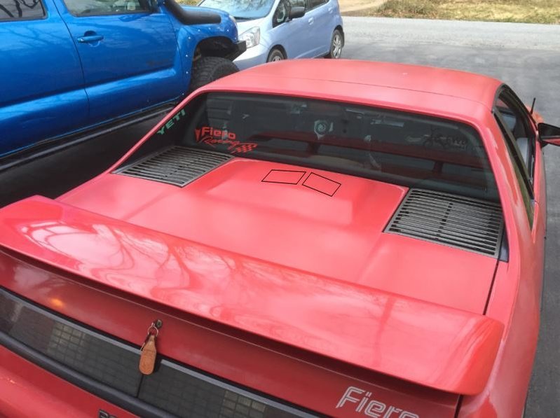

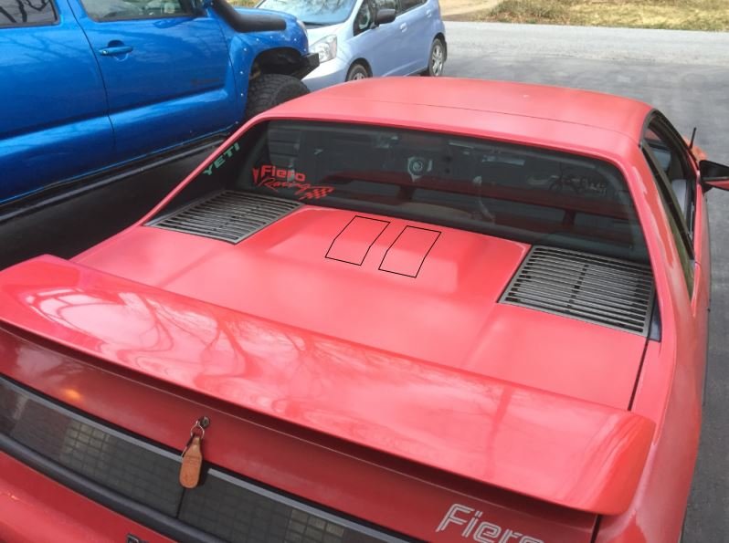

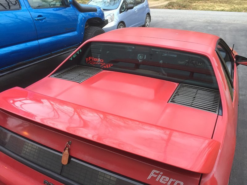

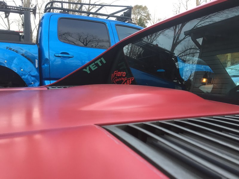

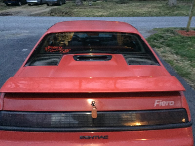

    So while I would like to go with a carbon scoop for the ease of installation, I may have to build my own louvers due to the clearance between the decklind and rear of the roof.
    here are some pictures of the hump that the scoop or vent will go on, and the clearance when the lid is opened.

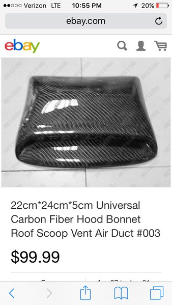

    As much as I like the shape of the WRX scoop, it may be too tall and interfere with the roof. while it doesn't look as nice, I did find this one. it's about a 10''x10'' square, so not quite as wide as I'd like, but wide enough.

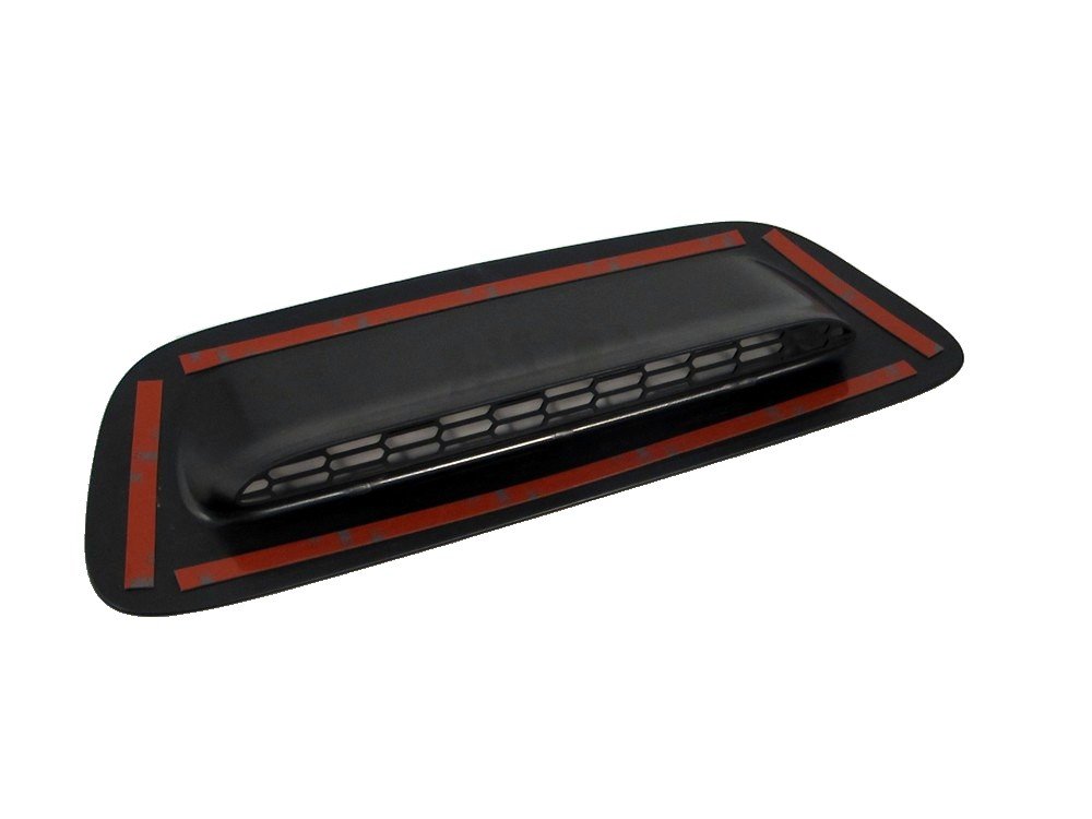

    Aight! last one for a little bit.....

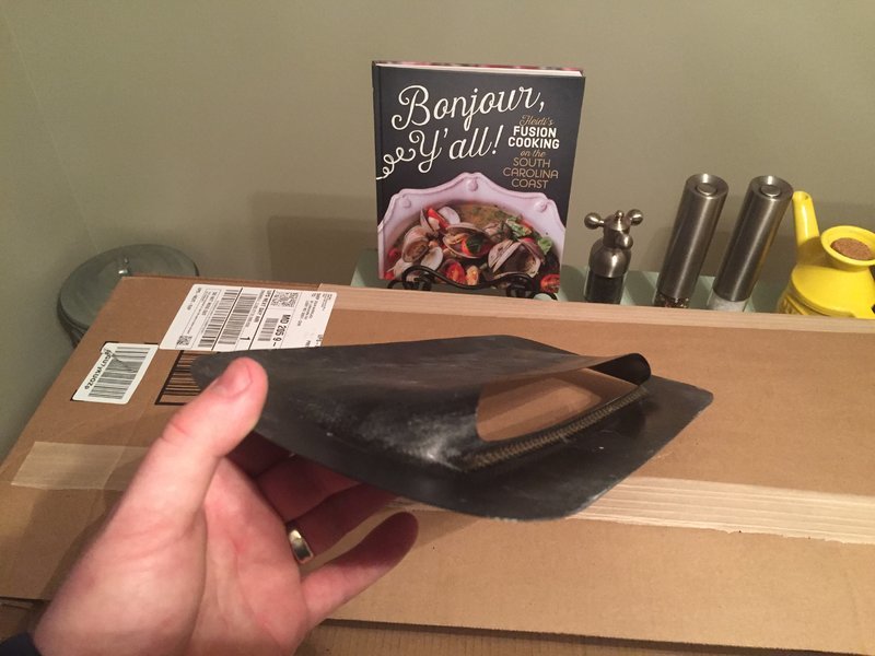

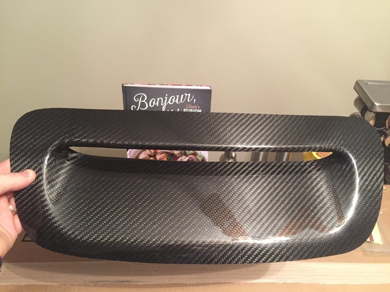

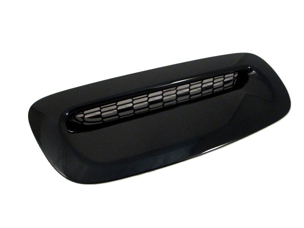

    it looks like a mini cooper scoop mat be an option. there are a number of companies that make carbon fiber ones, but an ABS plastic one for sale was the only place I could find a picture of the underside. this aftermarket plastic replacement has a perfectly flat bottom. it would lead me to believe that the carbon ones are no different. when installed in the mini, it's angled up on the hood, creating a scoop. on my application, it would lay flat, and be a recessed vent.
    factory plastic replacement
    flat underside
    carbon option (because I like the bling)

    found a picture of the bottom of the carbon one. grind off the epoxied clips and it's good to go. this one could work
    Nickel likes this.

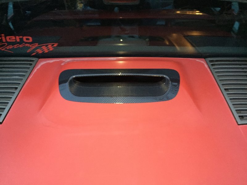

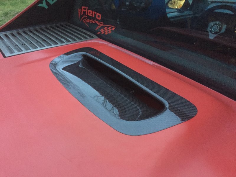

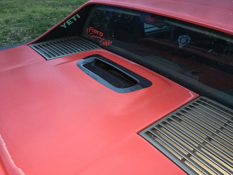

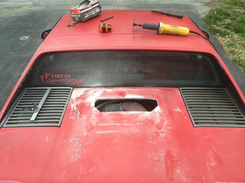

    Vent installed, and the scoops shipped out from the Neatherlands today!

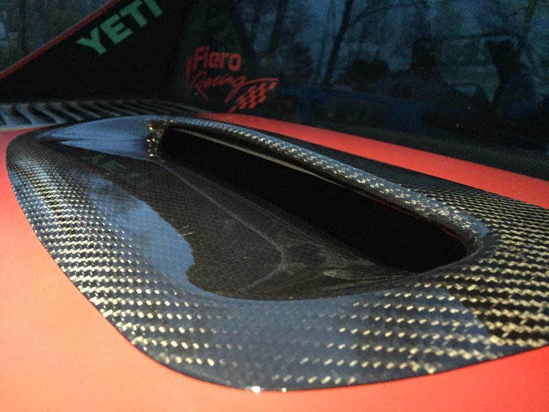

    the Mini Cooper hood scoop worked out great. the carbon work is done very well. the scoop is less than half a pound.
    took some measurements to center it up and figure out the hole size and position needed. then went to town with the die grinder. after cutting into the Tacoma so many times, it was alarming how easy it was to make a permanent hole in this thing.
    Selfie for safety! cutting the fiberglass decklid reminded me of my days working as a yacht tech years ago. only this time, I remembered to sinch down my sleeves and button up my shirt to keep from getting all kinds of itchy

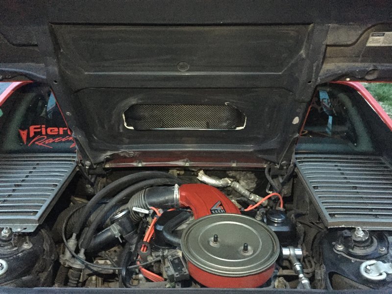

    and in it goes. nice and flush. currently held in place with 3M VBH. will bolt it down if I run into issues with the 3M
    Underside
    MadDaddy, Martyinco, FIRE74 and 2 others like this.

    Dude! That looks terrific!
    Is that the 3M tape with the red backing on it? If so, it is some strong stuff.

    That's the stuff. it's like $50 a roll :bananadead: same stuff they use on gopro mounts

    The fact that the vent is tapered the opposite direction of the deck lid hump bothers my ocd, haha.

    Its CDO! put the letters in alphabetical order damnit!
