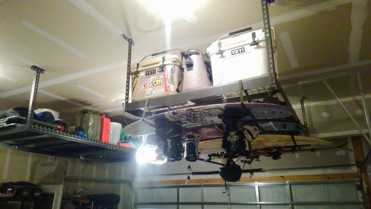

    overhauled the garage with some ceiling storage

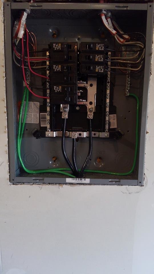

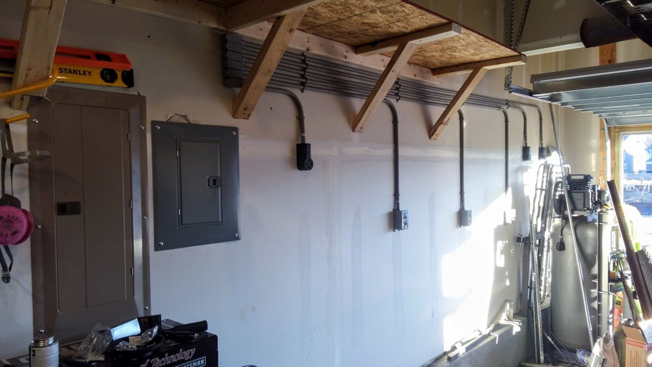

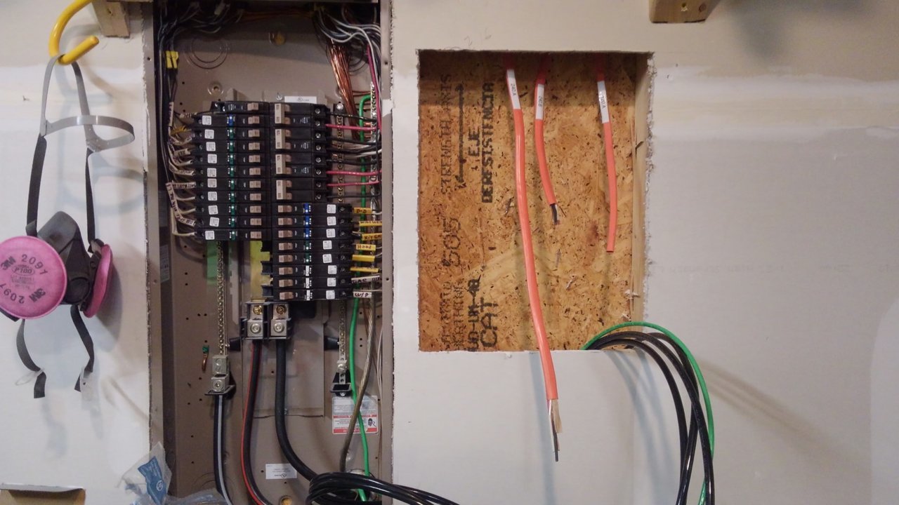

    Added a sub-panel to provide 3 high amp 120 volt circuits, and 3 240 volt circuits. it was quite the process
    original panel with the cutout for the new one
    26756266_10155314503036947_4889993500175_208bd9319167b033e5d1402f0c32be0c144af91a.jpg
    wiring in the new sub panel. box is rated for 125 amps, but I've only got 90 amp service currently run to it. supply cables are rated for the full amperage if I ever need more.
    26238762_10155314503566947_7173811032137_2c56d36e66821daecaf74311bd34b068a8bb8735.jpg
    all 6 circuits

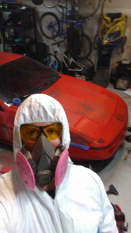

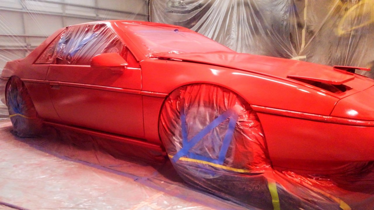

    Decided it was time to paint the car.
    sanding stage
    28685912_10155460603141947_4623710479452_4ea3006ad4e650c5d39f627d7bba5a5d2e1ffc85.jpg

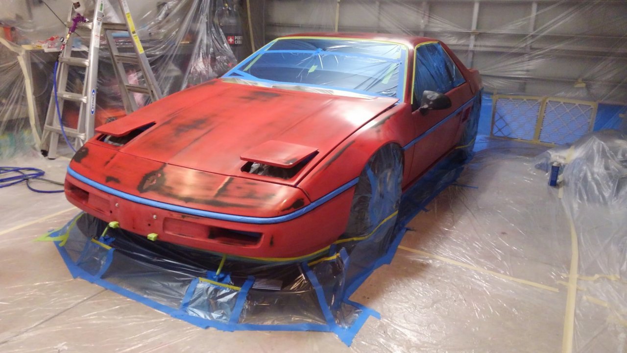

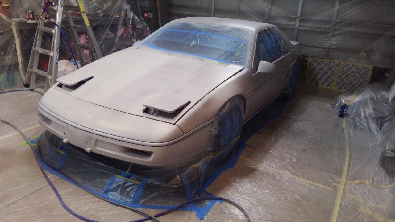

    sanding complete, masked off, garage sealed in. had two fans behind the car, pulling air out of the garage. the two air filters on the right, kept the air being pulled in from contaminating the paint with dust.
    29133295_10155468673816947_4504649849953_8e4b2306e554db93bcd12db4750569cfc3e7e913.jpg

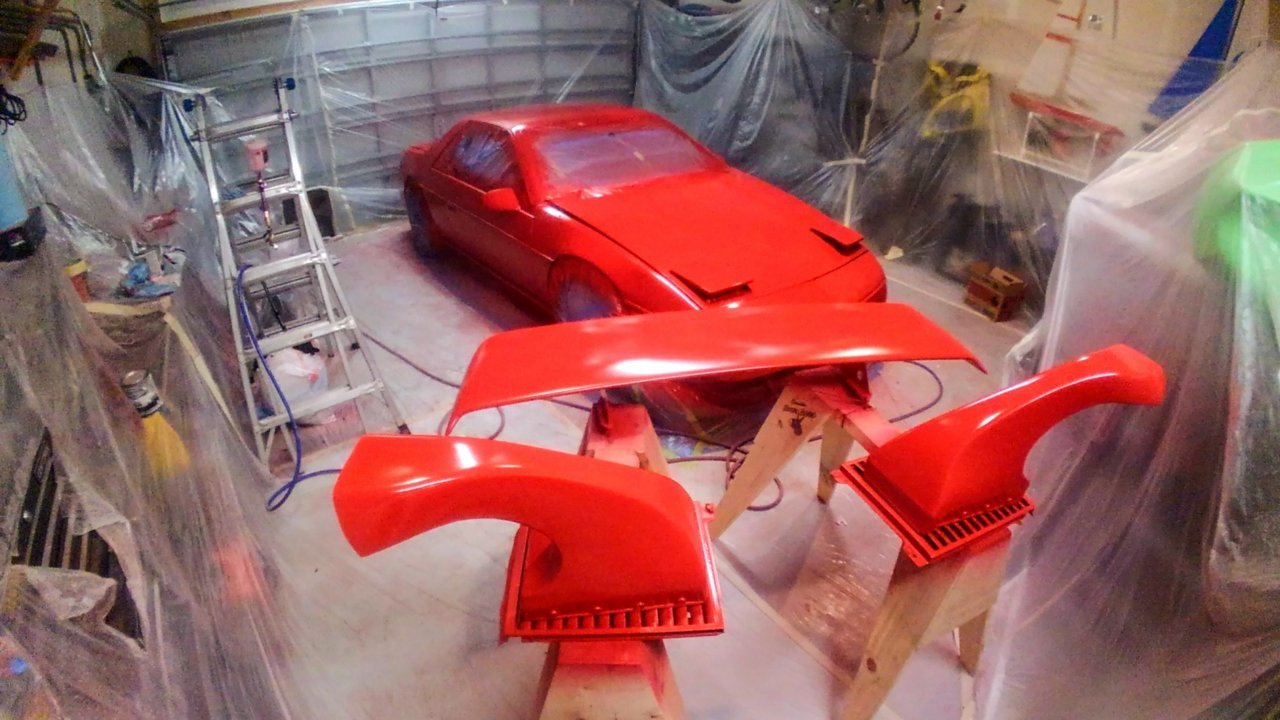

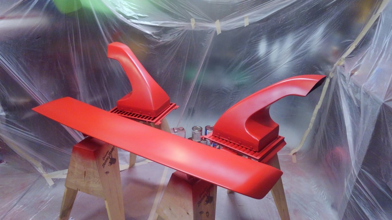

    2 coats of primer, 2 coats of paint, 3 coats of clear

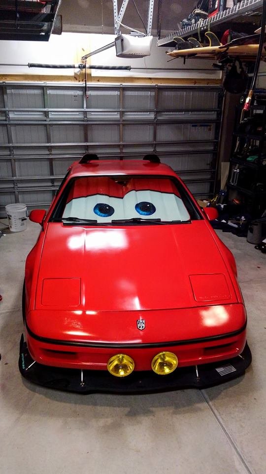

    Done

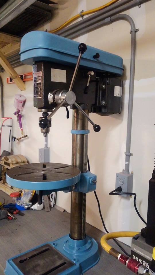

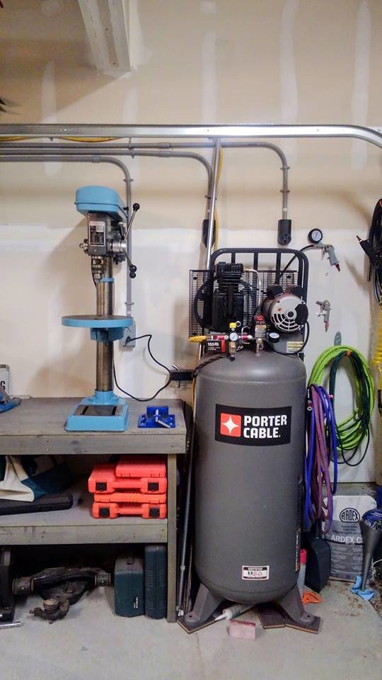

    restored a 50 year old drill press

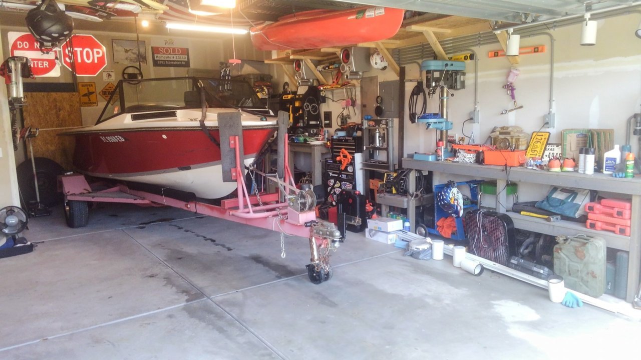

    fits nicely in the garage

    I admire that layout of your garage. Shop worthy!
