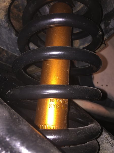

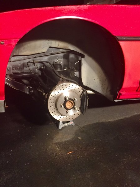

    Got one side of the front suspension/brakes done and started on the other.
    Stock springs next to the new ones.
    Brakes, spring, and shock fully installed

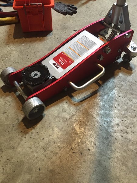

    And then I quickly realized that I have a severe case of first world problems. The big bad truck jack doesn't fit under the car. Had to go buy one of those low profile aluminum ones

    Need to get a hockey puck for your jack, bro.

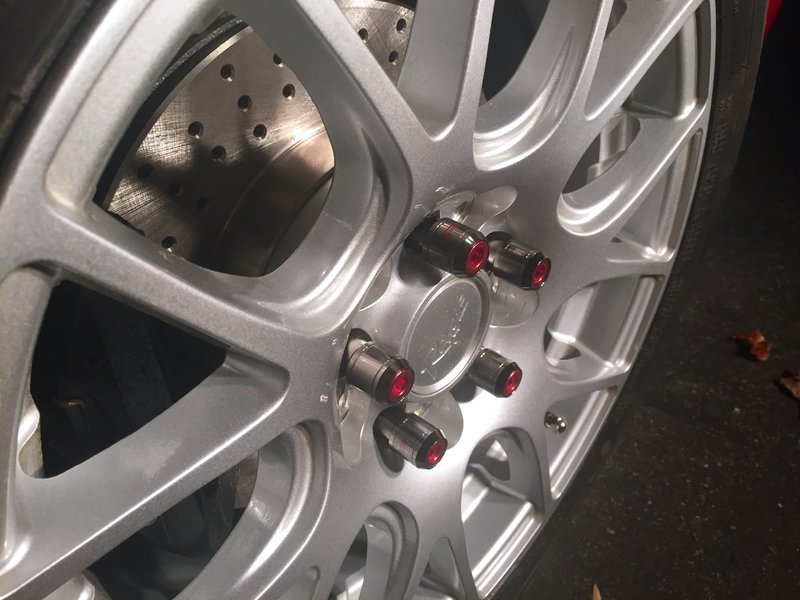

    got the car back on the ground last night, with everything fully installed front and rear. the picture is frech off of the jack, so the suspension may settle a hair lower in the front after I move the car.
    good news, everything fits.
    lugs protrude to flush with the outermost part of the spoke, so I only kind of look like a douche bag.......
    the lowering kit yields a nice, relatively even stance. front and rear fender gaps are nearly identical.
    ground clearance is about 5 inches to the bottom of the pinch weld. the "frame rail" portion of the unibody sits a hair lower at a couple points, but everything vulnerable is tucked up and protected quite well.
    for some perspective, I have size 9 feet, and my work boot does not fit under the car......
    guess I'm gonna have to get used to taking speed bumps diagonally.
